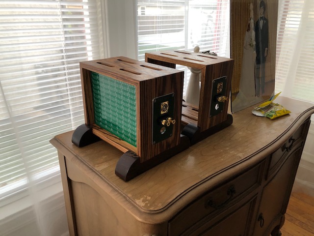

Beast photographs
Zen Mod was not sure if he could share these pictures of the new build, but they are not secret. I built the cabinets, Nelson is stuffing the boards. Just one of the 4 boards is shown in the cabinets, and it is not stuffed. But you get the idea.
