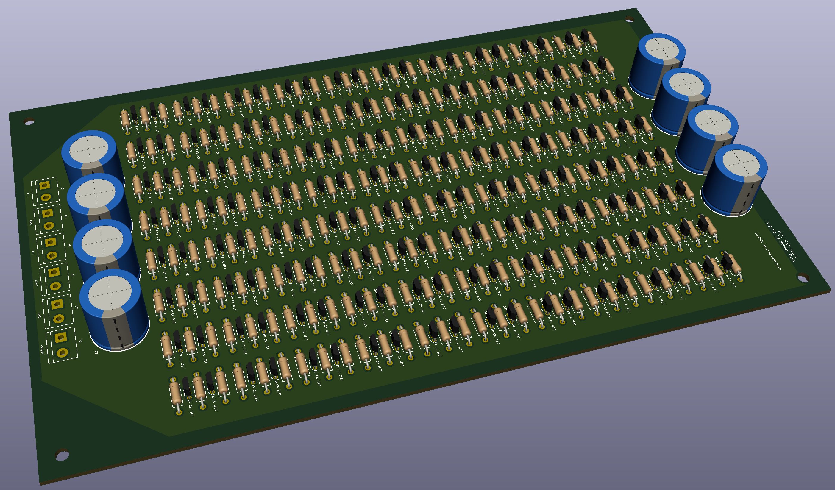

Third iteration of massive complementary buffer. 80 buffer pairs for headphone usage and flea power speakers.
6-layer board allows no hand routing between buffers. I only had to route one buffer and clone the rest. The cloning plugin also can arrange a matrix of identical circuits.
All of the circuit nodes have their own copper layer.

Yes to all of that. The SMT version will be a massive B1 instead of a complementary buffer as in the original Beast with a thousand JFETs by Mr. Pass. I cannot find any complements that have reasonably low Rds_on. All of the P JFETs in SMT that I can find have Rds_on 4X greater than the 2SK2145 N JFET by Toshiba.

I have the first 4 layer boards in hand. Checking the cross-talk before installing any Rs or Qs.

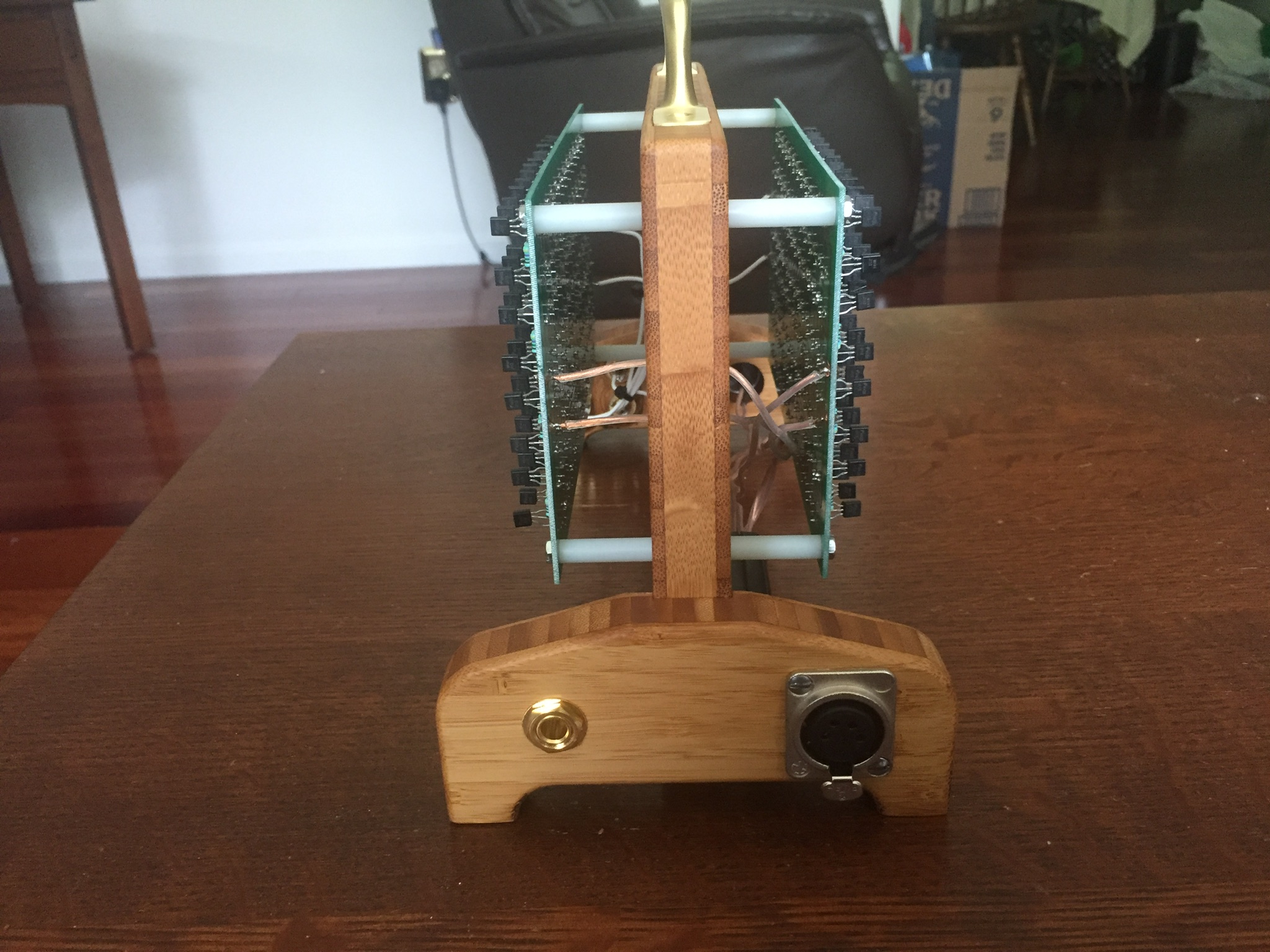

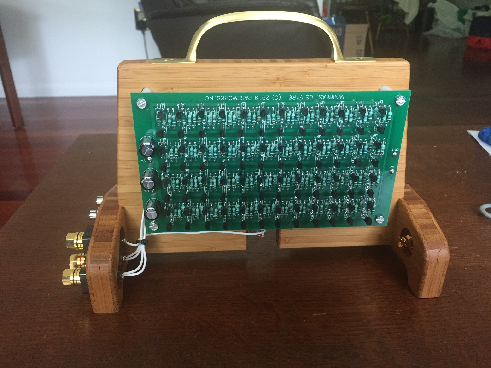

As noted, Nelson is exploring different “beast” topologies. The picture below is one of his micro-beast topologies: 48 parallel cells, each cell consisting of a J113 jfet follower with a J113 jfet CCS. The poor design is purely my fault.
The micro-beast makes a wonder headphone amplifier. The 32 ohm output impedance drives my Final Audio D8000 headphones and even my Abyss 1266 TC. The micro-beast sounds as good in one minute as is one hour.
As expected, the single-ended topology yields a 2nd harmonic output. I’m running it with +- 12 vdc. Since it is a follower, voltage is not critical as long there is a volts of headroom. Each side draws 1.6 amps.i
Sweet. Nice to see a close up of the master's design.
