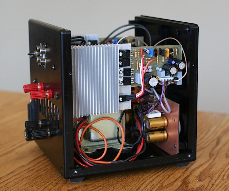

I plugged my P61N+/- into my main system the other day. It has been in a cupboard running my kitchen speakers for quite a few years. I think I originally built it about 18 years ago 😱
I call it a P61N+/- because it started life as a P61, then got Nirvana'd, then got some N+ mods, but I didn't like all of them, hence the "-". It also been the mule for a couple of mods that Hugh asked me to evaluate - which were not successful.
Anyway, the point is that this is a VERY fine sounding amp!
Oh, and by the way, I know the secret 😉
