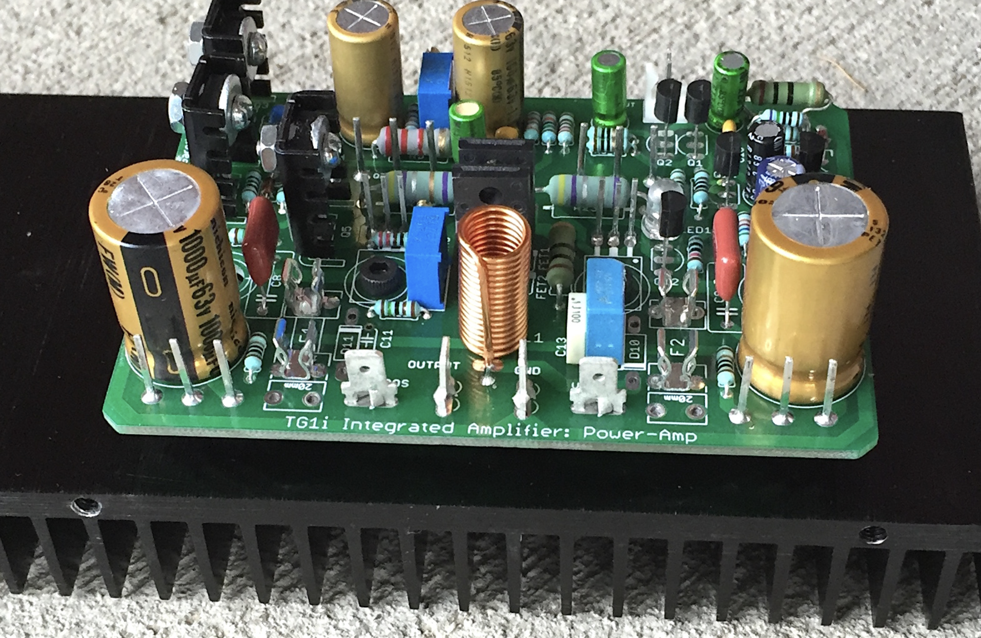

Yes, that's what I was suggesting. Only I would not use 100R for the emitter degeneration - I think it's too high and although it nicely smooths out the gain curve of the LTP it robs it of too much gain when used with a simple single transistor voltage amplifier following it. I think in my build I used 10R max but I may have experimented with 4R7 too. Just enough to buy you a little tolerance on the LTP behaviour but still retaining good gain.
I don't want to hijack your post but I would refer you to the schematic I posted here: https://www.diyaudio.com/community/threads/tgm-amplifier.140461/page-18#post-3259963
The value of the capacitor in question is best chosen by ear because it's so instructive to hear the differences and get a feel for the design. Anyhow, with the transistor I used and the layout I used I found that a value around 47pF would be a good starting point. I found that 15pF was too small (sound was not quite right, a little bright or something) and 100pF is too big (sound loses it's magic whatever that means).
In your schematic, I would advise using high quality electrolytic (e.g. Nichicon MUSE or whatever they call their hi end audio range these days) for C4 and C13. The capacitor that filters the power to the LTP (C13) can be interesting to try different values. The bootstrap cap, C4, can be increased to 220uF if a high quality cap is on-hand as it supports lower frequencies better.
The input cap, C6, is usually a high quality film type and needs good space for the higher quality ones. However, many years later I discovered that I got great sound from using a Nichicon Bi-Polar (audio grade) capacitor of around 10uF but this does change the time constant at the input.

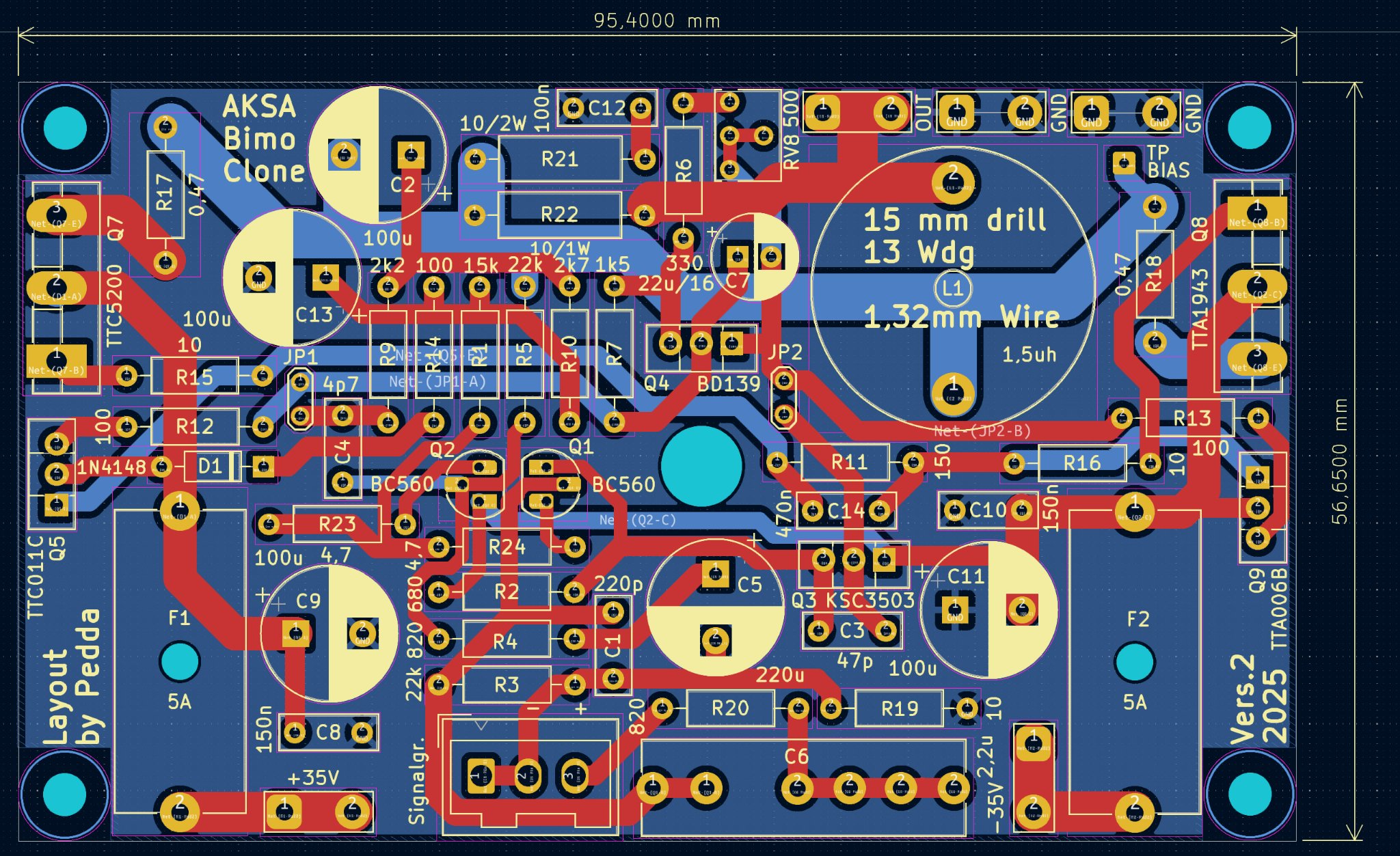

now the AKSA has two emitter resistors. That was no nice work because I dont wanted to change the size of the pcb. Moved a few componets and now it is finished.
@Bigun thanks for your advices.
I think nobody had tried to make a layout from the BIMO schematic until yet...
For the little pf capacitors i always use glimmer CY22-2. For nf i use wima capacitors RM5. Electrolyt muses are very good and i use if i can get with the right diameter.
In the AKSA amp R23/R24 R12/13 R15/R16 the resistors should be 0,1 % or measuring out for identical value....
I uploaded new gerber files with emitter resistors.
It was only a favor to make this pcb, dont know if i ever built one. I have too much own projects..

i can try anything, but there is not much space on this board. Tell me what you want and i try...MrHifitunes asked for a small board under 100 and 60 mm.
If the pcb size does not matter i can change the height if necessary. With a small board its possible to save money....

I am willing to help and to learn....i can use a schematic to make a layout for a pcb, but i cant design an amp by my self. If i ever will learn enough to do, dont know...
I learned a lot in this 1 year i am active here in this forum, but i have only a little knowledge in electronic. So, please be patient with me....
I recognize the knowledge that is present here, sometimes I am overwhelmed...😉
The AKSA amp is very interesting, but i don't understand everything in detail. I hope MrHifitunes will built the amp with my pcb and report how it sounds.

To switch from "side" transistors to "in one line" transistors is not difficult. I think for heat release the transistors on the pcb side is the better choice...
