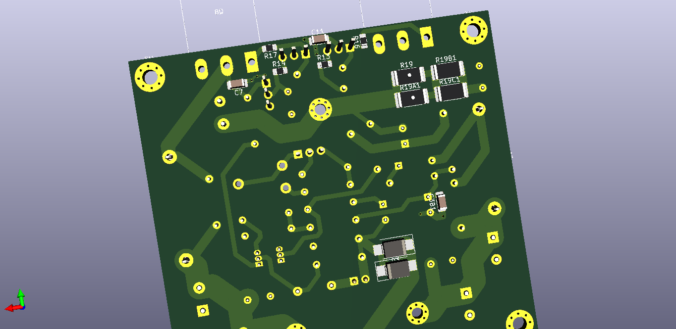

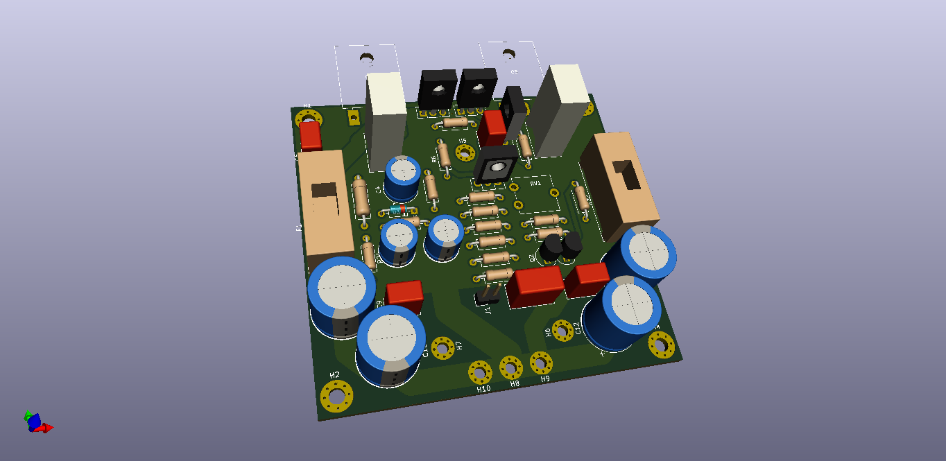

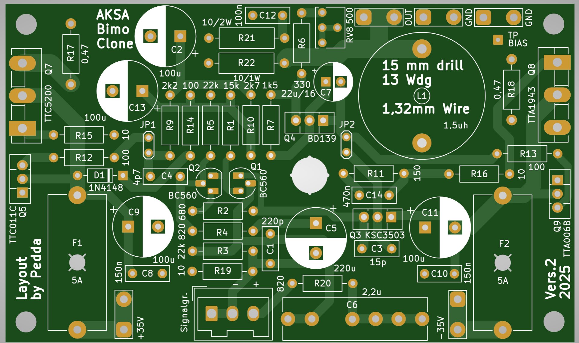

Made a layout for this little amp a while ago.
Still couldn´t fire it up due to other projects.
First layout after ages it seems so a few questionable choices like a mix of THT- and some SMD-parts.
First order at JLCPCB and I naively ordered a lot of 10 and will only need 4 max.
If anybody´s interested, I can let go of 6 PCBs for the cost of shipping.

Hi...

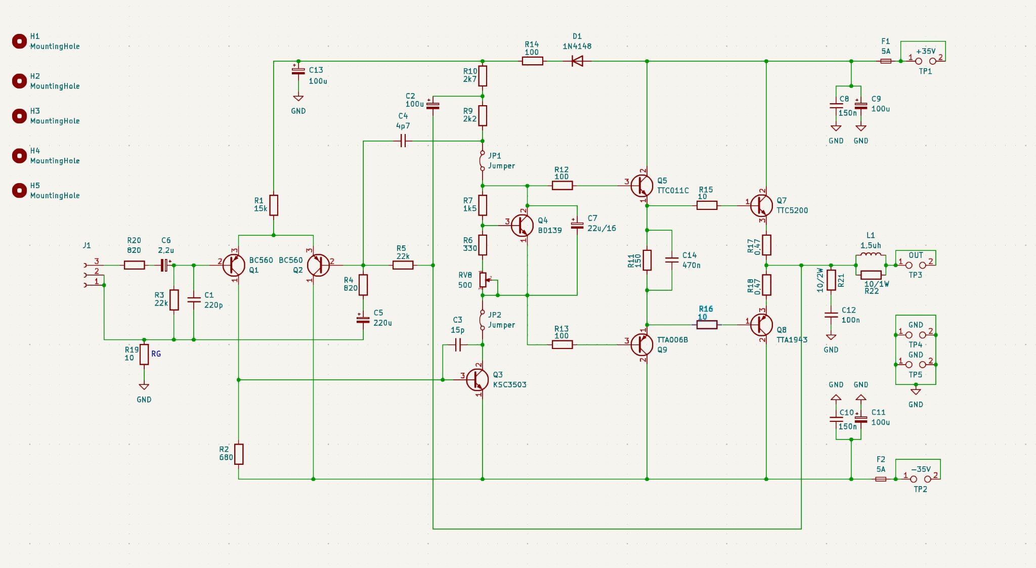

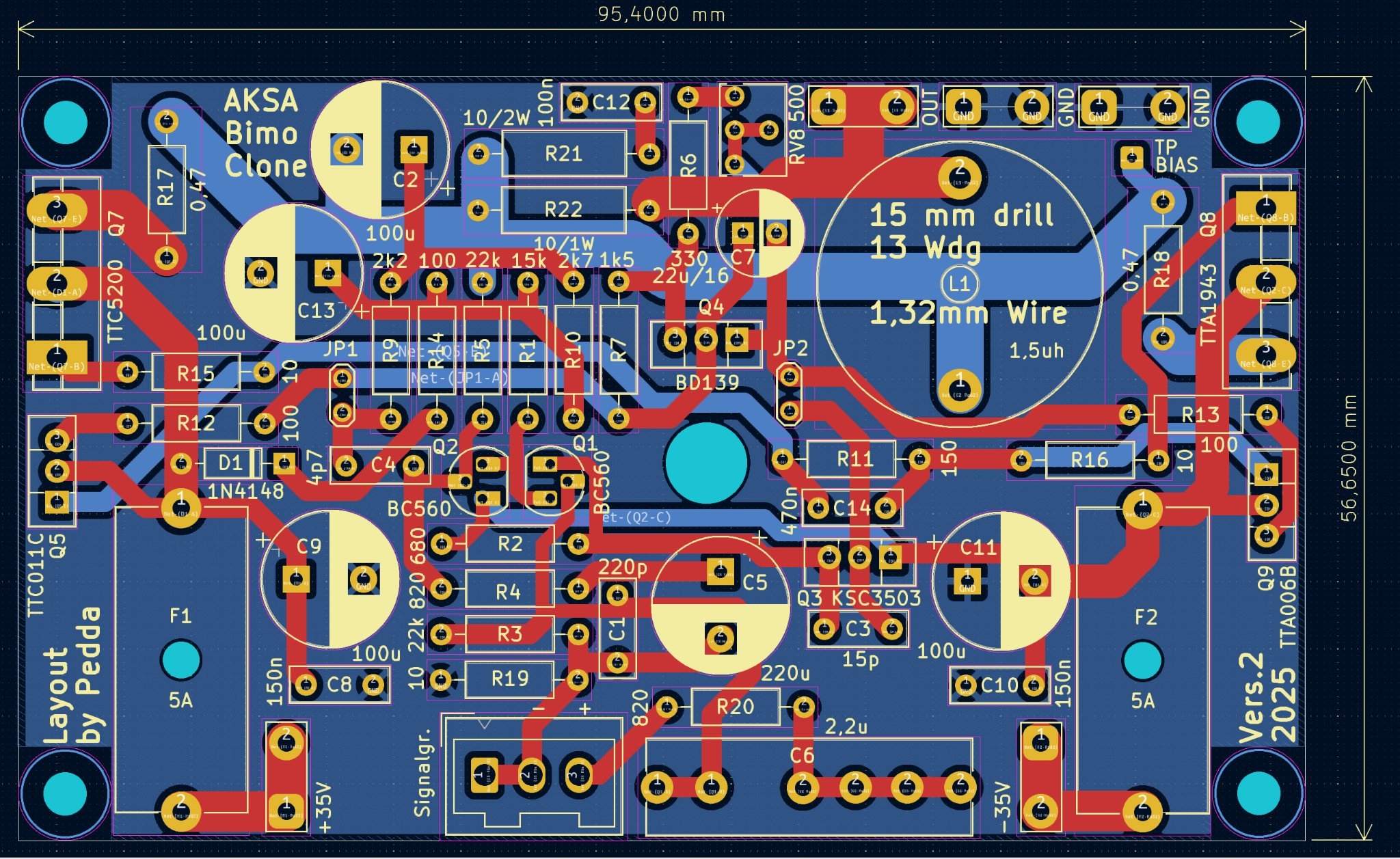

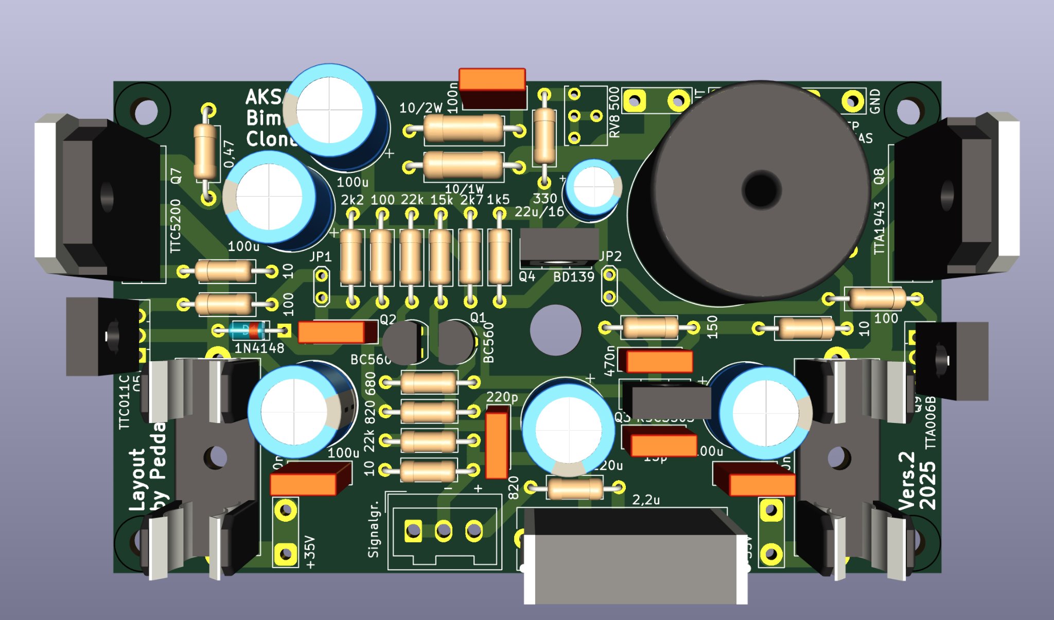

MrHifiTunes had friendly ask me to make a layout for this amp and i did. The next question was if i can share the gerber files. Of course i can share....
As schematic i used the Bimo schematic.
Perhaps someone has an idea to make something better....ideas welcome.
If no other ideas, i think it is finished. I can't give any guarantee. I have to test the pcb by my self but i have too many other projects...
Have a look to the pcb, schematic and so on...
Version 2 because it is existing a similar pcb with other TO220 drivers as in the Bimo schematic.
Greetings
Peter

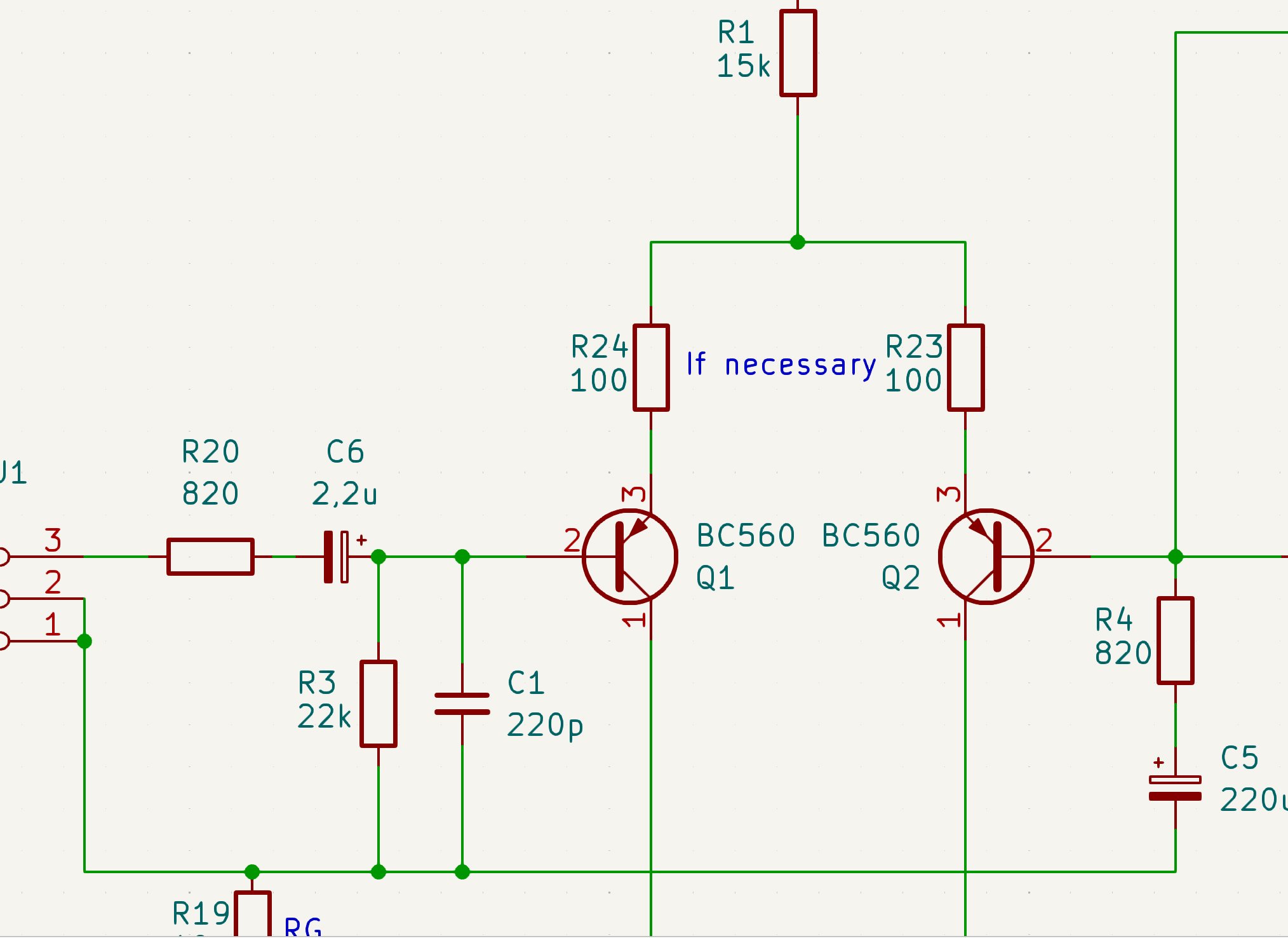

I would've recommended providing footprints for LTP emitter degeneration resistors (Hugh was not adverse to them if low valued). and C3 looks a little under-valued at 15pF. Great amp!
- Based on Hugh Dean's AKSA 55
