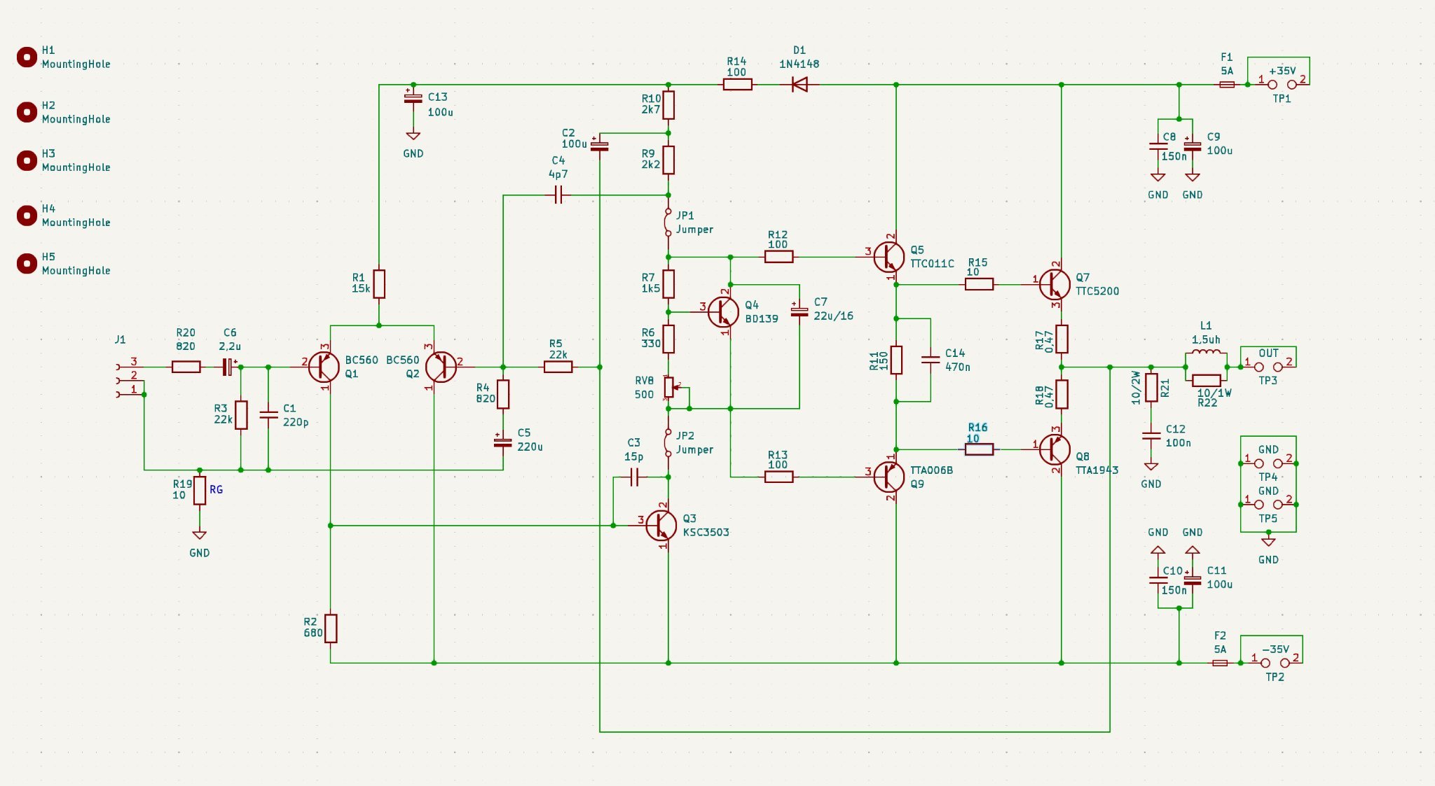

The value of the capacitor in question is best chosen by ear because it's so instructive to hear the differences and get a feel for the design. Anyhow, with the transistor I used and the layout I used I found that a value around 47pF would be a good starting point. I found that 15pF was too small (sound was not quite right, a little bright or something) and 100pF is too big (sound loses it's magic whatever that means).
In your schematic, I would advise using high quality electrolytic (e.g. Nichicon MUSE or whatever they call their hi end audio range these days) for C4 and C13. The capacitor that filters the power to the LTP (C13) can be interesting to try different values. The bootstrap cap, C4, can be increased to 220uF if a high quality cap is on-hand as it supports lower frequencies better.
The input cap, C6, is usually a high quality film type and needs good space for the higher quality ones. However, many years later I discovered that I got great sound from using a Nichicon Bi-Polar (audio grade) capacitor of around 10uF but this does change the time constant at the input.
It's a great amp to DIY.
You get the values of the caps from this schematic? C4 is 4p7 increasing to 220uF seems a lot. what values you suggest for C13? what will be the impact soundwise?
for C6 I have a WIMA or KEMET PP.

normally a current of 1mA each transitor is good so i guess 2mA total(for both)
R2 is only in 1 leg and 680 ohm. Nothing compared with the 15k.
With the 15k each transistor gets 4.5mA/2 {in the ballpark of your suggested 2mA}
whats the purpose of the 680 ohm anyway? Doesnt it bring the transistors out of balance? Is it for compensating the difference between the 2 tranisistors? introducing harmonic distortion?
Just trying to learn as it is all new to me.

ah, I was confused there, C4 was the designation of the Bootstrap cap on Hugh's original schematic - in your schematic I think the bootstrap cap is C2. C2 can be 220uF.
For C13 I suggest you try different values and listen to see what you like. I think a value around 47pF is a good starting point. This capacitor is a local feedback loop around the VAS transistor. Not only does it stabilize the overall amplifier feedback loop but it will impact the sound. The transistor has intrinsic capacitance too between collector and base and the external capacitor adds to it. Both can have an impact on the sound. For example, the NAIM amplifiers of old used a transistor with excessively high intrinsic capacitance which was a key part of the voicing of that amplifier. Intrinsic capacitance in a bipolar transistor is very different from the near-perfect dielectric of an external film capacitor.
The thing about C13, the supply rail cap to the front end, is that all the signal current variations flowing through the LTP are decoupled by that cap. A lower value cap will affect the sound. There are some subtle things going on in that front end that are rarely talked about. I'll mention another one of them - an LTP is also a Mixer, you can read up on Gilbert Cells. The non-ideal behaviour of a simple resistor-tail LTP means some generation of harmonics, and especially 2nd harmonic, which is used here in AKSA as part of the 'voicing' of the amplifier.
the resistor R2 680R is for voltage trop of the VAS transistor Q3. this value sets the DC offset of the complete amplifer. in my JAT EZ amp i have to simulated the exact value to have as low as possible Dc offset. at the real amp i have to change the resistors value too.
also the degeneration resistor Re at Q3 help to hold the VBe multiplier "symetrical" for the same bias current of the next stage.
R9+R10 +C2 are bootstrapped to the VAS signal of the amlifier -that is the reason this cap should be 220µF and a good quality cap. Hugh and rabbitz wrote at the AKSA 55 thread and Bigun in hs TGM amps.

different designation. The caps C13 and C2 have 10mm diameter. A cap 220uf 50 volts or 63 volts will fit at this places. A 100 uf 50 volts only needs 8 mm.
I had made the footprint a little bit larger. All 100 uf footprints and the 220 uf feedback cap footprint have 10 mm diameter. C9/C11 could have 220 uf instead of only 100 uf.

also R17 R18 degeneration at the output transistors are very "konservativ" with 0,47R.
maybe 0,33R is fine.
at my AA14 - class A - the TTC5200 have 0,22R and they are fine.
so you have alittle bit more "grunt" (current) at 4R impedance.
I have some 0R25 somewhere. I can try them if 0R47 isn't satisfying me.
