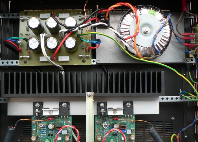

Sorry about the 2 year delay in replying as I don't usually go to the SS forum.
The mongrel AKSA 55N+ was built using amp PCBs supplied by Hugh and used components of my choice as well as a few value changes (some supplied by Hugh). It used Nichicon Muse KZ for the bootstrap (C4??) and Nichicon Fine Gold, Nichicon Muse BP elsewhere. The power supply used a single 300VA 25-0-25 transformer instead of the dual mono supply of the 55N+. This used a C-type supply similar to that used on the purchased ESP P101 details as it differs from the one at ESP. This used 6 Nichicon Gold Tune caps plus MKT by-pass caps.
I don't have the amp any more or a pic but it's similar in layout to the BAKSA I built.

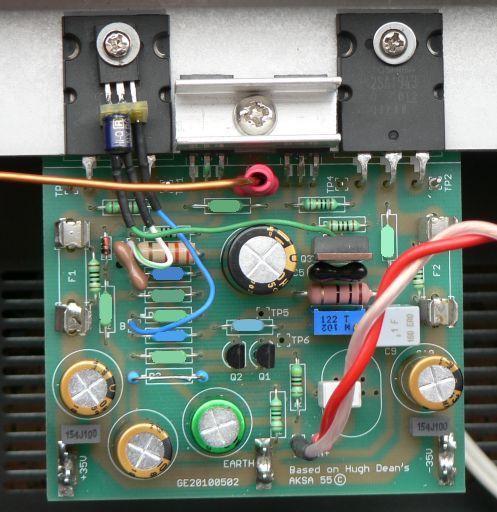

Eric, just remember that the artwork (based on Greg layout) was made for TO-126 drivers, as BD139/140.
TO-220 drivers, as MJE15030/15031, need to be reversed. See attached photos.
Although I'm satisfied with BDs, nothing wrong with testing others.

Thanks Farjon, Greg had already warned me about this.
Just passed an order for some MJF15030/31 and some MJL4302AG/MJL4281A even though I have plenty of NOS 2SC5200/2SA1943. Based on a few opinion from this site it seems that the newer MJL from ON Semi sound better (whatever that means..YMMV)

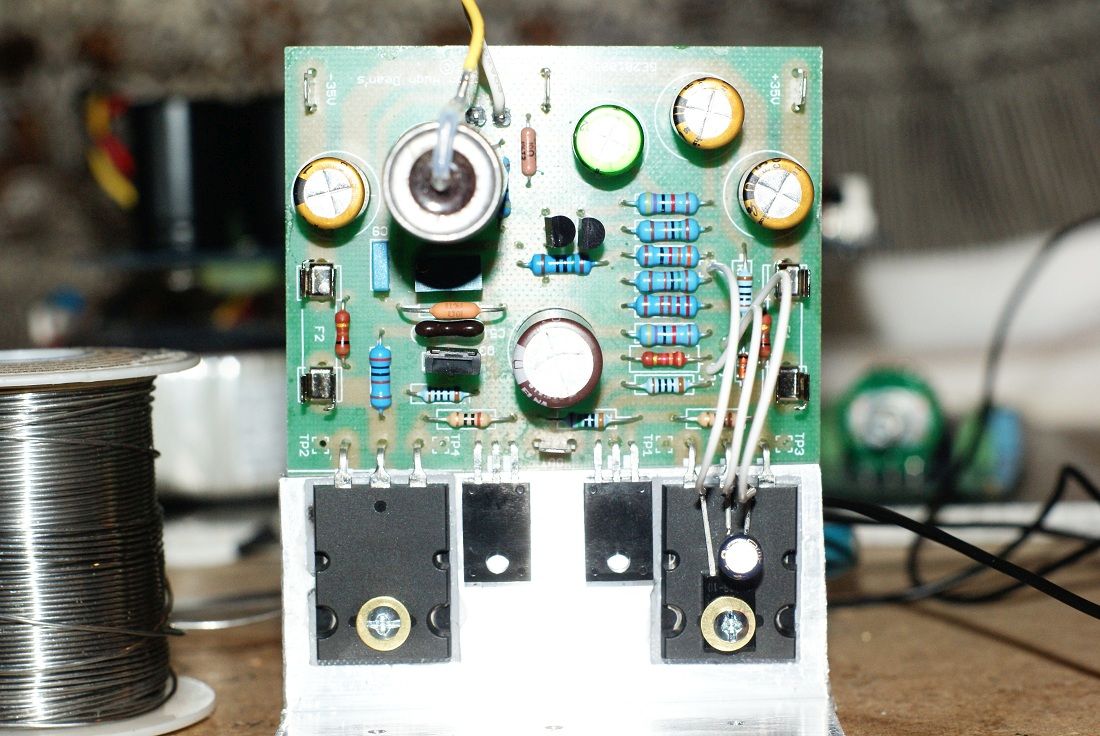

What is the small cap on the BD139 that sits on 2SC5200 ?

Eric,
That is a 22uF Black Gate across the BD139 Vbe multiplier.
It smooths the voltage variations across the bias generator, ensuring the output quiescent current is constant at audio levels and helps to turn off and on in the output devices. The drivers all stay on through the full signal waveform. I found that a really good cap in this role enhanced the sound quality. The Black Gates are very, very difficult to buy now; I had quite a few back them........
Hugh

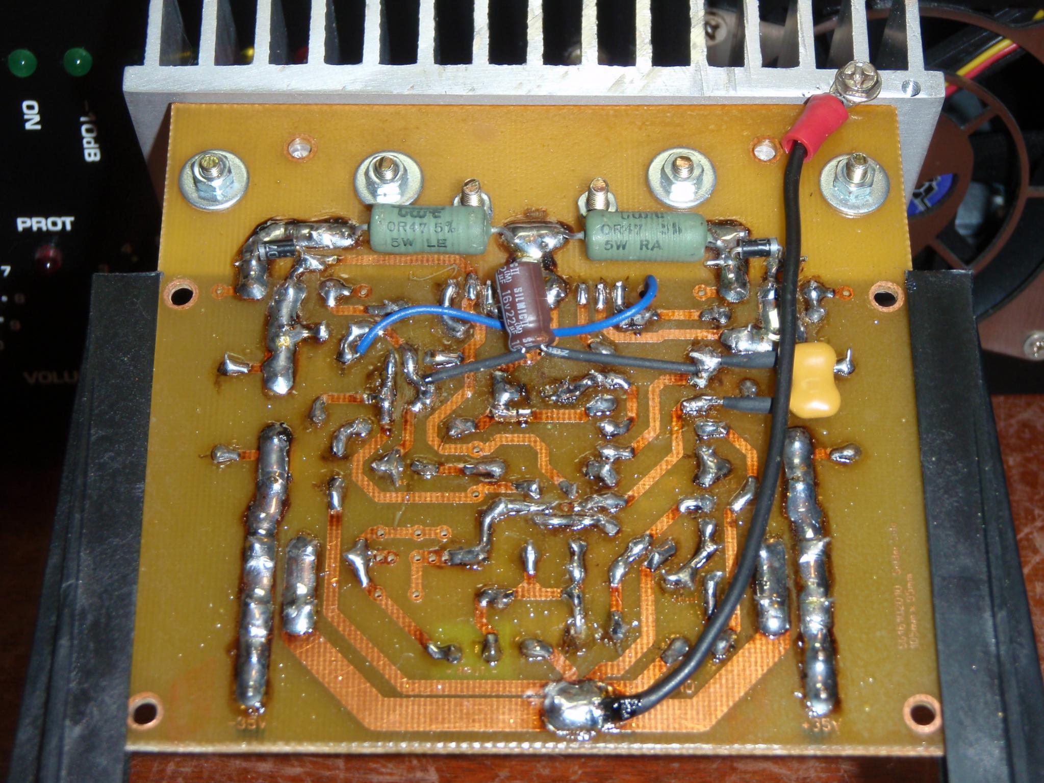

Instead of BlackGate you can use Nichicon MUSE/Gold or Elna Silmic (silk).
Elna Silmic under board.
Rgds.

These boards came with pre-applied varnish. A mess after same time... Consider these as prototypes.
It would be easy to clean before applying extra components under board. 🙁
I have another pair. Thinking about another build.
