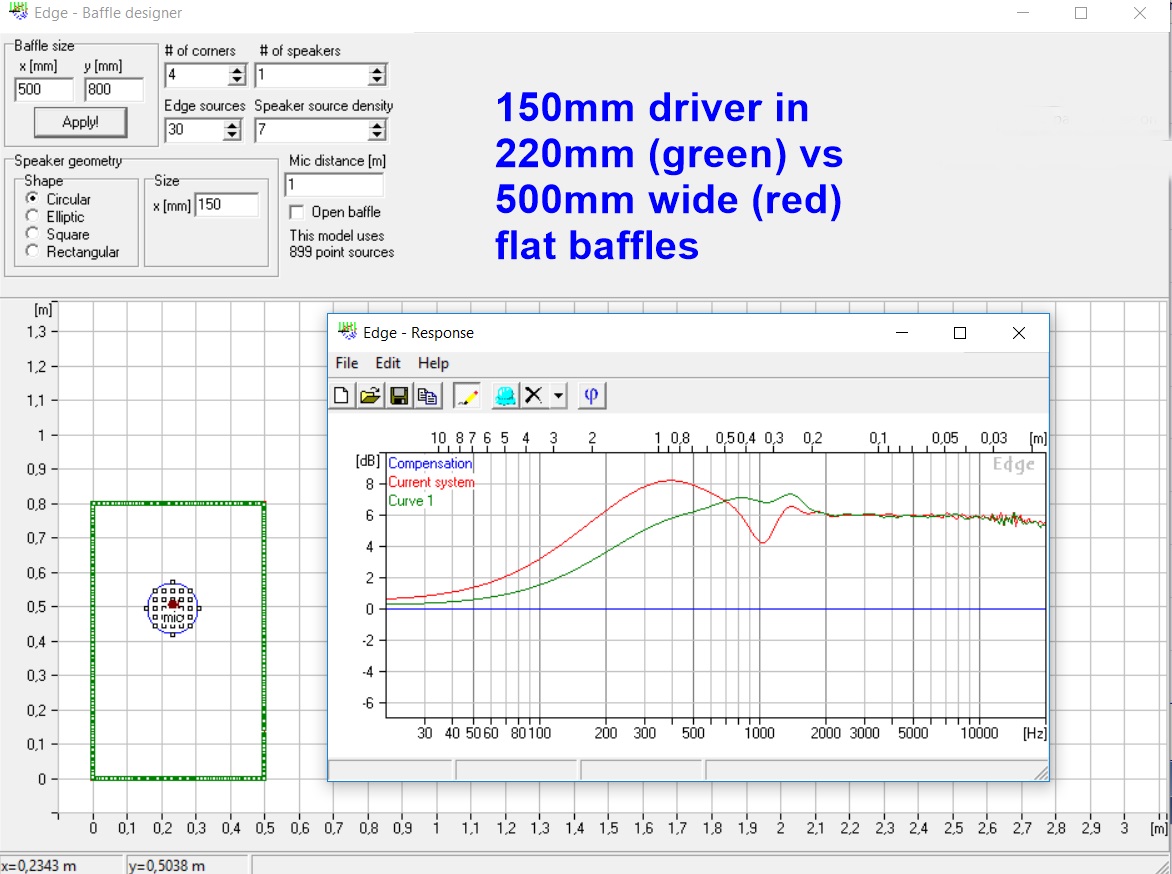

Baffle width has other effects besides step. Edge diffractions are more benign in narrow baffles.
Based on what ?
As already mentioned by someone else, with a wide baffle by the time the wave travelling along the front baffle reaches the edge it will have travelled further and been attenuated more than on a narrow baffle.
Also it lowers the frequency of the first peak/dip, which is always the worst one - a narrow baffle puts that first peak/dip within the frequency range of the tweeter, with a wide baffle it can be below the operating range of the tweeter!
Don't place too much faith in simulations performed by The Edge. They really aren't very accurate at all and I have given up on using it a long time ago because it always predicts far worse perturbations of the frequency response than actual measurements show! (It doesn't seem to take driver directivity and reduced baffle illumination caused by it into account for example so beyond the first peak/dip real results are much smoother than predicted)
^Some notes. Yes Edge is just a quick and dirty little simmer, but:
- I was focusing at what happens in midrange, including baffle step and baffle's first edge null.
-At this F range a 150mm driver radiates evenly, it starts narrowing above 3kHz
- The Edge models driver directivity based on flat disc model. The user can set number of driver surface and edge points, accuracy.
