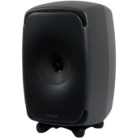

I'm not saying it's the right thing for the woofer, but perhaps using a concentric horn that occludes the woofer is a possible improvement over slots/holes in a waveguide surface in a traditional unity/synergy type system.
Something like the example from Genelec John posted here? Link to original post.
It is a 3-way speaker... but pretty good control off axis. Design is in line with this thread, to reduce diffraction.

Have you noticed what KEF R series have nowdays?
Shadow Flare
The Shadow Flare is an innovative way to cut harmful high frequency cabinet diffraction. It's a carefully profiled transition that extends the waveguide effect of Uni-Q. The treble escapes naturally because the ‘shadow region’ stops it getting to the cabinet edges. The result is vastly improved fine detail.
Basically it does exactly what a waveguide does except its a "shadow flare" and costs more.
