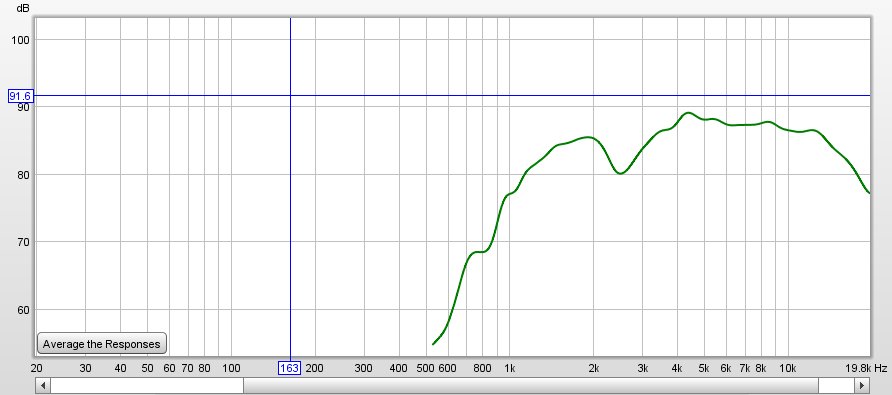

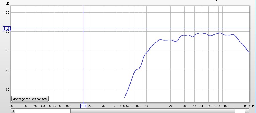

I recently built my first speakers using some Acoustic Research cabinets that I'd got from ebay - I can't build boxes and this was my first attempt so wanted to make things a bit easier to start with, and I thought my experience might be of some use.
They didn't have tweeters with them and the woofer foam was shot, so cheap and ideal for this project. The baffle did have some felt on it that surrounded where the tweeter had been. I removed it intact. I then fitted the PHT409 tweeter (small compression driver with waveguide) and measured it. I got this:
attachment.php
I then attached the felt to the tweeter, and even though it wasn't the right shape or a good fit, I got this:
attachment.php
I then tried using some acoustic foam I had which I cut down to the same height and added it as strips above, below and to the sides of the tweeter. I did measure them as individual items to see what worked best and to see if there was a minimum amount that would work rather than the whole lot, but I don't think I saved the results. The acoustic foam worked much the same as the felt, so I bought a sheet of adhesive backed 15mm acoustic foam so I could cut it to the exact shape I needed. As the speakers would be behind a large grill it didn't matter what they looked like as they wouldn't be seen.
I just thought sharing this might be useful.
