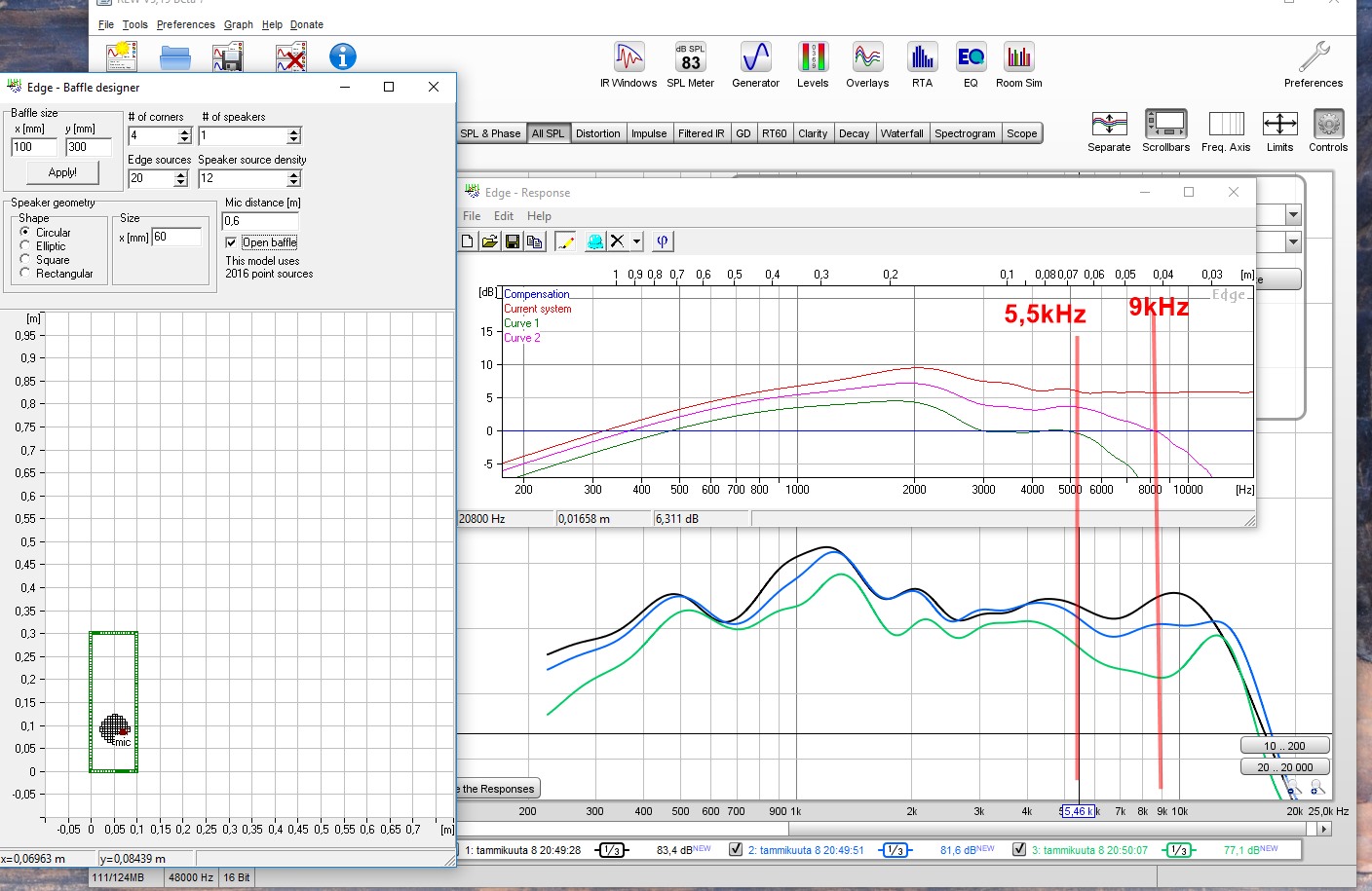

I made a quick and dirty test with a cone in open baffle off-axis vs. The Edge. Besides the ripples in unequalized response, directivity change off-axis looks pretty much the same!
What is the point of this? Some kind of response to my message?
