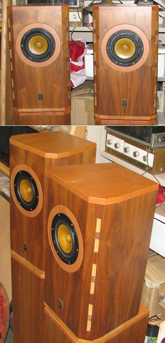

...full-range speakers… add large roundovers to the long sides of the baffle and call it a day.
That works. These have a polygonal approximation of a teardrop in the plan view and at higher frequencies there is enuff beaming that the wavefront does not travel along the baffle.

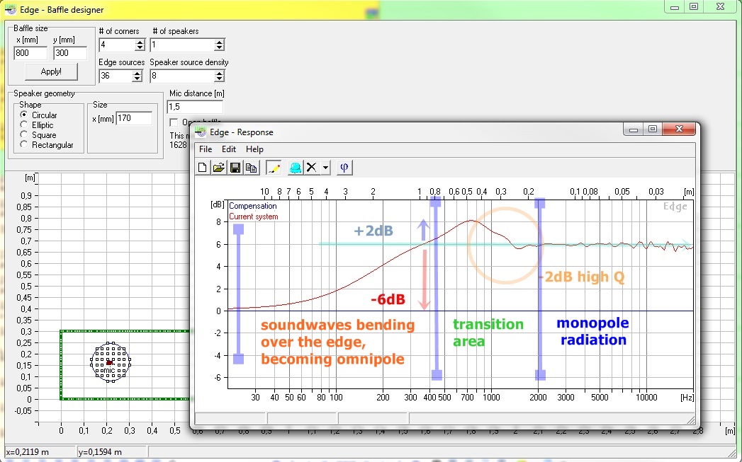

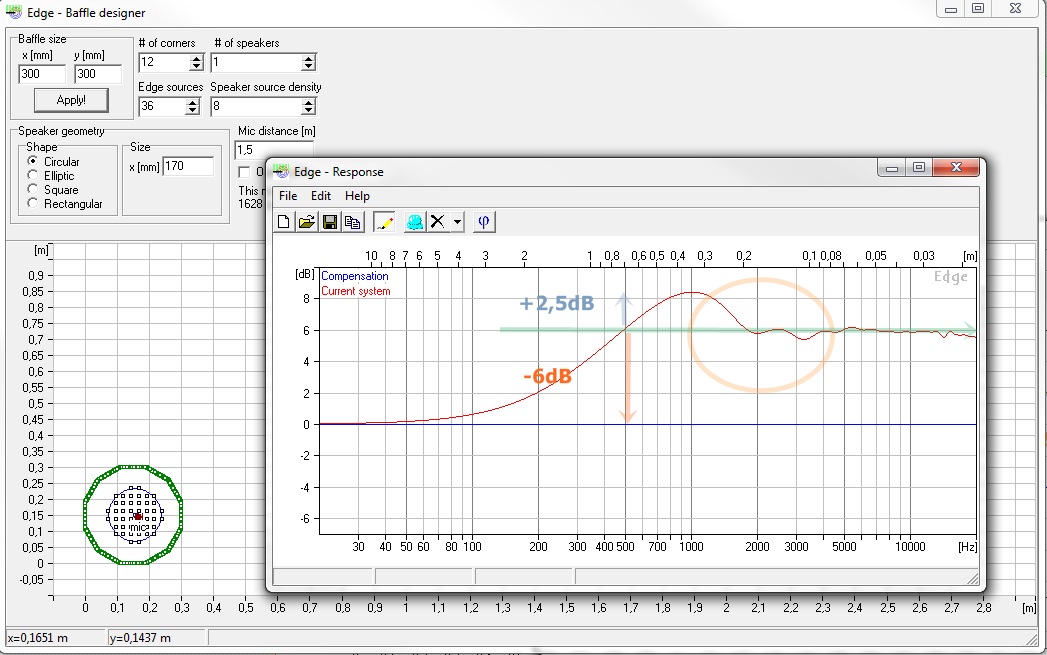

Baffle diffraction is not just that -6dB, there is also some boosting with high Q notch and ripples above it (orange circle). The height and width of the bump depends on baffle/driver relations. A rectangular box shape distributes well, a round or square is more difficult! That's why B&W Nautilus etc. balloon cabinets are not a real solution to the whole phenomenom, it helps only in the highest octave!
It is also the wider distribution of sound with higher power used for the same response. The extra power has the potential to reflect and interfere.
I added some text to show how radition pattern is changing in relation to frequency.
The transition area is the most challenging to eq and very often we must set xo there too. Sometimes it helps, sometimes not!
These don't contain polars, but with these dimensions driver diameter start making beaming above 2kHz.

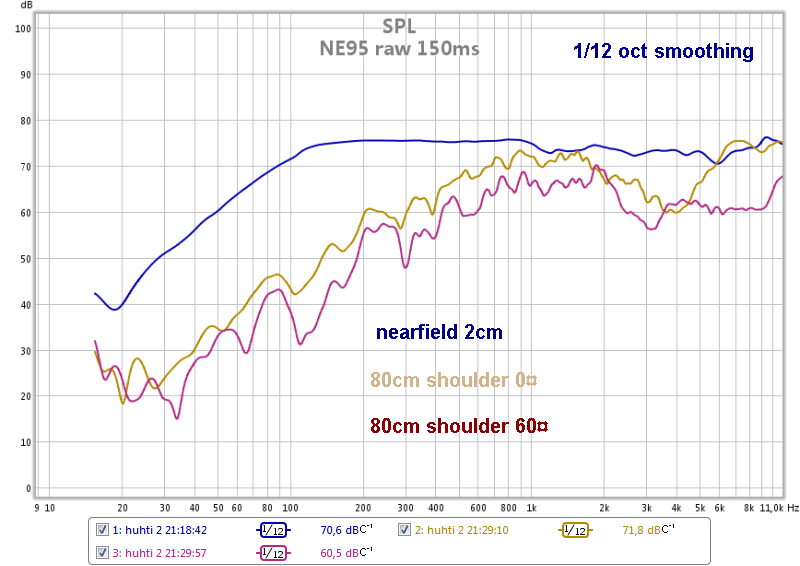

The fact is that our ears are placed laterally at the head
We don't hear what comes directly in front of us because the sound ( wave) has already spreaded and bounced ( the walls...) so we hear an integration of direct and reflected sound.
Humps and dips are "local" directivity effects which cannot be fully compensated in axial response without corrupting power response. Please use better diffraction simulator than Edge to study that 😉
^Yes you are right,they can't be eq'd, (I knew that) and Edge tells that too by the way.
My recommended practise is to lowpass well below the ripples! Only the tweeter remains problematic then! The baffle must get narrower as frequency goes up. This is almost impossible to make working throuh all octaves. My AINOgradients follow this principle, dipole bass and midrange operate in linear directivity range below baffle step peak, at the expense of sensitivity.
