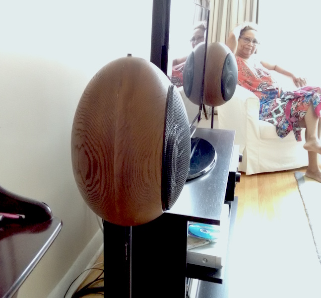

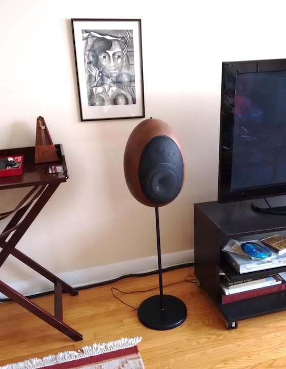

Diffraction...?
What diffraction?
B.
Everything has some diffraction. The edge of the grill on that device will diffract.
Edge...?
What edge?*
B.
*OK, maybe just a little edge. These were early production models from Leigh Instruments. Innards are sort of like Rogers/BBC LS3/5A with the usual 18-piece crossover, ferrofluids, bass-boost option, protective circuit breakers, and a bunch of mounting options....

Edge...?
What edge?*
The frame of the grill. If you follow a line from the driver along the face of the front panel towards the edge of the grill it will hit the frame and diffract there.
It's actually pretty hard to make a grill whose frame doesn't cause any diffraction, as by definition it's going to have to have a frame to support it, and that frame is going to obstruct the propagation of any sound travelling along the baffle. (Absorption around the edge of the frame may be the only way)
Which is one reason why my speakers have removable grills - grills are on for casual listening like watching TV to protect the speakers against my 2 year old but they come off for serious listening when he's otherwise occupied... 😀
...It's actually pretty hard to make a grill whose frame doesn't cause any diffraction... Which is one reason why my speakers have removable grills - grills are on for casual listening like watching TV...

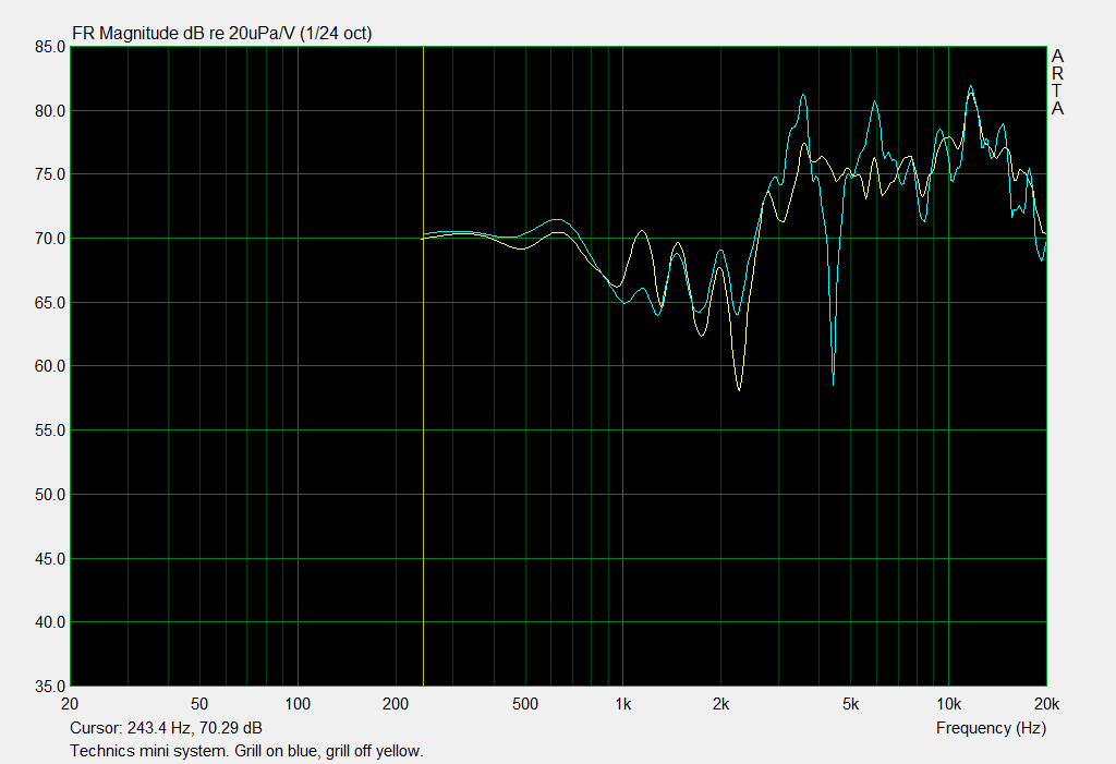

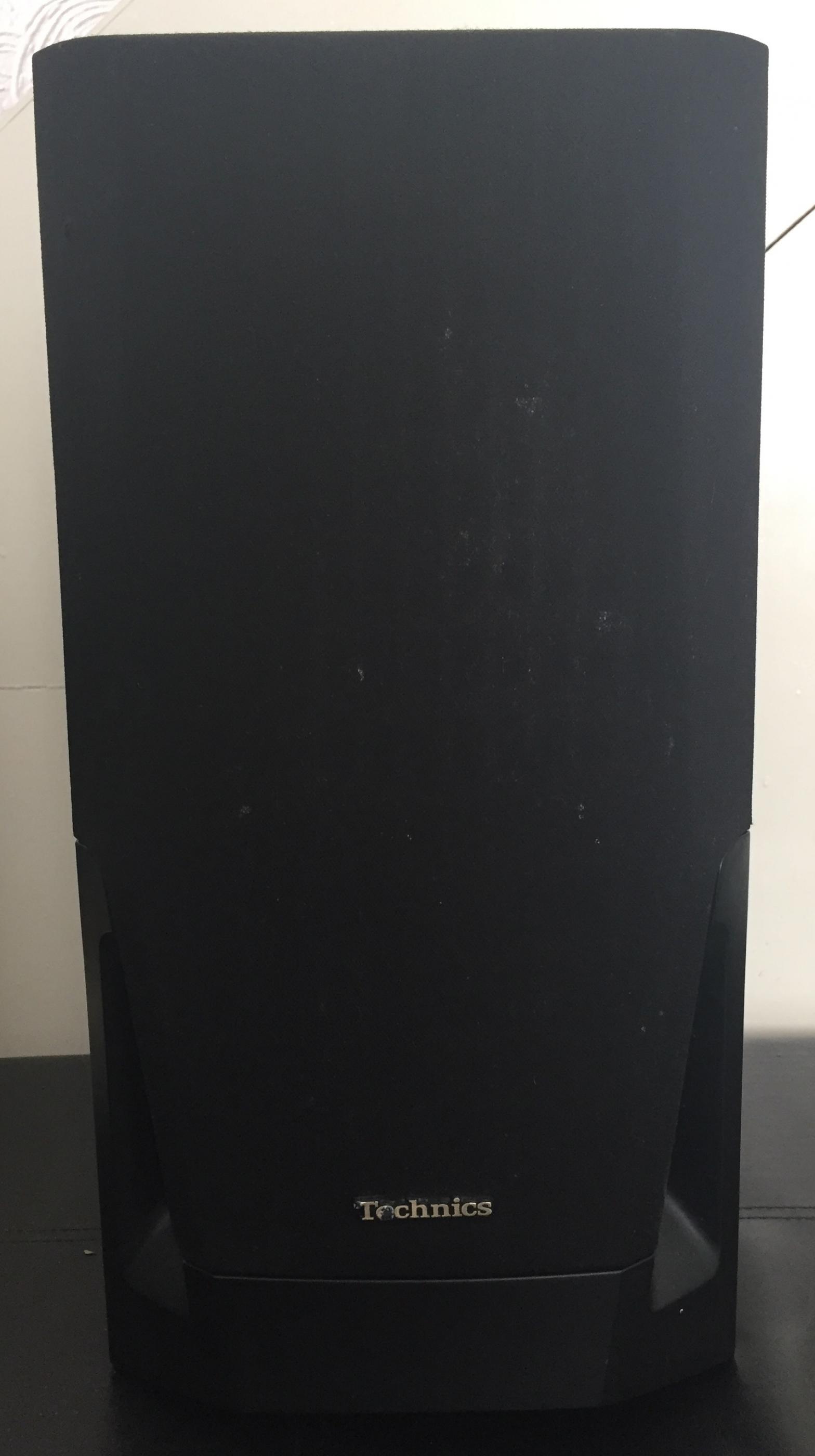

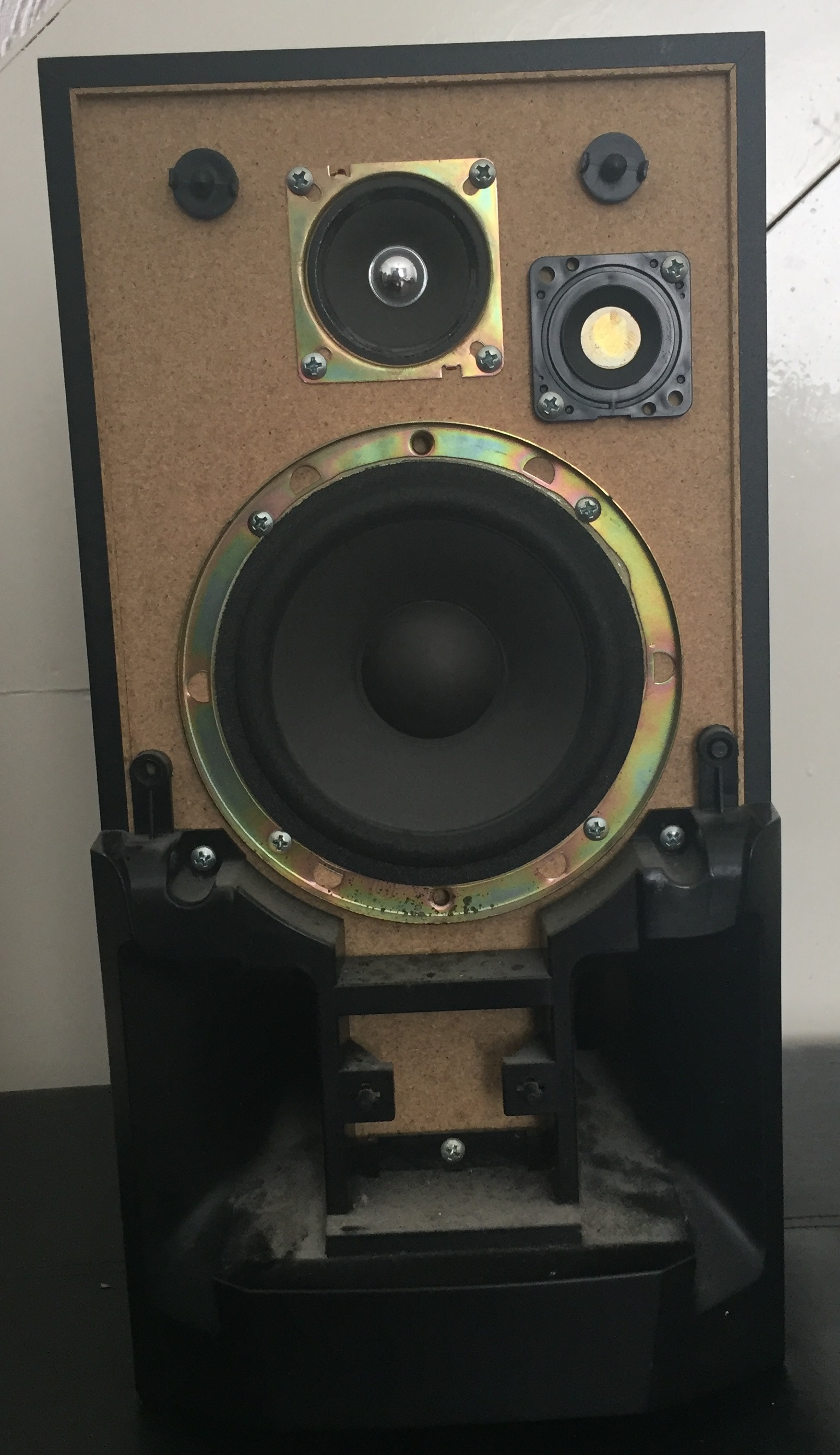

I don't have grill / no grill measurements of my current speakers, but I have performed these comparisons on many other speakers in the past, so I'm not just blowing hot air as you put it. In fact I took some recent measurements of a cheap pair of Technics speakers at the same time I took my driver measurements for my crossover design.
They are a small pair of crappy mini-system speakers that I had been listening to while my main speakers were having their cabinets and crossovers redesigned, and I was curious to see how bad they measured, as they sound pretty average and I had never measured them before.
The first measurement I did with the grill on (light blue line on the graph) was so horrific in the treble, with up to 20dB variations, that I did a double take and thought there was something wrong with my measurement setup, windowing time etc.... but nope, that's how bad they measure.
I then removed the grill to see how much of that was diffraction effects from the admittedly very intrusive grill design and you can see the difference in the yellow line from 3Khz upwards which is dramatically flatter, although still not great. The peaks at 3.5Khz and 6Khz are gone, as is the deep notch at 4.5Khz. Not surprisingly they sound a lot smoother in the treble with the grill off!
The hole in the midrange from 600Hz to 3Khz appears to be down to a dreadful crossover design which not only doesn't match the driver sensitivities but also seems to have phase cancellation problems at the crossover frequency as well! Not a good speaker, although I have certainly heard worse speakers in the same category.
Now granted if you look at the photos of the speaker it's pretty much a worst case scenario when it comes to diffraction either with the grills off or on, and perhaps a case study of how not to design a low diffraction speaker... With them off the plastic port tubes at the bottom remain causing a large source of diffraction for the woofer, none of the drivers are flush mounted, the edge of the box actually has a lip, and so on.

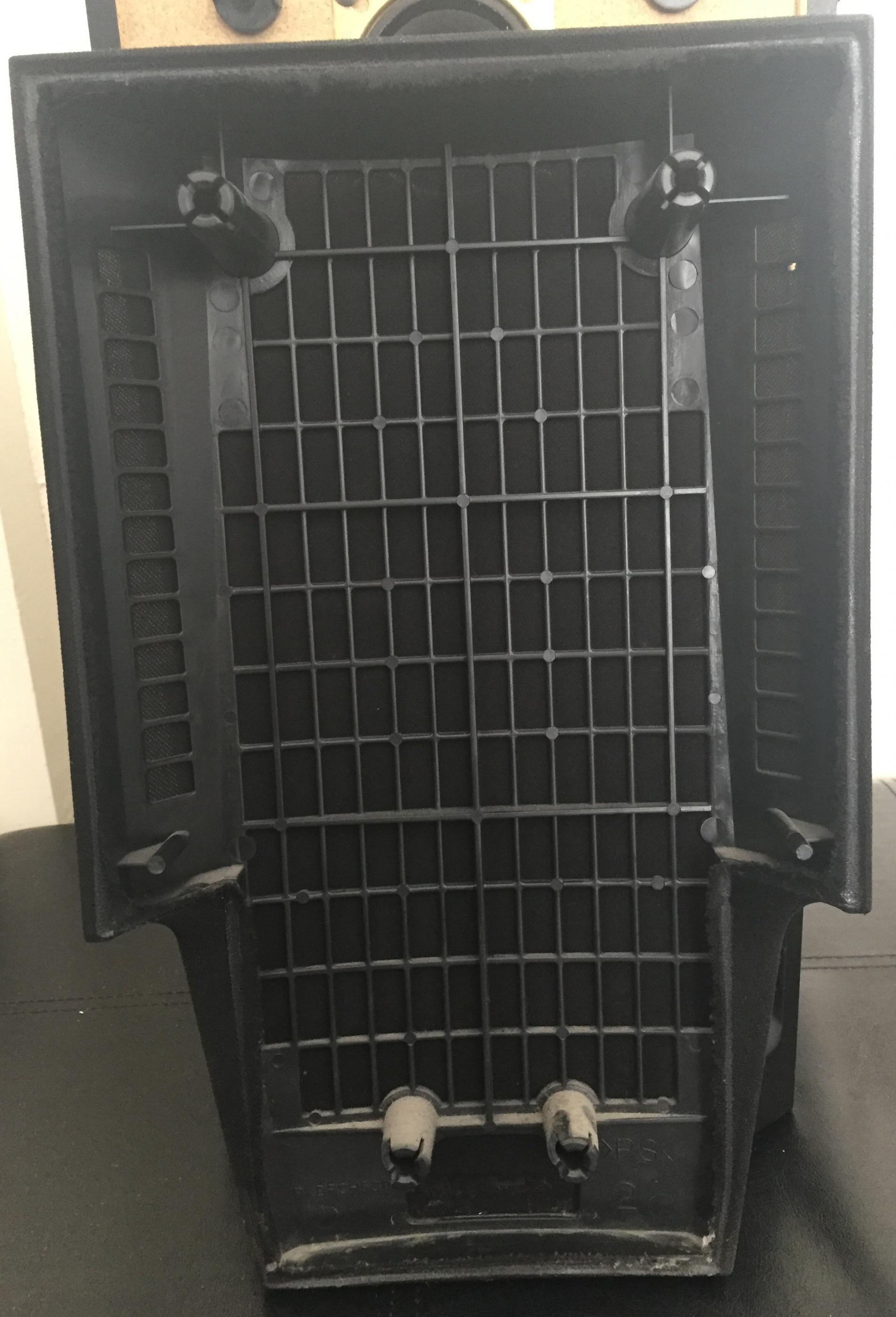

Looking at the back of the grills they wrap right around and have plastic ribbing covering most of the area of the grill, so they won't just be diffracting at the edge.
But this is an actual measurement of a real life, commercial speaker to illustrate just how badly a grill can affect the response, and not made up "hot air".
The grills on my speakers are a different design - they are flat, there is no reinforcement ribbing in the middle, it's purely just a flat sheet of fabric pulled tight by an outside rectangular frame, so there shouldn't be any diffraction from close proximity to the driver like there is on the Technics, the only diffraction will be from the frame at the edge, so far less severe than exhibited by this Technics speaker.

As we can see in post #135 example, grill diffractions induce changes above 500Hz, mainly above 1kHz. Indoor measurement at 1m on-axis, IR gating 4-5ms is totally valid and easy to perform to verify diffractions of baffle/grille. Baffle step range influences are minimal because of long wavelength. This kind of measurement shows always some other reflections, but we are investigating only the difference here.

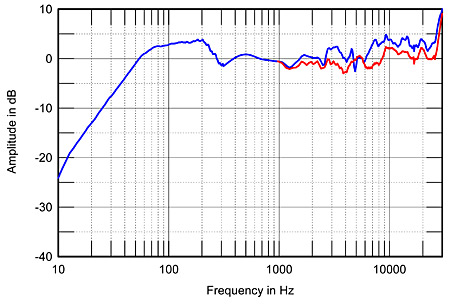

Grill frame diffraction effects on frequency response
Some commercial speakers are smoother with the grille on! Avalon Acoustics Indra loudspeaker Measurements | Stereophile.com

Of course, the grill plot DBManddrake shows is the worse grill ever designed by humankind since approximately the year Homer was born. Have a close look at the picture.
And using 1/24 smoothing might show differences in the treble even a fly landed on the grill before the run, if I may exaggerate a bit.
And somebody might wonder why the two curves don't superimpose perfectly below say 750 Hz like they seem to when I repeat runs quickly together.
