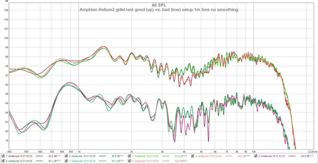

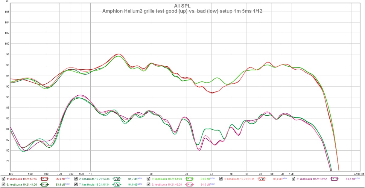

It took me some 15 minutes to shoot these for ya. The room is 3x4x2,7m.5ms gating here. Green lines with grille off.
I can see the grille's effect, do you?
The speaker is Amphion Helium II

What makes you think grill edge diffraction only affects the tweeters frequency range on a 39cm wide 59cm tall baffle ? On that size baffle it will have effects far below the tweeter's operating range.
Even with the speaker up on a stand in the middle of a room the longest reflection free time window I can get for measurements is about 4.2ms which only provides a resolution of about 300Hz.
Where the speakers normally sit in the living room near other objects the reflection free time is well under 2ms, perhaps 1.5ms making any such measurements pretty useless, especially when the whole point of the exercise is to find diffraction effects belonging to the speaker itself and its grill, not nearby objects right beside the speakers!
So sorry, I don't agree with your comment - there is no point taking measurements if their validity is completely questionable. I see enough poorly taken measurements on this forum already by people that don't understand how to properly perform a windowed measurement that is free from room effects that I am not going to add to them with obviously dubious measurements that prove nothing.
Bogus measurements are worse than no measurements at all. When I get the chance to take some suitable measurements I will. Until then you'll have to take your own!

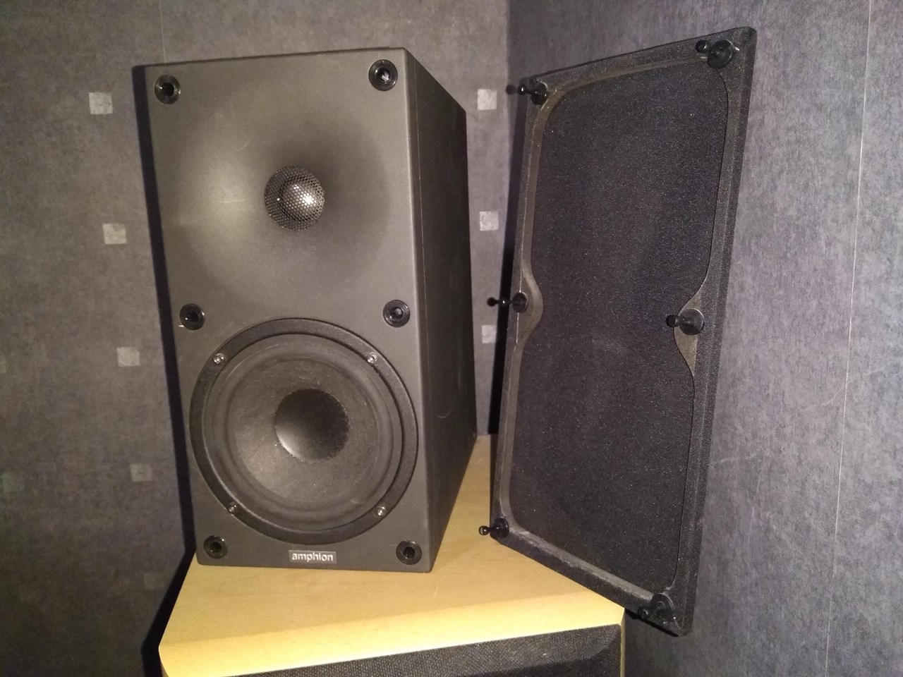

Thanks very much. Picture of the grill?
Looks like there is a 1 to 2dB influence over a small fraction of an octave. Even with instantaneous switching between states (if that were possible playing with a grill), likely you would not consistently hear a difference in tone using white noise.
But with random blind testing with white noise unlikely anybody could guess well. And on music, not a chance.

Of course, the grill plot DBManddrake shows is the worse grill ever designed by humankind since approximately the year Homer was born. Have a close look at the picture.
As I said, those speakers are a case study in how not to design a grill or front baffle, and hence were a good example of just how bad grill diffraction problems can get, (even I was shocked at how badly they measured) sadly they are very representative of a lot of cheap speakers on the market that are built with no regard whatsoever for diffraction!
I'm not suggesting that a well designed DIY speaker/grill is nearly that bad - in fact I sincerely hope my grills aren't anything like that bad! On the other hand, I specifically made them removable so I can leave them off when I want improved quality, and while the speakers still sound pretty good with them on they definitely sound better with them off. The crossovers were optimised based on grill off measurements so I guess that's not surprising.
And using 1/24 smoothing might show differences in the treble even a fly landed on the grill before the run, if I may exaggerate a bit.
Sorry, I don't agree with that. I always use as little smoothing as possible in measurements - I want to see the truth, not some "airbrushed" response that makes everything look better than it really is. In ARTA 1/24th octave is the least smoothing possible in some measurement modes, so that's what I normally use.
Diffraction requires a high measurement resolution to measure properly, why would I want to deliberately throw away all the measurement detail so that I can no longer see the issue at hand ? It would be like deliberately wearing a pair of glasses that makes everything seem blurry just so you don't see defects in the paint job of your house! 😀
And somebody might wonder why the two curves don't superimpose perfectly below say 750 Hz like they seem to when I repeat runs quickly together.
My measurements are 100% repeatable - I always take multiple measurements with the same test conditions to make sure of this, and the measurements overlay perfectly. The changes shown in the plots as low as 600Hz are actual, real changes caused by the grill and baffle diffraction.

The periodic wiggle most of the way through your measurement is a clear sign that you have your gate time set too long and that a reflection has entered the measurement window.
Did you check the impulse for the first visible reflection when choosing the window time ? Another possibility is that you have a reflection from your microphone stand, which would have a time delay too short to be windowed out.
I'd try to fix that rather than applying smoothing as your measurement is misleading when it includes reflections, and applying smoothing won't fix this. I never find it necessary to apply smoothing to high frequency measurements when they are properly windowed.
