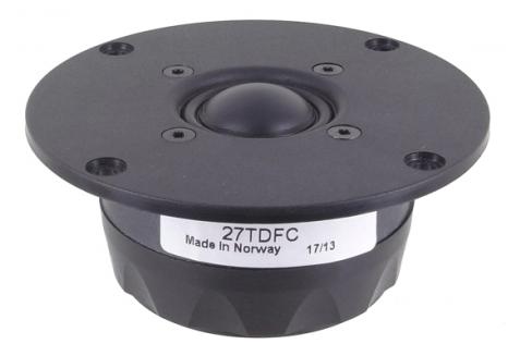

I've attached a typical dome tweeter.
There are two types of diffraction with this type of tweeter. One is from the front panel itself. The next one is at the edge of the baffle.
I'm afraid flush mounting and rounded baffle edges won't help much. Neither would attaching absorbent material around the tweeter.
