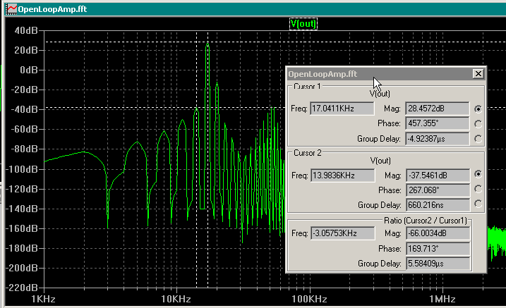

The plot of the output spectrum for the open-loop amplifier is shown below. The difference in marker values (Cursor2 / Cursor1) can be seen as -66 dB.
So now the question becomes "What happens if I do this same test using a feedback amplifier"? If I use the same 1.9A peak current for the interfering signal, what will the ratio of the desired signal at 17 kHz to the dominant third-order intermod product at 14 kHz be? Will it be better or worse than that of the open-loop amplifier?

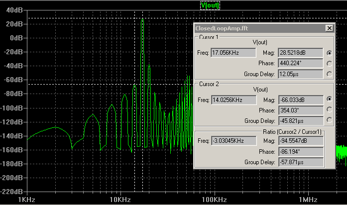

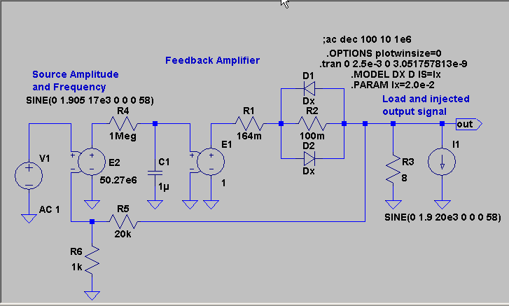

Okay, I put together a model of a feedback amplifier with a nonlinear output impedance. Since there was some speculation that low to moderate amounts of feedback might make the "back EMF" (hehe) problem worse, I decided to pick the gain-bandwidth product to roughly match the Leach amp, which is a very modest 8 MHz. This means for a gain of 21 that the unity loop gain frequency will be roughly 8 MHz / 21 = 381 kHz. That's a very conservative design. This gives about 25.6 dB of feedback at 20 kHz. The model is shown below. I gave it an open-loop bandwidth of 1 radian per second (horrors, that's less than 1/6 of 1 Hz!) and a DC open-loop gain of 50.27e6 or 154 dB.
The schematic is shown below.
You can see the output spectrum in the graph below. The output voltage at 17 kHz is the same (40 Volts peak) and the amplitude of the interfering signal is the same. But what has happened? The third order intermod at 14 kHz, which was 66 dB down from the main signal at 17 kHz in the amplifier without feedback is now 94.6 dB down for the amplifier with feedback!
Chalk another one up to the evils of negative feedback :clown:
You beat me to it!
I was working with your model - that BTW is the most distorted output stage ever designed 😀 and a more real triple follower output stage.
With the triple, using 2Khz (a freq the ear is very sensitive) and 50Hz (a likelly ressonant freq, where a driver would have most of it's energy - and back EMF should be maximum), sidebands are -110dB...
As you've said, if back emf is a problem is because the designer did a lousy job...
