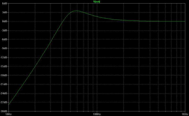

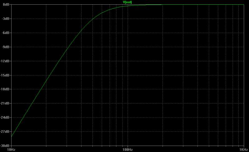

And here's the response of the same speaker when connected to a low damping (1) amplifier.
This change in response can be made just by adding a resistor in series with the amp.
Sound will be fuller, bass will be a somewhat boomy. If the speaker lacked bass, this can sound as an improvemet.
But it's not due to any special quality of the low damping amp - it's just because it has low damping by design.

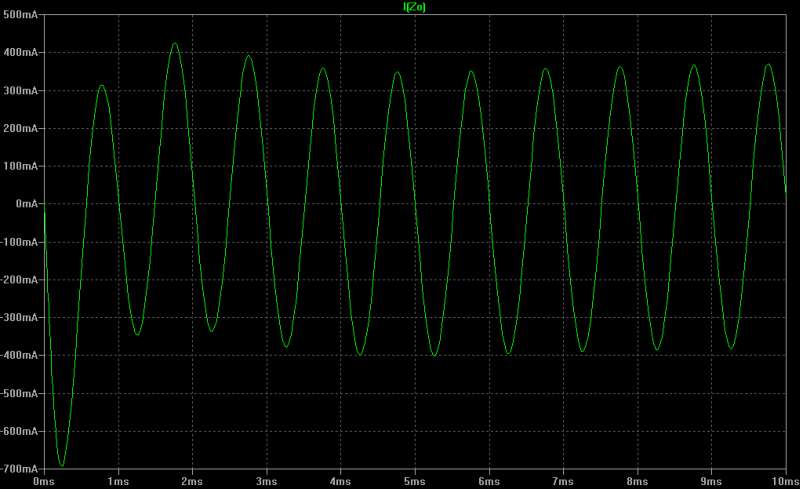

Hi all,
Back in the first post of this thread, Jorge introduced a model for showing how internal signals of the amp would be affected by introducing the so-called "back EMF" signal driving the amp's output.
One of the concerns that came up was that Jorge's model is purely linear. It would be nice to be able to simulate in SPICE what Hiraga was doing with some of his intermod tests, as well as what Mauro has been doing on the bench too. Back in the "many faces of distortion" thread, one of the things that was discussed was the nonlinear output impedance of a class AB amplifier. It occurred to me that if a one-port behavioral model for this nonlinear impedance could be created, the Zo component in Jorge's model of Post #1 could be replaced by the nonlinear model. Then, the "interface distortion" (to use Otala's term) could be computed and the effects of feedback could be studied in a controlled way. For instance, we could get graphs just like Hiraga's.
I've been playing around with using polynomial controlled sources with the polynomial coefficients set to a "best fit" of the modeled SPICE V/I curve at the EF output. These experiments have been unsuccessful, as the models have a bunch of "wiggles" in the I/V characteristic that aren't present in the simulated data using transistor models. For the optimized bias current case, the output Z vs current has a pretty complex shape, with a hump on both sides of zero output current. However, it occurred to me that the condition of slight underbias, which has only a single hump in the middle, could be modeled behaviorally in a pretty simple way.

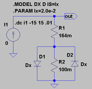

I've attached a picture of a model I've created to do this below. It consists of R1, R2, D1 and D2. The current source is there to test the impedance vs current so I could match it as closely as possible to some other simulated data of a complementary EF. This EF had two each paralleled NPN and PNP output devices. Emitter resistors were 0.22 Ohm, and there was a small source resistor to simulate the non-zero output impedance of the drivers. The circuit was slightly underbiased. I had to crreate my own diode model Dx, with an Is of 20 mA (!) to make the impedance vs current curves agree with the EF simulations.
By replacing Jorge's Zo with this model, we could have a circuit that has distortion, and that distortion would consist entirely of the interaction of the nonlinear output impedance of the amplifier with its load. IOW, all of its distortion would be interface distortion. In that way, investigating the effect of feedback on distortion is equivalent to investigating the effect of feedback on interface distortion.
That's the first half of the proposed analysis. The second half deals with how to get LTSpice to do IM tests without having the problem of DFT leakage (spurious frequency components). That's the topic of the next post.

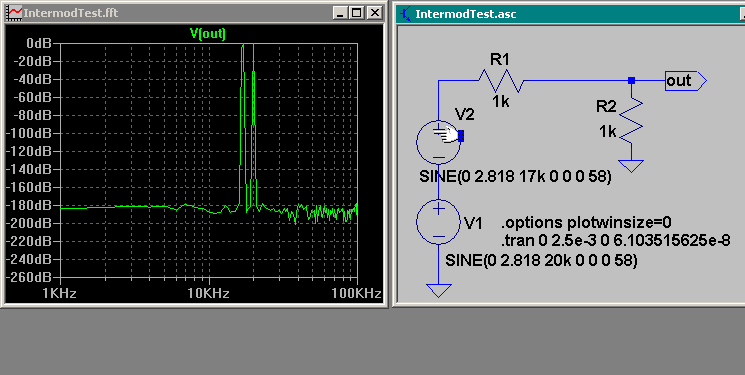

For a while now, I've noticed that jcx has been doing intermod simulations with LTSpice. Until yesterday, I haven't been able to figure out how he did it without getting all kinds of spurious frequency components in the FFT. The answer turns out to be pretty simple. It all comes down to figuring out the answers to the following two questions:
1) Is the sum of the two input signals, which have different frequencies, a periodic signal?
2) If so, what's its period?
The answer turns out to be so simple I'm embarassed I didn't see it earlier. A signal with period T is also periodic with period N*T, where N is an integer. The attached picture shows a 17 kHz signal plus a 20 kHz signal. If we take N = 20 for the 20 kHz signal, we find that it's also periodic with period (1/(1 kHz)). If we take N=17 for the 17 kHz signal, we also find it to be periodic with period (1/(1 kHz)). Our combined signal therefore must be periodic with period 1 msec. So all we have to do is take a sample period that's an integer multiple of 1 msec to do the FFT. I also picked a time step that's the period of the 20 kHz sine wave divided by 16384 (the default number of FFT samples) but I'm not sure this is necessary. No windowing was used.
The results are shown below. Notice that the residual distortion and noise are 180 dB down. Not too bad! I suspect that jcx may have a better way of doing this, but it looks good enough for now.

andy_c said:For a while now, I've noticed that jcx has been doing intermod simulations with LTSpice. Until yesterday, I haven't been able to figure out how he did it without getting all kinds of spurious frequency components in the FFT.
Andy
You're right in that the best is to have an even number of cycles (t=n*1/f)
The shorter the step, the better - I use at least 1000 steps (50n for 20KHz), more is better. It doesn't have to be a submultple of the freq.
Besides, it's very important to go to Tools/Control Panel/Compression and disable compression.

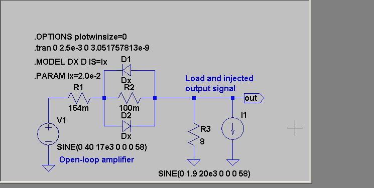

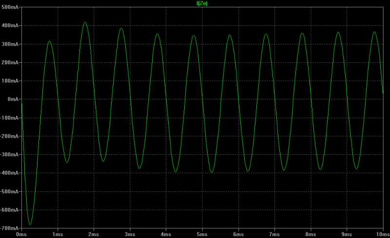

I've been playing around with this, simulating an open-loop amplifier. The picture below shows the circuit configuration. The open-loop amp is simulated as a simple sine wave voltage source with the nonlinear output impedance in series with it.
The output voltage is 40 Volts peak at 17 kHz, with an 8 Ohm load, or close to 100 W. An interfering "back EMF" (ha ha) signal is placed at the output, of frequency 20 kHz. When doing the FFT of the output, the frequencies of 17 kHz and 20 kHz will be seen, but there will also be intermodulation products at 14 kHz, 11 kHz, 8 kHz, 23 kHz, 26 kHz, 29 kHz, etc. The one with the largest amplitude will be the primary third-order component at 14 kHz. What I'd like to do is find the amplitude of the interfering current such that the 14 kHz third-order distortion component is 66 dB below the desired output at 17 kHz (0.05 percent distortion for this component).
This value turns out to be 1.9A peak. Note: I tried going up to -60dB, or 0.1 percent distortion, but it took huge currents. Over 10A and I still didn't get there. Anyhow, the schematic is shown below. Jorge, you should be able to see all my options and time step as well. The time step is the period of the 20 kHz signal divided by 16384.
