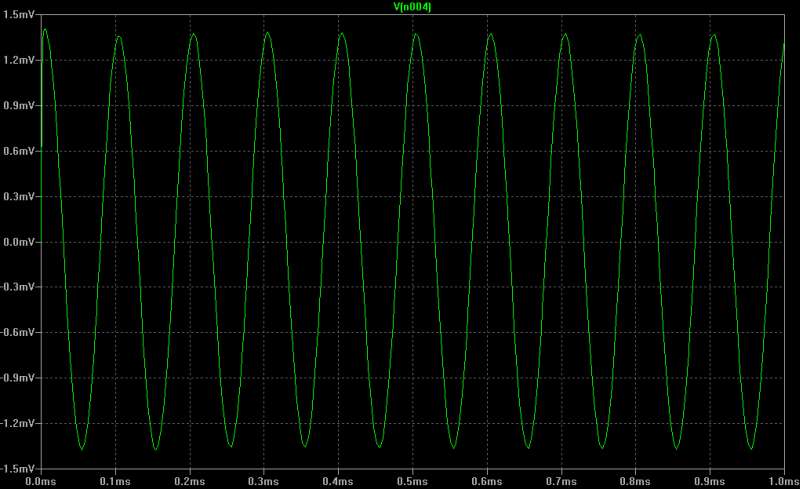

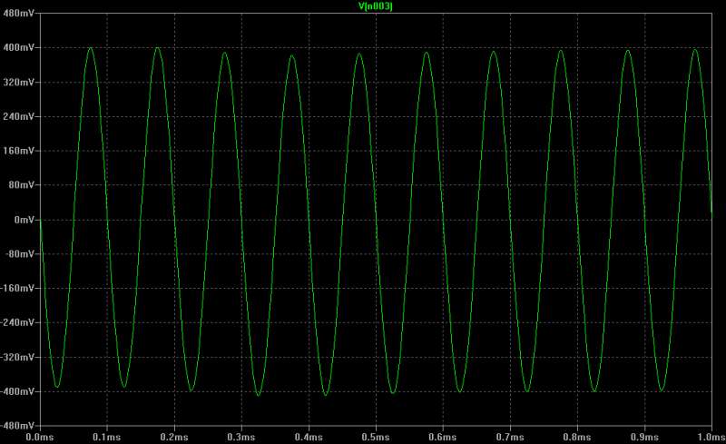

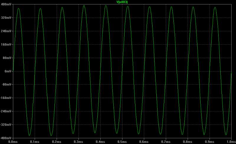

I'm confused about that last graphic, Jorge. In post #2 and post #3, it looks like when the loop was closed, the output node was renamed from n003 to n004 due to the different hookup.
But in the last two graphics, they are both n003 and look approximately the same before for the before and after feedback cases. I'd expect the waveform of the last graphic (post #22) to be much lower in amplitude than the one in post #21. Was there a mixup in the graphics files or am I misunderstanding what you're plotting here?
Andy
Node 004 is where Zo connects to the speaker in the O.L. case.
Node 003 is the output of the current gain stage (U2) in the closed loop case.
Node 004 is where Zo connects to the speaker in the C.L. case.
In posts #2 and #3, I was showing the effect of feedback on damping, and in post #4 I was showing that U2 was outputing the same voltage as before (but with inverted phase) to increase damping.
Sorry if it wasn't clear.
Here's node 004 at 10 KHz - voltage is higher (compared to 110Hz) since there is less NFB due to U1's pole at 3 KHz..

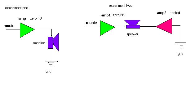

Hallo guys
I would suggest a little experiment about real audibility of back EMF/feedback related stuff.
1.Take a low/non feedback amp like Pass or tube amp (called amp1), which you assume it has no problems with back EMF distortion. Speaker's connected between output of amp1 and ground.
2. Listen.
3.Take a high feedback (or amp being tested) amp (amp2 ) and make it 'amplify the ground', I mean input to zero potential. Than connect speaker between output of amp1 and amp2 creating a kind of bridge. (amp2 of higher power than amp1)
4. Listen and compare to point 2

Nice suggestion, but to be a valid test one would have to make some more compares:
- The one you've suggested;
- Non Feedback - speaker - non feedback
- Feedback - speaker - feedback
Paying close attention to acoustic level output (use an SPL meter to calibrate before each test)
Any volunteers?

I assumed, that if tested amp has damping factor of >200 and offset voltage <30mV and nothing like EMF-induced-distortion ever occurs, than both 'should' sound the same
about SPL level:
no meter needed, only a switch between 'real' ground and output of an amp 'amplifying' ground.
about SPL level:

About the test:
If an amp sounds bad, how will one knows if it's due to NFB or not?
That's why I suggest more than one test.
About level
For the high NFB to ground case, you are right.
But quite likelly the non NFB amp will have a higher output impedance and level will be less.
It's known (and by salespersons...) that the higher volume amp 'sounds' better at first listen!
