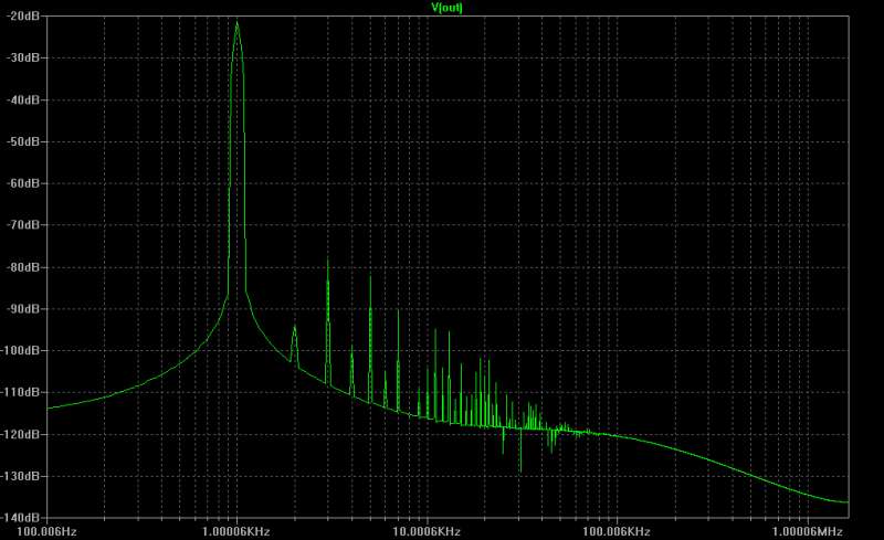

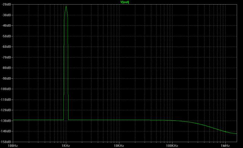

Here we have 2 hypothetical high feedback amps, opamp based (SPICE models).
Both are stable under capacitive loads, have less than 0.005 % THD at 1Khz, comparable feedback factors, comparable open loop BW, same output power and gain.
A 0.22 ohms resistor was added in series with the output inductor.
The first is a refined project, using a triple/CFP output topology, very low output impedance (VERY high damping)
The second is a less refined design, output is just a CFP but signal is taken from the collectors (so more like a transconductance amp).
To both a 1kHz, 5V peak signal was applied in series with the 8 ohms load resistor and Interface distortion was measured at the output..
Here's distortion for the triple output amp:
