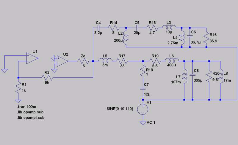

There is a lot of arguments going on at the forum re the influence of back EMF.
Just to give some perspective to beginners, here is a simulation, using as a load a real speaker model (also posted in the forum):
U1 is a high gain voltage stage (gain = 10K, BW = 30MHz) like the input section of an amp, U2 is an unity voltage/high current gain stage, like a triple EF output.
Zo is the open loop output impedance of U2.
The components to the right of Zo model the speaker, to which a 10V peak (possibly a very high value) back EMF is apllied at 110 Hz, where the speaker is reactive.
First, the circuit, with U2 input connected to ground - this is a no feedback situation.

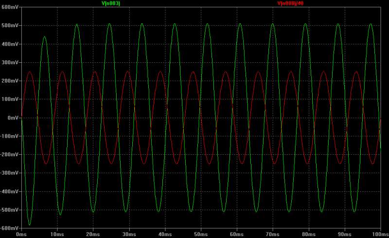

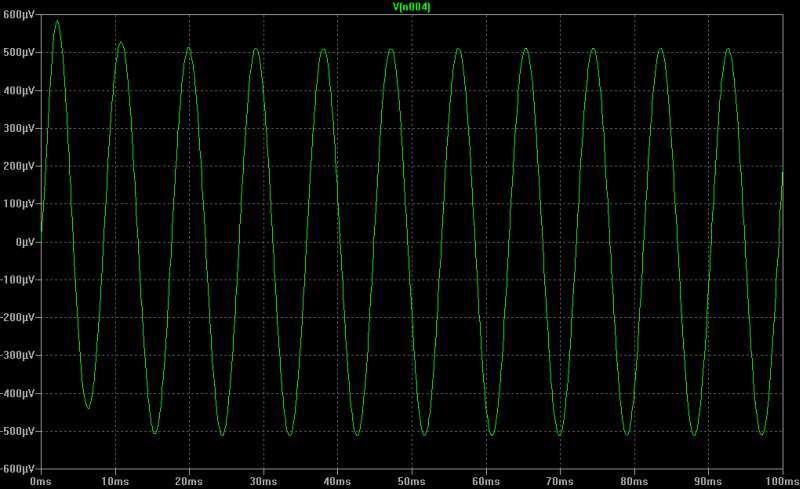

Now, let's close the NFB loop, connecting the + input of U2 to the output of U1.
The voltage at the right side of Zo is some 500uV peak, showing that damping has increased about 1000 times.
The question then is; how was this achieved, which are the effects on sound quality?

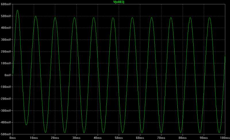

Part 4
Here we have the voltage ar the output of U2 - 500 mV, the same value there was at the amp's output before feedback!
Just ot make it clearer, it's shown also the EMF voltage in red just to make it clear that U2's voltage is almost 180 deg out of phase with the EMF one.
As a conclusion, no additional stress was placed in the amp (in both cases the amp's output was 500 mV) due to feedback.

Re: Part 4
:cannotbe:
In the open loop configuration you had 500mV at the right side of
Z0, but the output of U2 was probably zero.
In closed loop the right side of Z0 is regulated close to zero, but
the output of U2 is now showing 500mV in counterphase. There is
additional stress to the amp. How about analyzing the current through Z0 in both cases? I guess it will be about around 6% higher in the closed loop configuration.
Anyway, the additional load usually is not much trouble for an amp.
But you already have posted the most important question:
How does this differnce sound?
Well, I guess for this question this simple model is not suited, because it has no frequency dependency of the feedback and also
no nonlinearyties. And even if you would place these effects to the
simulation, even then the model would just deliver some graphs and numbers. But no audiable human perception...
Nevertheless- I like your simulation, because it shows the idealised
behaviour of an nice working feedback.
:2c:

I do not agree. Making U2's output impedance close to zero and then lumping the real output impedance in Zo is simply a convenient way to show what's going on.
If the output current and voltage are the same, stress is the same, no matter where one shows it.
You're right. Open loop the peak current in Zo is .975A and in closed loop it's 1.023, or about 5% more, very close to your estimate.
