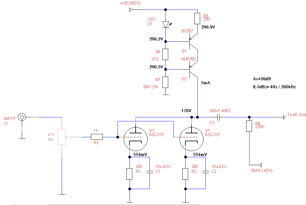

I have followed your advice and tweak the circuit accordingly. I now have the 45 operating at 33mA/244V using a 5K primary winding and can get 840mW at 2.2% THD from an input grid signal of 35V.

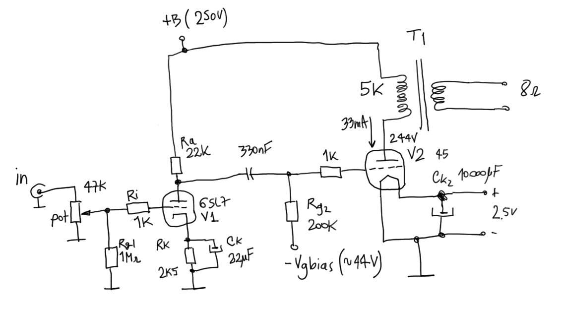

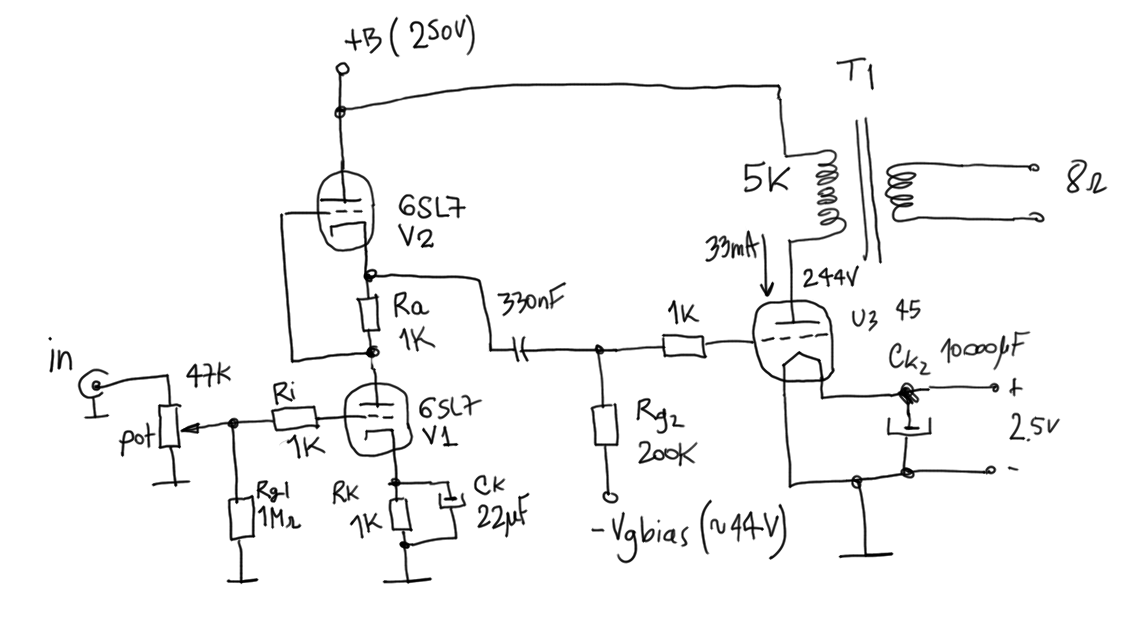

Now I have to driver options: an SRPP (option 1) and a simple cathode ground (option 2)
The symmetrical SRPP has of course better gain, less distortion and better PSRR. This configuration runs at 1mA and has a gain of 47.5
The common cathode circuit also is running at 1mA but gain is 22 - enough for what I need to drive the 45 SET I think. Of course the PSRR is worse and the output impedance is slightly higher than the SRPP - 14K against 12K
Is it worth implementing an SRPP in this configuration? Is the improvement in distortion that significant compared to the other option?
Should I try to add a CCS to the simple ground cathode circuit to get a bit of more headroom and better PSRR?
Thanks for the help - I'm really new to valve circuits.... 🙂

Hi Ale,
I think your circuit is unnecessarily complex. I don't see any advantage of the SRPP. It only brings problems with kathode-heater voltage differences and the need to elevate heaters. I played around with SRPP and mu followers a long time ago but dismissed them. I prefer transformercoupling, or if on a budget plain RC coupling.
I have mentioned in another thread that I think the 6SL7 is not well suited as a driver. if you insist on it, parallel both sections and run it RC coupled. Better choice is trhe 6N7 as mentioned by me earlier in this thread.
If you have the possibility for higher B+, use cathode bias on the 45. Way simpled than fixed bias.
Other points:
Why the huge grid stop resistor on the 6SL7? I've never experienced oscillations with the 6SL7, no grid resistor needed at all. Also the 45 will run fine without the grid stop resistor.

Hi Thomas,
Thanks for your help. Why would you use a 6n7 instead of a 6sl7? The 6sl7 has good gain.
I have many 27 I wanted to use but given the low mu, I don't think I can use them with my current design. I'm keen to see whether using SRPP has a significant advantage that is worth adding the extra complexity in the circuit...
Grid stopper is suggested in the tubecad design, do you suggest removing it?

Hi!
22k is way too low for a plate resistor for the 6SL7. The SRPP stage probably has the 13k ouptut impedance on paper. But running at 1mA it cannot really deliver a lot of power to the 45 grid.
While the 45 is fairly easy to drive it is advisable to drive with more guts than the 6SL7 can deliver. gain is not everything. A transformer coupled 6N7 stage will have about the same gain as a 6SL7 SRPP. For RC coupling it would be better to have higher B+ for the 6N7 (about 400V)
I used the 6N7 transformercoupled to drive the 45. This works nicely with Lundahl 1660/10mA.
SRPP circuts are know for their very load dependent distortion behaviour. Also the difference in heater-cathode voltage can cause the tubes to turn microphonic after a short while.
But best experience is to built different versions and listen to them.
About the grid stoppers: yes no need for them 6SL7 has low transcond8uctance and does not tend to oscillate. I built quite a few 45 amps, never used a grid stopper.

What is the current sunk by the output stage? If the miller capacitance is (a+1)*cg=28pF with a gain of 3 approx, then is pretty insignificant since the impedance at 10kHz will be about 560K (if I'm not mistaken) so the only significant load to the driver is the 200K bias resistor through the coupling capacitor of course, correct?
That is probably 100uA of sink/source from the driver. Have I done things wrong here?
How can you determine that the 6SL7 operated at 1mA is not sufficient to deliver the output power required by the 45 stage?
I haven't done this type of analysis for more than 10 years so apologies if I've made a massive mistake or assumption 🙂

I didn't imply hat it is insufficient, just that there are better choices IMHO. The 6SL7 will work. A grid, especially of a power tube is not a linear impedance. As it is excited it can show various non linearities due to grid current. A good design has a driver which is not heavily impacted by such effects.
I also prefer to have a driver with lots of headroom. The 6SL7 will have minimal headroom and thus contribute significantly to the distortion spectrum of the amp.
These are the typical designs which tend to change their sound character a lot if you do small changes in op point and B+. These are then often falsly attributed to the op point, B+ level, or even the rectifier tubes.
As suggested, if you stick with 6SL7 parallel two sections of the 6SL7 and run 2mA through them.

Hi everyone,
After some time I'm back on the 45SET project. I breadboarded the circuit with two paralleled 6SL7 driver using a resistor anode load and coupled to the 45 via a capacitor. Good results so far, so I spent most of my time building the chassis.
Now, after seeing the 4PL1 post from Wavebourn, I was encouraged to replace the anode resistor with a transistor CCS. Was keen to get into a mosfet gyrator, but I guess I needed to try a simple CCS to see the results.
I did a first FFT simulation with LTspice and got around 1.6% THD with the resistor load. I only considered the second harmonic for simplicity. I then replaced the anode resistor with the CCS as in the attached diagram. I got around 0.1%THD if my calculations are ok.
Before moving forward and build the final circuit, does anyone have any recommendations to this setup? Will it be worth pursuing a mosfet gyrator instead of a CCS?
Any suggestions are more than welcomed and thanks for your time.
Ale
