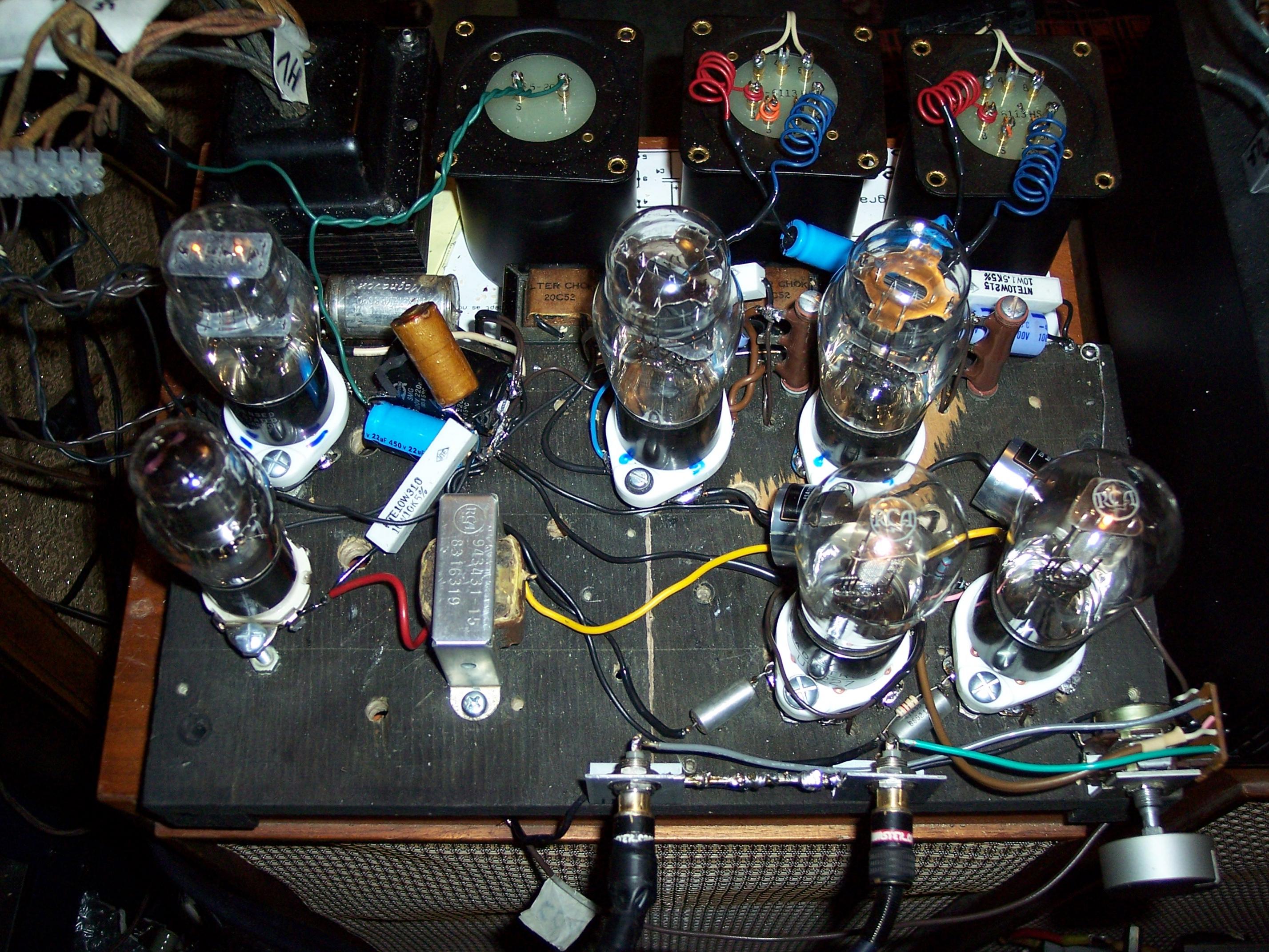

Back at the 45 SET
Back at the 45 set, It's been a while since I have been able to build, Hospitals just won't let you go home to play...
I have breadboarded my first attempt, and it sounds wonderfull!!
Rectification with an 83V
An 0D3 to regulate B+ on input stage
A pair of RCA Globe 27 mesh plate for input
A NOS Stancor power tranny
James JS 5-200 Choke, Choke input from rect for smoothing
And James JS 6113 HS for OPT
All is working quite fine, with absolutely ZERO hum at the speaker.
I borrowed a few ideas from http://nullspace.us/45.html
I used the 53V instead, and 27's since I have many NOS
The Topology that I used is similar, but changed many things due to parts at hand.
I will have to put togather a schem to share, as I assembled my revisions off the top of my head. Thinking as most of us do, "I'll remember what I did".
I am no expert here, but am proficient enough to get it done.
Here are a couple pics as it's running...

Hello, Mog
I am running the 45's which are NOS ratheon at 267 VDC plate at 37ma
and -44dc on the grid. I also have a set of NOS matched pair of kenrad's.
I could run them harder, but with only 2 sets of 45's I want to conserve their life.
I have center tapped 100 ohm resistors mounted at the filaments to provide a point for cath bias connection. At the center tap I have mounted a 10w 1500 ohm ww resistor bi-passed with a 100uF 100v cap.
I will draw up a schematic today and get it posted with explanation throughout the build from input to output "at least the best than I can explain". I have been building for the last 7 years and things "just make sense". I always breadboard amps first to debug everything within ratings and at times above, if it makes things sound better.
This is all I do everyday, retired and enjoying music.😀

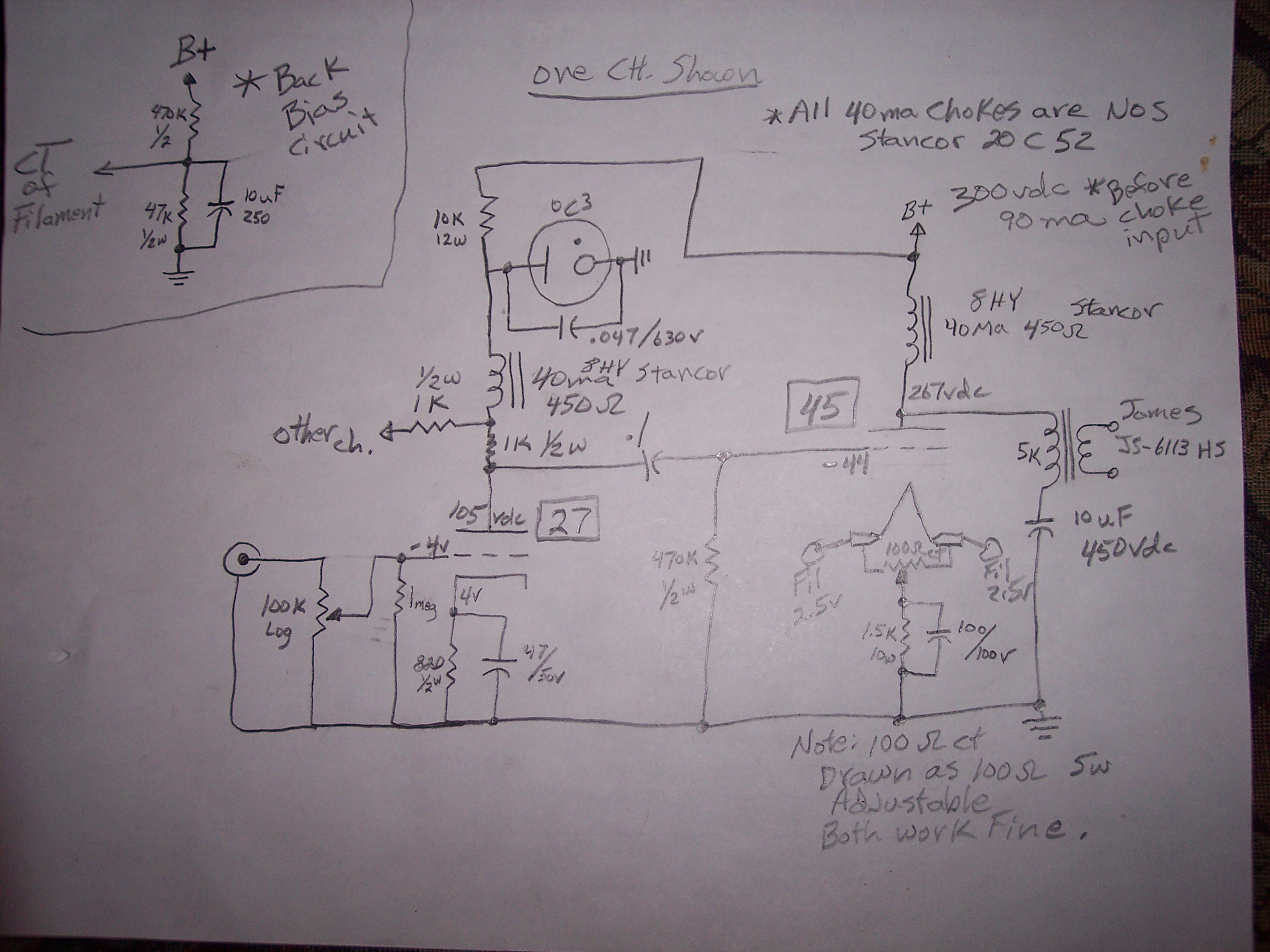

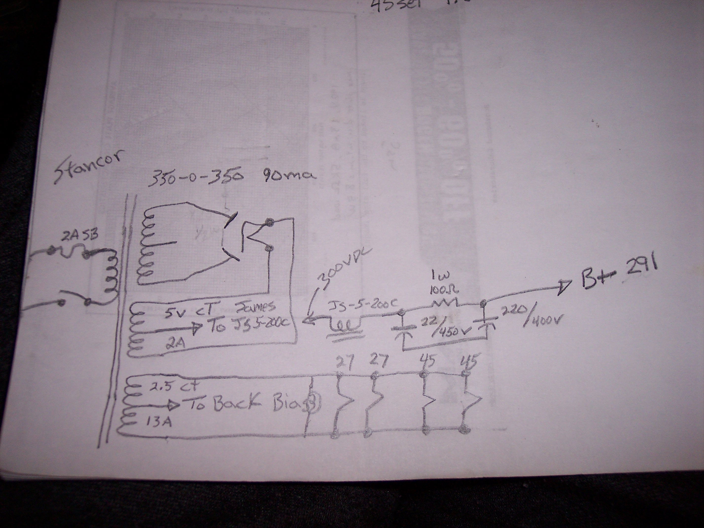

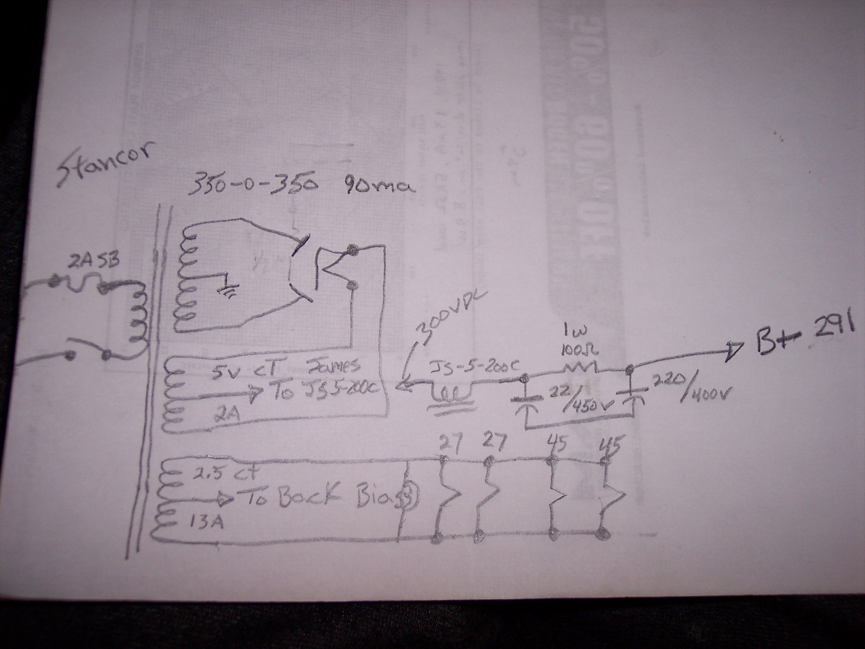

45 set circuit starter
Here are a couple circuits to get started. They are safe, but may want to tweak the 100 ohm 1w resistor in PS to get the B+ desired and you could go capacitor input for a little more B+, but I went with choke input for better regulation and lower B to start it off. I always start on the low side then bring things up a little at a time for desired effect. ** Note forgot to show ground on neg side of the PS caps. And circuit for amplifier next post. Sorry, going on almost zero sleep here...

Try using the James opt in a conventional arrangement with dc passing through the primary (they were designed to be used this way, and may not operate optimally with no current). Then use the freed up plate choke so you have a separate choke on each 27. Use a separate 0C3 for each 27 and terminate it at the top of the 27 cathode resistor, reduce the value of the cathode resistor appropriately to obtain the same bias, then try dispensing with the cathode bypass cap.
You could also try a couple of Hammond 156c as plate chokes (150H) with increased voltage to compensate for their higher 3k5 resistance.
Thanks mach1,
The set up that I used sounds great. It was just somthing different that I wanted to try, and it worked. Just on breadboard still, funny you mention this, I was already unsoldering for that similar aproach. Thank you for the input and new ideas.... I'm a seven year noob and still like to try new things. Common modes of assembly have become same thing different day sort of thing. I just refuse to use any sand state stuff in my assemblies, even tho some may be great as ccs.

Hey mach1,
Wow,... I thought the parafeed setup sounded nice. I have found my new favorite here. I rewired the set to run direct with the james opt's and put in a set of NOS kenrad 45's that are matched within 5% of each other and it blew me away with a new level of listening pleasure. Like I said when I started this Thread "This is my first 45 Amp". I really like (LOVE) the sound transparancy. Next... I'll try some 26's up front. Then a thought toward new preamp.... using 10y's.. Happy day

The circuit posted with paraphase sounds great, but with the james opt, it sounds a little more open and airy by removing the plate load chokes of the 45's. The only difference that I have noticed is that after revising their is a ever so slight hum at low listening levels, but heard only with ear to the speaker. I use high eff. full range RCA's of 1936 circa.

Have you measured your stereo separation? If I have interpreted your design correctly you will have quite a lot of internal channel cross-talk by virtue of the 1K plate load resistors for both channels sharing that 40H choke. (The choke is providing considerable reactance which is the lionshare of the plate loads for the 27s.) The simple solution would be to use a separate choke for each channel since you probably want to run 5 - 6mA through your 27s and don't really have the supply overhead to do it with your supply voltages. (You'd want something like a 27K plate load resistor running on about 300V..)
Kevin, Thanks, and good eye... The B+ is now set at 312 with some ps mods, and now slight hum has disappeared.
That issue has been resolved this afternoon with the removal of the 1k resistors and intalling a separate choke to load each 27. I do not have a lot of high tech test equipment to work with so it was tested by removing signal from each chan one at a time and listening for signal in speakers.
And the filaments are still AC... I am supprised how quiet this is "refering to hum".
