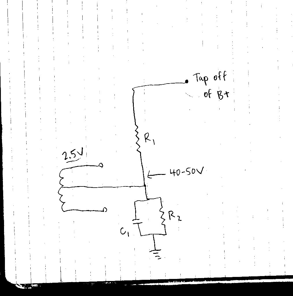

I'd recommend separate filament windings for 45 with cathode bias, but if you are using fixed bias a shared winding is just fine except for the inconvenience involved in measuring plate currents. In this case the I think the cathode bias on the winding is helping to keep the 27 cathode to filament interface from misbehaving - much higher voltages though may cause the cathode to filament insulation to fail in these tubes - I learned this the hard way..
Normally I'd recommend the 27 filaments be biased about 20 - 25V above the cathode, but not substantially more than this. Using the output stage cathode bias to do this is probably ok as the voltage differential is still less than 40 - 50V which is where I experienced problems, and as long as the cathode bypass cap is a good one hopefully there will be no significant coupling through the 27 filament capacitance.
Heck, it works, and sounds good, all refinements can follow from a working prototype.. 😀
Thanks for the heads up on the 27 cathode-filament interface. This will be my first time working with the 27. That sounds like some good information to know.
Something like this:? (note: meant to write as 20-25V instead of 40-50V)

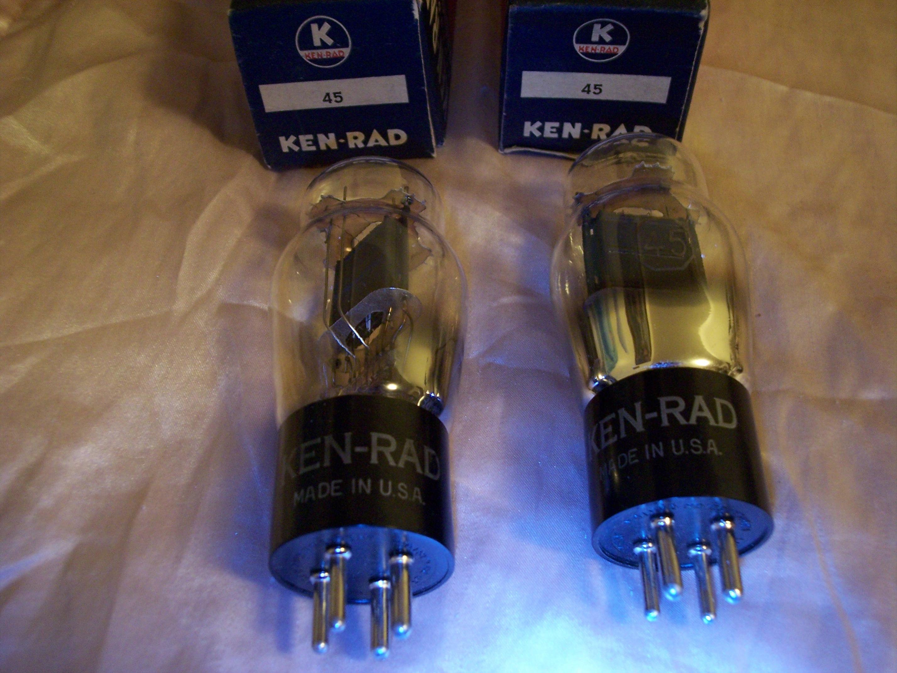

The majestic globe 27's w/mesh plate's for the input and Kenrad 45's are my current favs. I only have two pair of 45's, The kenrads and a pair of raytheons.
Cheers, mike
Other's may sound better to your ears, and at varying operating points.

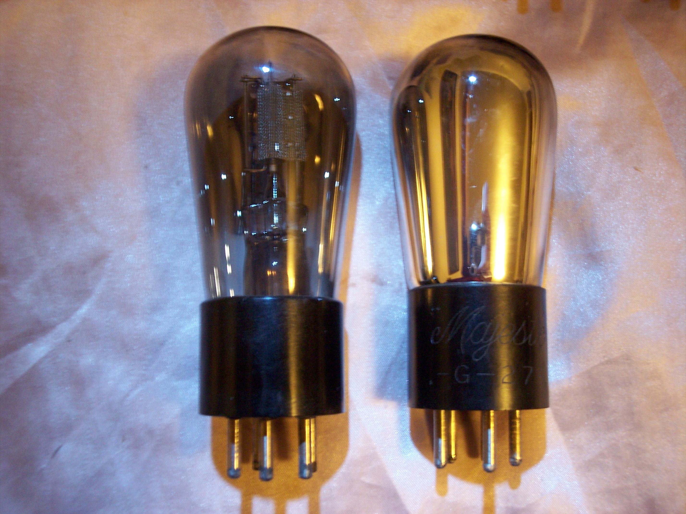

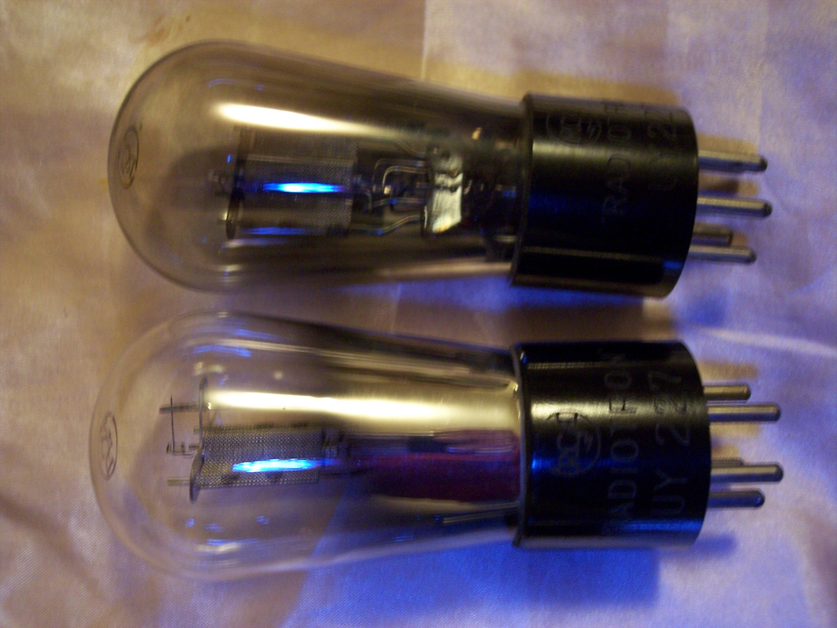

Just a sample of tubes I have rolled into this experiment... 😛
These are matched pairs (quite close)..😉

One caveat about mesh 27s. I tested many on a curve tracer and found that a lot of them have very irregular plate curves. Often the electrodes are misaligned which causes this. The ST shape 27s I measured all had very linear curves.
