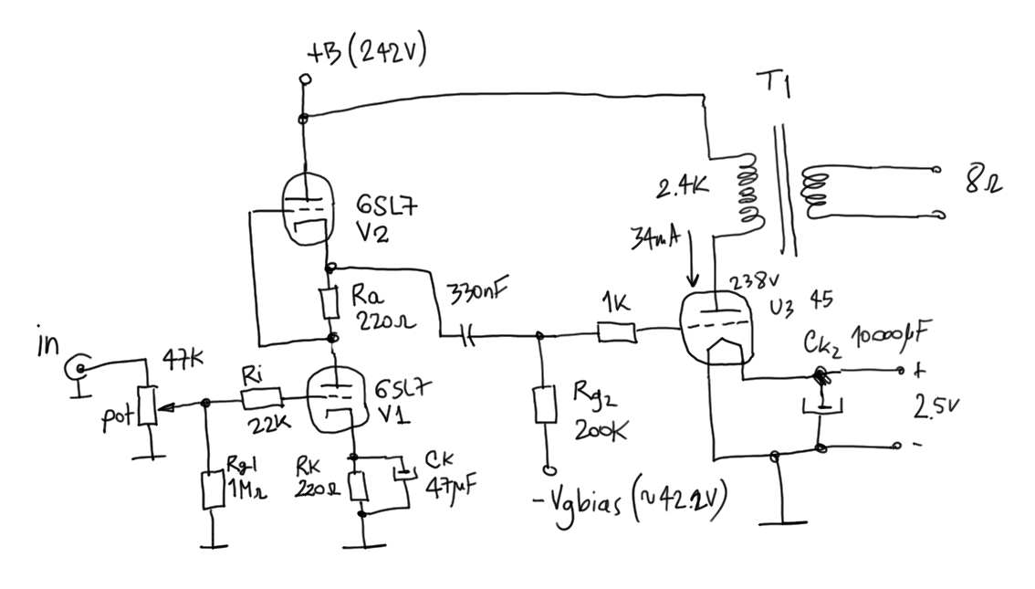

6SL7 driver for 45 SET
Hi everyone,
I'm planning to build a 45 SET intended to drive my GRADO headphones or alternatively small speakers with power being less than 1W. I've played with tubecad and managed to arrive at the attached design.
Driver circuit is 6SL7 in SRPP with a gain of 37 (31dB) approx. The 45 output valve is operated at 34mA and a bias of -42.2V and plate of 238V. This yields less than 1% of THD when 200mW are delivered and grid peak to peak is 15V. It can also deliver roughly 800mW when driver grid gets to 30Vpp. THD is slightly over 4% then.
Any suggestions for improvements?
I think I need to elevate the heater supply of V2, which would be a pain in the back. Is this really needed? Do I need separate 6.3V supplies to elevate only V2 heater circuit?
Thanks for the help!
Ale

Driver actually isn't SRPP as connected, but mediocre current source loaded common cathode stage.. I think the cathode bias resistors in your SRPP are rather low in value, and I've found the 6SL7 to work best at currents of 2mA or less.. I'd recommend 820 - 1K resistors instead and I'd use it as an SRPP... The cathode bypass cap is a bit on the small side. A red led for bias on the bottom tube cathode and a 1K resistor in the top might make an interesting experiment.. (Section to section match could be an issue, and voltage will not divide evenly between the upper and lower sections of the SRPP - whether or not this is an issue depends on how extreme the imbalance is.)
Elevating the filament supply is really easy, it just takes 2 resistors and a cap and can be fed by your B+.. I would aim for more like 250V B+ and note that you can easily get 2Wrms out of this design with a 5K transformer, and that generally will translate into even better linearity at low levels than your current design. (4% thd at 2W is attainable with this tube.)
I strongly favor fixed bias and your OP is in the right range..
Hi Kevin,
Thanks for the feedback. I actually made a mistake at drawing the circuit. It's a symmetrical SRPP. See ammended circuit attached.
I will rework the design to get 2ma and 1K resistors as per your suggestions. May also increase cathode cap....
Will also move B +250V and see what simulations I can get with a primary winding of 5K. Actually the transformer I have has 2.4K and 5K primary windings 🙂
Question, if I elevate heater supply for the v2, am I not doing the same for V1? Shouldn't I have two separate 6.3v heater supplies to avoid this?
Thanks for the help.
ale
Split the difference in voltage at the cathode, and elevate the heater to that point. Noise reduction is almost as good with the heater below the potential of the cathode as it is above it.

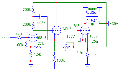

On another note, here's another design you might want to consider. It uses the same tubes but with direct connection and some very clever noise cancelling, even with small supply caps. I made an 801 amp that I use for headphones (AKG 701). It's very quiet and sounds great. Here's the thread: http://www.diyaudio.com/forums/tubes-valves/125488-loftin-white-801-amp.html
I made up several other schemas for other tubes. Here's one for a 2A3. Just change the cathode resistor for the 45 and you're good to go. The resistors for the noise nulling circuit might need some adjustment. If you are interested, I'll recalculate.
Sheldon
Hi Ale,
I think your circuit is unnecessarily complex. I don't see any advantage of the SRPP. It only brings problems with kathode-heater voltage differences and the need to elevate heaters. I played around with SRPP and mu followers a long time ago but dismissed them. I prefer transformercoupling, or if on a budget plain RC coupling.
I have mentioned in another thread that I think the 6SL7 is not well suited as a driver. if you insist on it, parallel both sections and run it RC coupled. Better choice is trhe 6N7 as mentioned by me earlier in this thread.
If you have the possibility for higher B+, use cathode bias on the 45. Way simpled than fixed bias.
Other points:
Why the huge grid stop resistor on the 6SL7? I've never experienced oscillations with the 6SL7, no grid resistor needed at all. Also the 45 will run fine without the grid stop resistor.
Best regards
Thomas

Hi again,
another point:
use a OPT with higher output impedance. 5k fits much better to the 45
Thomas
