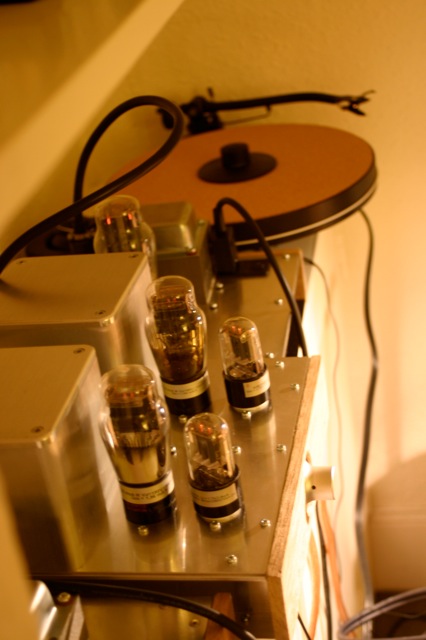

I ended up with three chassis as I ran out of space on the HT chassis
HT chassis has also the bias supply and 8 core cable to the main chassis.
LT supply chassis is housing two e-core trannies for the 45s and one toroidal trannie I had at hand for the driver filament supply. On this chassis I have three raw supply boards and another multipole connector with 4 core cable from this chassis to the main one.
Ale

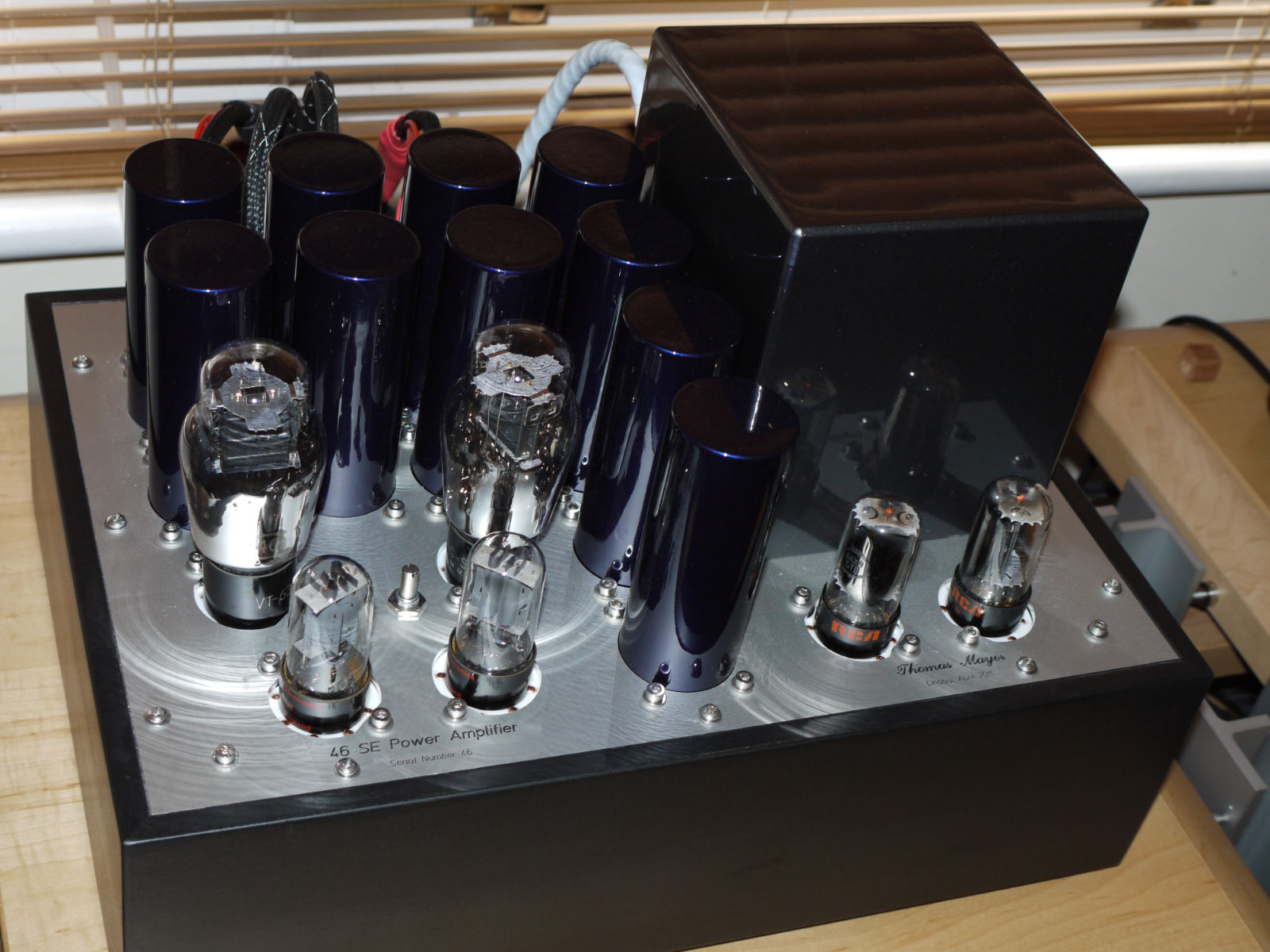

At last, it's alive!
Hi everyone,
Finally and after a long 9 month period of weekend work, my 45 SET amplifier has been completed. It sounds brilliant, albeit it has a bit of too much gain when I use my turntable with a preamp.
Thanks everyone who helped me on this journey (Kevin Maier, Thomas, Rod Coleman, Andy Evans amongst others). I managed to learn a lot and still have much more to learn and experience.
This is just fascinating, what else can I say....nothing better than turning on the amplifier and playing one of your favourite LPs. (I did play five years from David Bowie).
A special thank will go to my dad who inspired me all the way and helped me with some building tips and coincidentally yesterday was exactly 3 months since he passed away. I know that he was enjoying this moment with me yesterday when I put the record on and pour a proper glass of single malt to celebrate....

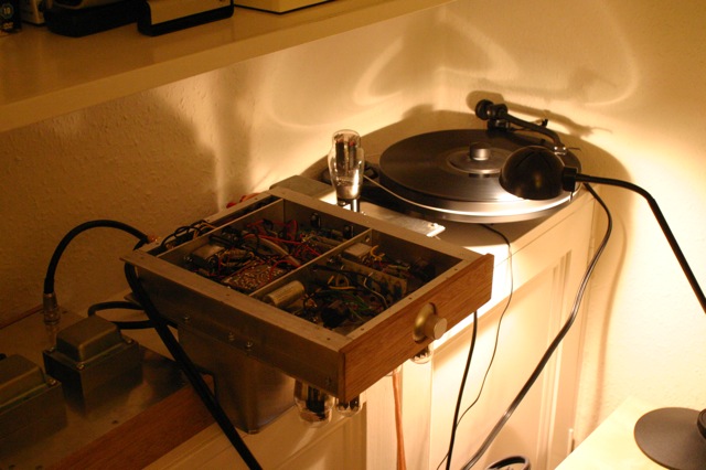

Here are some additional pictures:
Hi-Fi photos

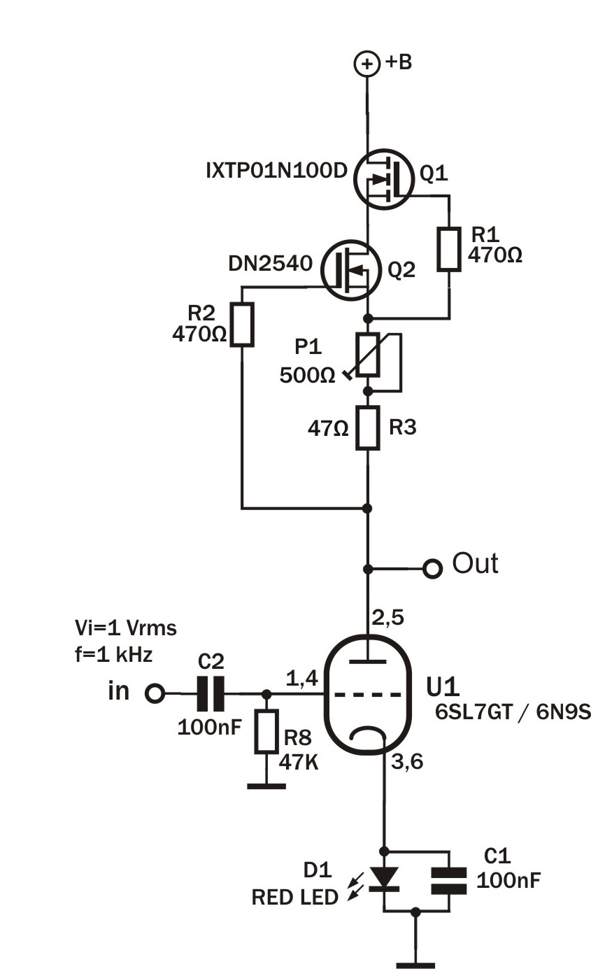

Well, still trying to get the best out of the current driver with the paralleled 6SL7 triodes and CCS load. Today I tried the following configurations in order to minimise the stage distortion at maximum drive voltage i.e. 100Vpp. I restricted my test to triodes I had at hand, octal base and 6.3V heaters as I'm not willing to start changing my amp too much. These were the best results so far:
VALVE
6J5GT Brimar @ Ia=15mA/Vg=-3.8V THD=0.46%
6SN7GT Brimar blackened @ Ia=20.5mA/Vg=-7.6V THD=0.32%
Then I tested 16 valves 6SL7/6N9S and achieved the lowest distortion at the following operating point:
Ia=4.5-5mA / Vg=-1.8V, Va=251V
6SL7GT/VT-229 Sylvania THD=0.37%
6SL7GT Brimar (black base) THD=0.42%
6N9S Russian THD=0.43%
The above distortion level of around 0.40% is at full drive of the 6SL7 to achieve the voltage swing I need on my 45 output stage. Distortion is significantly lower at lower signal levels of course. However, in order to optimise the stage, I measured all at the same output level so had to adjust input signal as valves had different mu.
Clearly going for a pair of blackened 6SN7GT will be the best option, but my current CCS board doesn't allow me to include a heatsink for the top mosfet. May need to change the board. But, for a minimum difference I will select a nice pair of 6SL7/6N9S and bias them at 251V anode voltage and Vg=-1.8V using the RED LED bypassed with a russian 100nF PIO capacitor that I have at hand...
Learnt the lesson, if I compare these results with the distortion figures of the CCS loaded 4P1L, CX112, 30 and specially 26 valves that I did earlier, next time I may go for two stages of DHT driver (or one being the preamp) instead of the current setup....

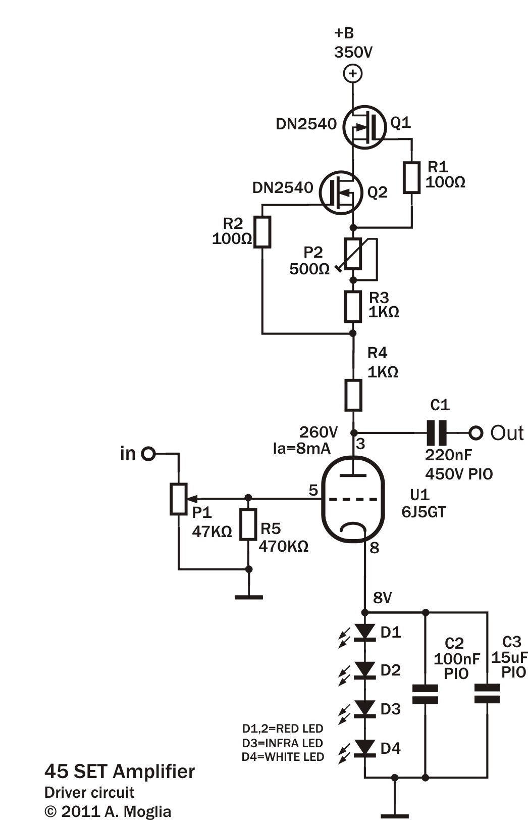

At last!
Today I managed to replace the 6SL7 driver with 6J5. The latter has a similar heater requirement, so worth giving it a try given my current constrains. Have to say that sounds superb. Managed to listen to vinyls properly now with a reasonable gain that doesn't clip the amp. Played "Take Five!" from Brubeck Quartet. My special part is the drums solo, where you can appreciate properly dynamic response and bass as well. This amp surprise me so much, can't believe there is no trace of hum at the output even with listening with my grados. Evidently this amp marries very well with my Fostex 167E full-range drivers. Better bass than my previous EL34 PP.
As I said before, can't believe what a 2W can deliver.
Had an interesting situation when I tried a different pair of 45. I found some random noise with no signal at the output. Apparently one of the two tubes are not working properly. Will trace the curves to see which one is :-(
So final test of my Sylvania JAN-CHS-6J5GT metal base was:
Vo THD
25Vpp 0.11%
50Vpp 0.22%
100Vpp 0.51%
Played with a combination of different LEDs to get the 8V bias required. Anode voltage around 260V achieved lowest THD at maximum headroom (100Vpp) and CCS current set to 7.8-8mA. Gain stage is now around 18-20 depending the tube.
Vo THD
25Vpp 0.11%
50Vpp 0.22%
100Vpp 0.51%

Just browsing through the threads and the limited output of the 45 struck a bit of a chord, as did the exchange with Thomas.
Agree 100% with
"My special part is the drums solo, where you can appreciate properly dynamic response and bass as well. This amp surprise me so much, can't believe there is no trace of hum at the output even with listening with my grados. Evidently this amp marries very well with my Fostex 167E full-range drivers. Better bass than my previous EL34 PP.
As I said before, can't believe what a 2W can deliver."
Its exactly the same with the 46SE I acquired just over a year ago...sublime for 1.5 Watts
Agree 100% with
