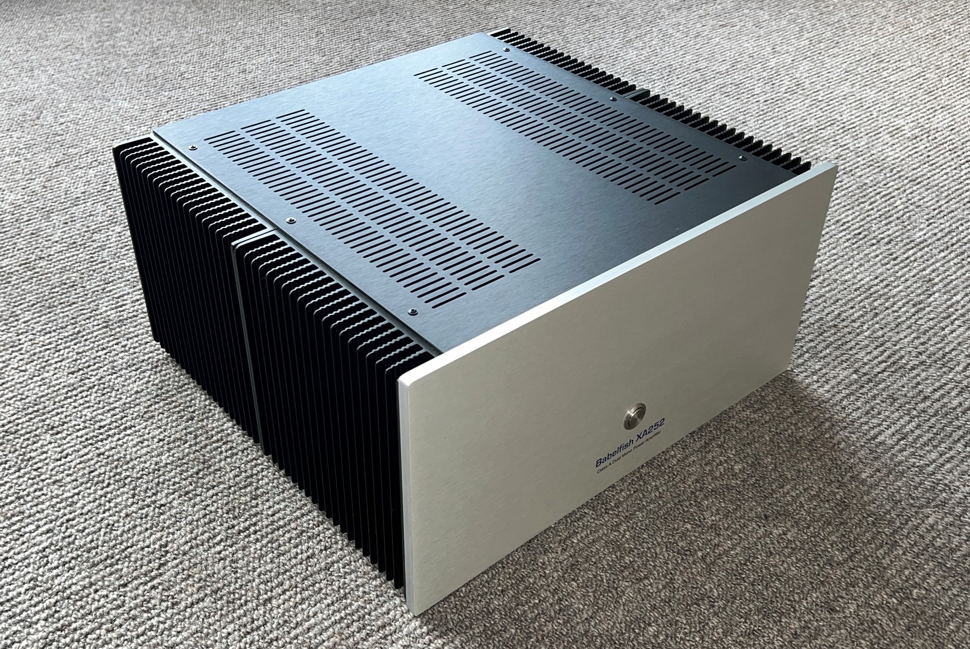

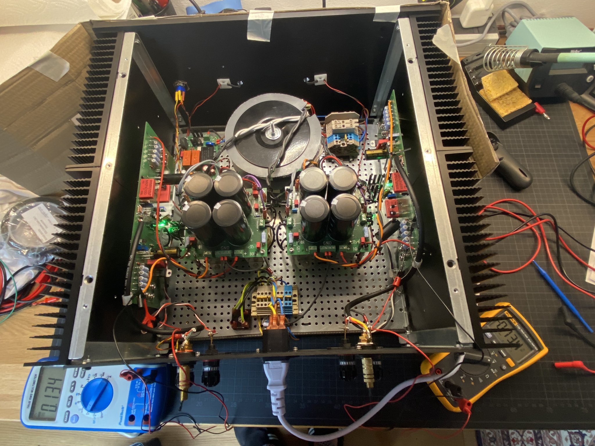

After a short time out, finally back at getting this built. Right now cooking in slowly but surely. Pretty much the same for both channels:
Iq= 1.4A (will go high depending on heatsink temp)
Voffset= <±0.2mV (what is not to like)
Heatsink Temp = ~52°C
BD139/BD140 Temp > 57°c (and this after changing out the original heatsinks with two bigger ones.)
Still getting a tiny bit of Iq upward creep.
Will make some more measurements later and then try it out on my test speakers.
Thanks to ZM for all he does around here. We need to find a way to reward him!
Reactions: 3 users
Joined 2008
Nice looking build!
It appears you have the dreaded bowing backplate. Some chassis do that, some don’t. :magnify: If it’s not just a camera angle anomaly, I’d suggest placing some washers in there between the bracket and the back plate to relieve the pressure and square it up.
