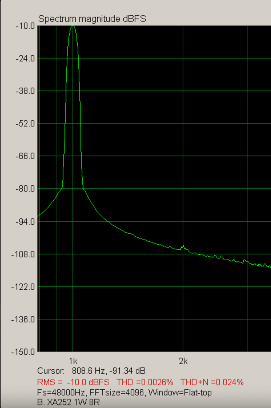

I wanted to cook it for a while before I connect it to my speakers. Will try also to take rough measures of THD and FFT.

feel free to ignore ZM's THD+N figures, look only at sole THD
as I wrote several times - my T-Beds are deliberately left with subpar wiring and they're certainly having much worse PSU figures than anyone is going to make it in final
wires - too long and too thin - one can't have both versatility and optimization
which is evident every time when I include left of 1KHz in graph picture - horror
