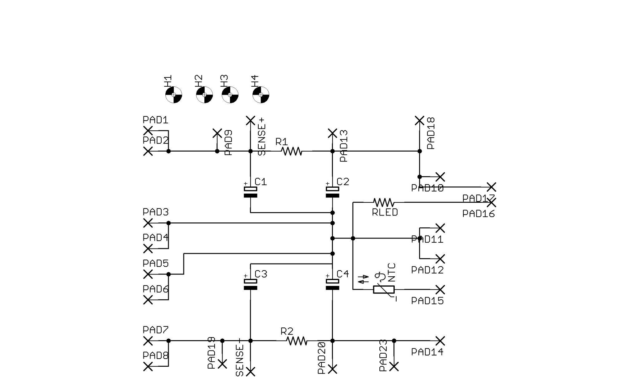

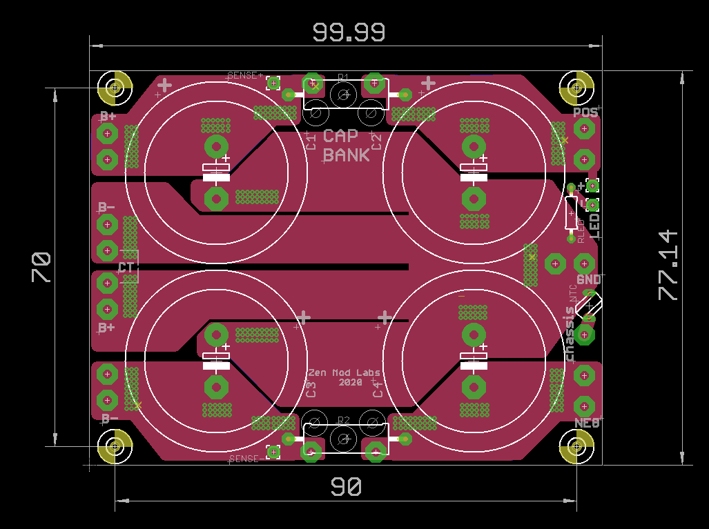

Do the two sides need to be wired together,
clarify
and what if any value of resistor be used for power supply bleed off
I'm not using bleeders in my amps at all; they can save you if you're testing Cap Banks prior to wiring to amp pcbs but - I'm never doing that and even if I'm in situation of messing around (as with my T-Bed), I'm not forgetting to blast them with dummy load leads
feel free to use/mount them, improvise how; 10mA through bleeder is good enough so - 3K3 , dissipation is 10mA^2*35V; take at least twice more for declared resistor power
on First Watt clones I usually do this through a CL 60..
there is a footprint for 10-12mm Dia NTC on Cap Bank pcb itself -- why not using that, if I already put it there
![clown :clown: :clown:](https://files.diyaudio.com/forums/images/smilies/clown.gif)
if you really want Kosher - take adequate wire from output GND on Cap Bank pcb to [KBPC bridge +capacitor+resistor] ground-lift-thingie
there is a footprint for 10-12mm Dia NTC on Cap Bank pcb itself -- why not using that, if I already put it there ![clown :clown: :clown:](https://files.diyaudio.com/forums/images/smilies/clown.gif)
Exactly why I asked. knowing these were for multiple projects, I didnt know if that was for my intended purpose or something else. So CL 60 on board, ground wire from "G" to chassis. Or is some other size NTC used? I have a bunch of CL 60...

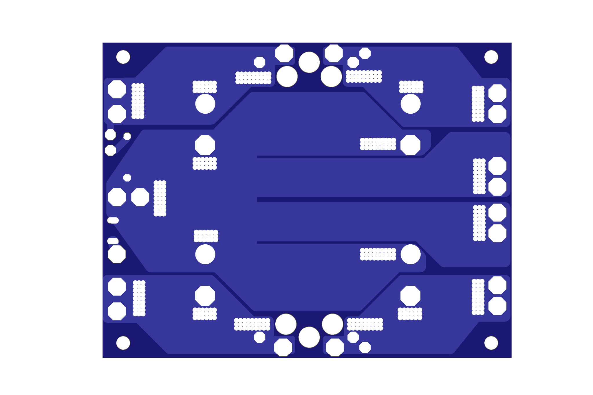

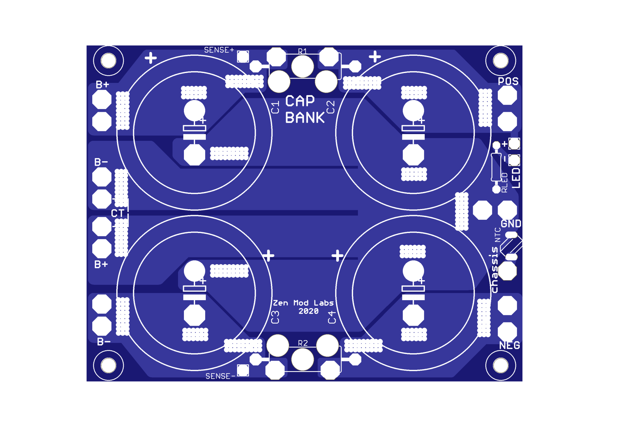

On a number of PS boards on bottom grounds were tied together, just wondering here...
all you can and need to see
both schm and pcb pics - left side input from bridges, right side output to amp pcb

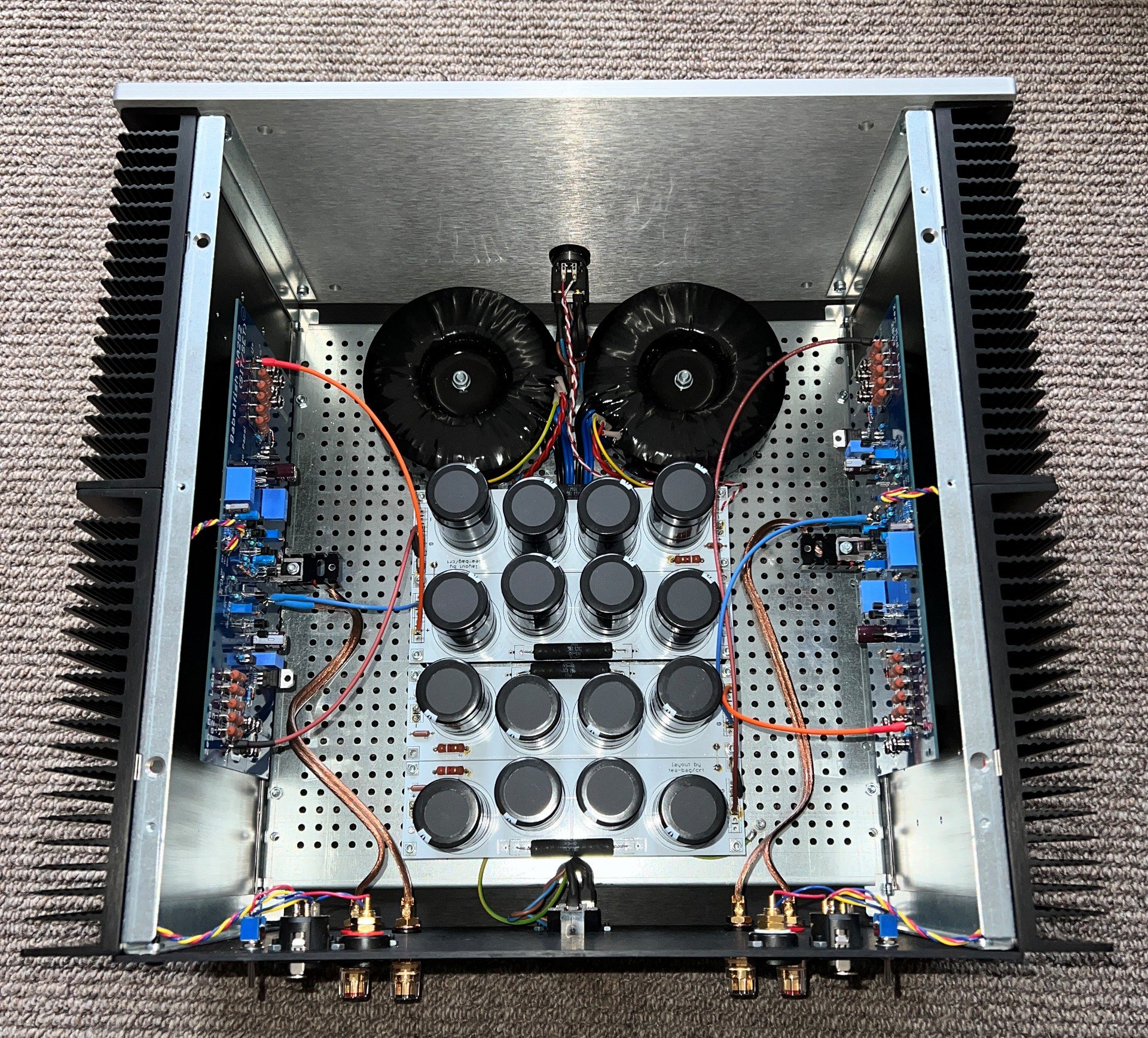

Powered on for the first time today - everything stable, offset a few mVs. Increased Iq to about 1.54A (0.170V/.11) on both channels, after 10-20 minutes of cooking the amp is blowing 1.25A/250V fuse (one for both donuts). Just ordered bigger fuses...

Ok, with a bigger fuse cooking continues...
My latest measures: Iq increased to about 1.64A, offset below +/-1mV, rails +/-37V, heatsinks near big MOSFETs are about 50-55 deg. C, small heatsinks for Q1/Q2 (BD139/BD140) are quite hot as well, about 50 deg. C. Ambient temp about 18-19 deg. C.
