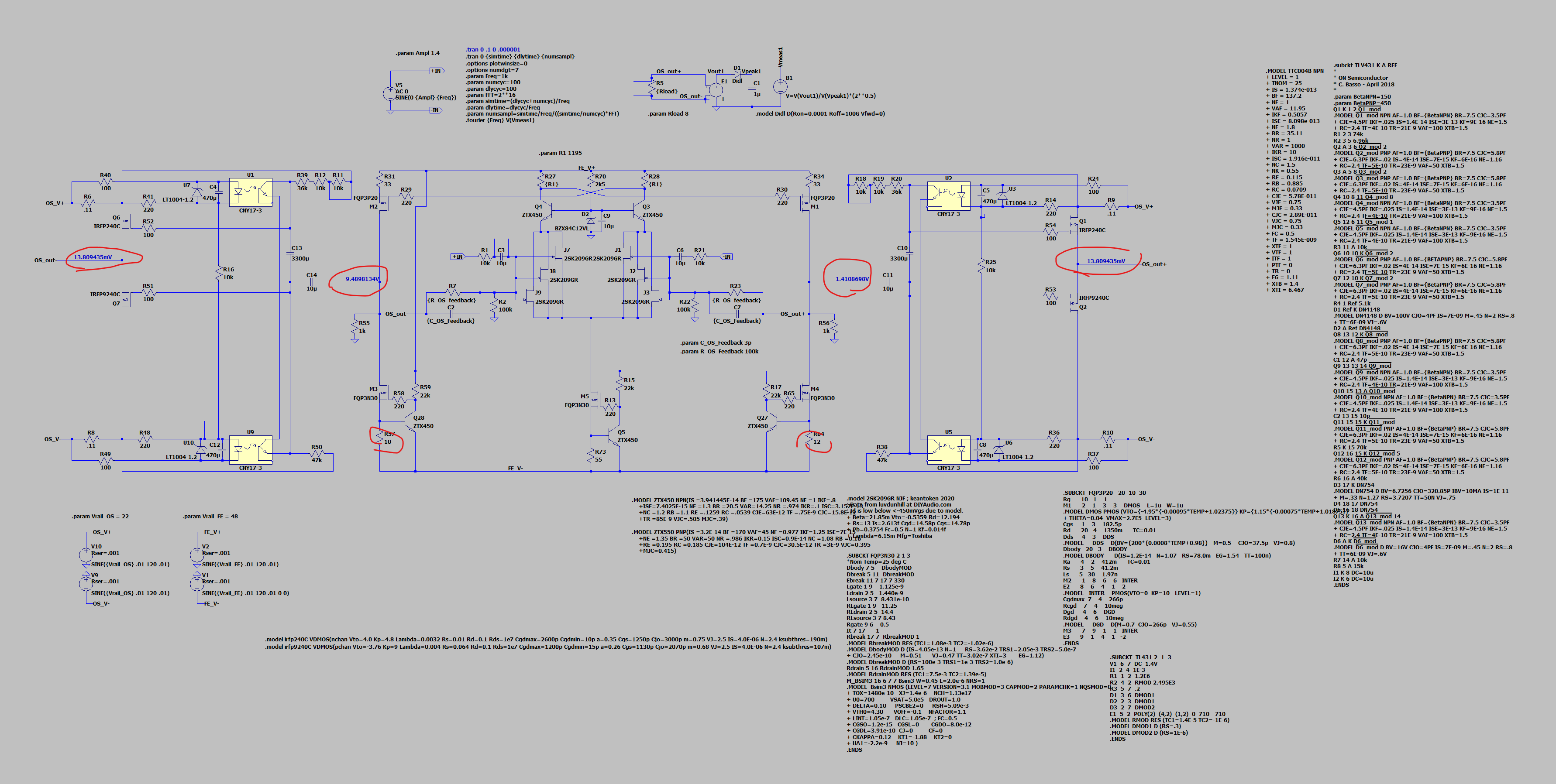

relative DC offset - need to check, servo if needed

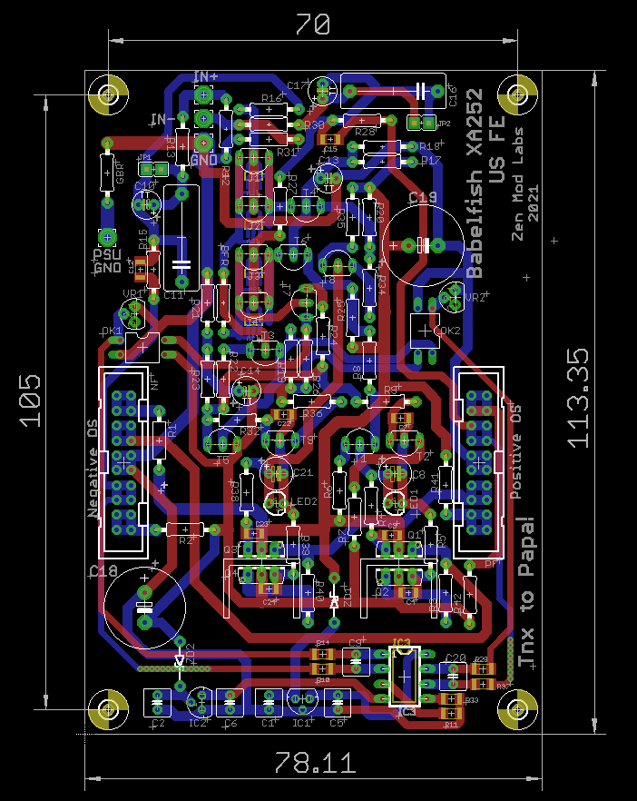

Because the output stage is not DC coupled, wouldn't it avoid a lot of the problems with offset that the Aleph-X had? Even if the DC operating point of the driver stage is off, the output should be as DC-stable as it would be in single-ended operation.
I've been playing around with something similar, and have found the relative offsets to be much better behaved in the face of even gross asymmetry.
Of course, high absolute offsets in the driver/VAS will still cause problems if you run out of voltage headroom and clip asymmetrically, but that's just another reason to boost the supply rails for the front end.
|I've made simple solution for Aleph X creeping offset, which is published here :Babelfish XJ , or JX …….. or whatever (Aleph X servo for Greedy Boyz)
as I wrote there, I'm pretty sure that I did saw simmple LTP solution somewhere in Papa's papers, but was never able to find it again ; anyway, from wherever it got originally, it works as intended
regarding this amp, SUSY-fied - I'm pretty sure that OS is DC coupled to FE
even FE neg leg input can be or not DC coupled, as matter of choice - in case of thump being higher than you like and to solve potential issue with higher initial ofset, in case when BFR is chosen in higher value
I've put input cap primarily because I have that issue in prototype and I wasn't sure of behavior once when pcb is made, so I did include cap and jumper; when made on pcb, it shows that majority of issue was Ikebana prototype style induced and now, I can use it with or without jumper, even with my RCA speaks, being microphone-like sensitive and soft

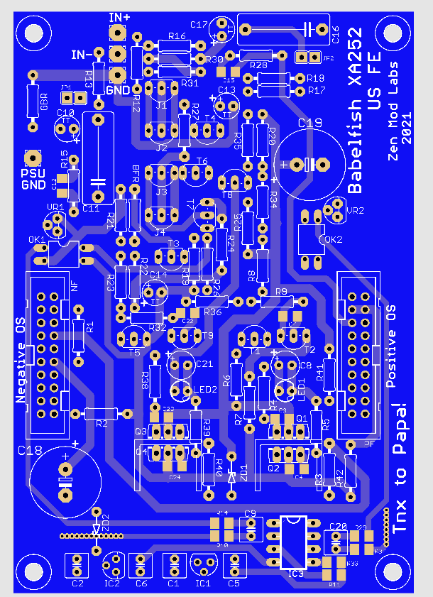

My mistake - I missed R32/R33.

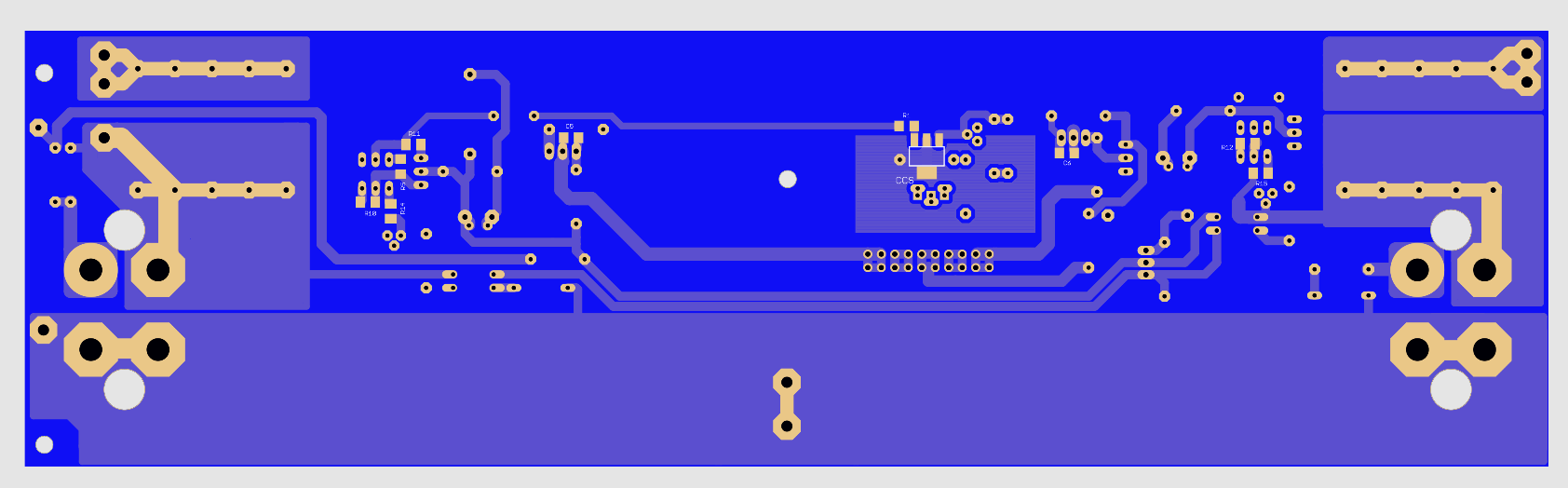

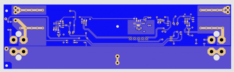

Can't wait for them (PCBs) 🙂. Definitely my next try when available. Can amplifier be bridged and what power can i expect on 8 ohm load?
And thank you for all your efforts.

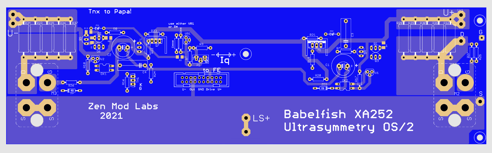

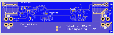

back'o'napkin fun sez that Ultrasymmetry (fancy name for deliberately and controlled ruined SUSY) is possible; yes, with 2nd dominant, neg phase of same
who needs amp heating your room with 2x 200W, for 2x 160-170W@8R ?
that means serious hardware ....... per channel:
-say 5U/500 Modushop case
-say minimum 600VA Donut of niiice quality; even more if one is fancy welding lower impedance loads (prediction of power at lower loads is better to avoid without actual tests)
-say minimum 120mF per rail, so 240mF

all 3 iterations made in digital realm, with proper servo for relative offset
