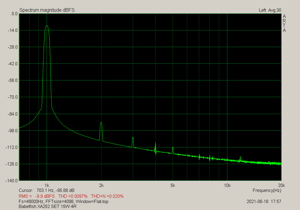

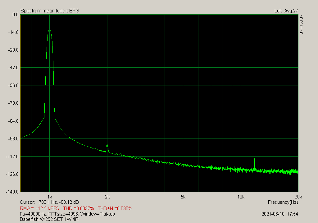

Babelfish XA252 SET - graphs , 4R load, BFR=22R
post 1 of 2
plenty of graphs
everything the same, load changed to 4R
post 1 of 2
plenty of graphs

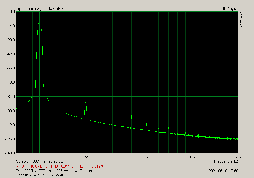

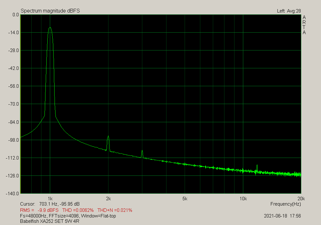

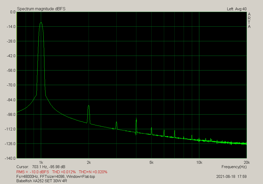

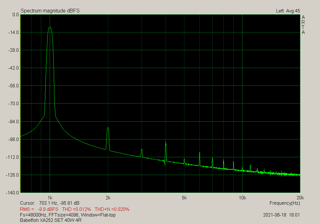

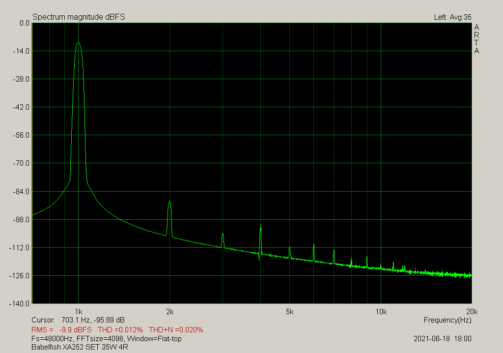

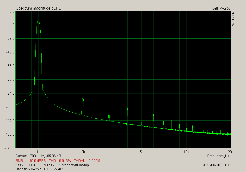

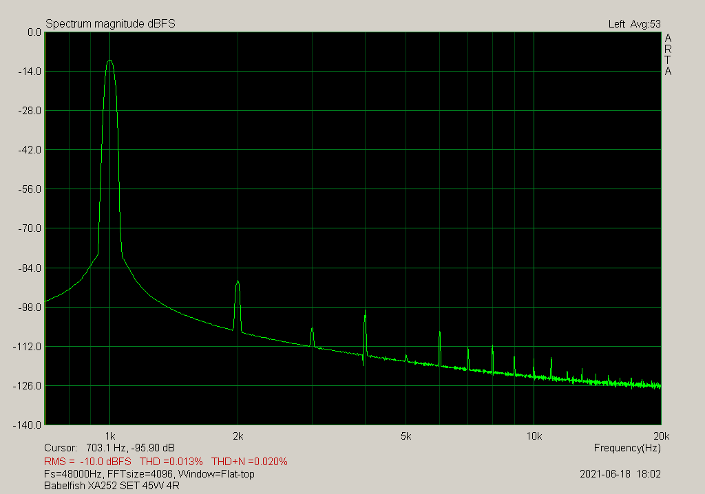

OK, I've compared graphs
B. XA252 waaaaay down in THD at all power levels, so no real comparison, except same THD Spectra nature (that is more "except")
then, THD levels comparison between B. XA252 SET and B. XA252 SIT clearly shows that SET is uniformly approx. 6db down at each tested power level
in my book, that's pretty good emulation - achieving same behavior and consistency, while still making some desired difference ...... even ignoring that we are emulating nearly 100$ part (plus not so easy to obtain) with 25$ part
edit: for SET - did I said that even famous ∀ Class DEF current distribution is clearly evident - Schade SIT emulation is working as proper SIT in DEF - I like to see it as SIT being error corrector for Mosfet

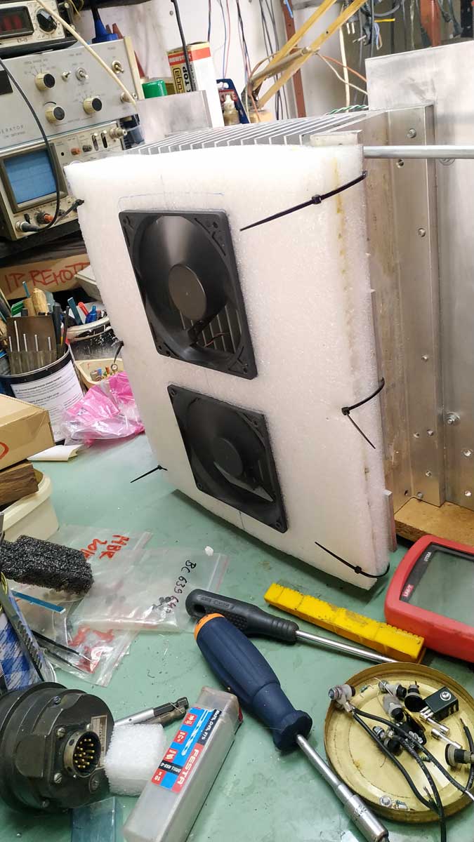

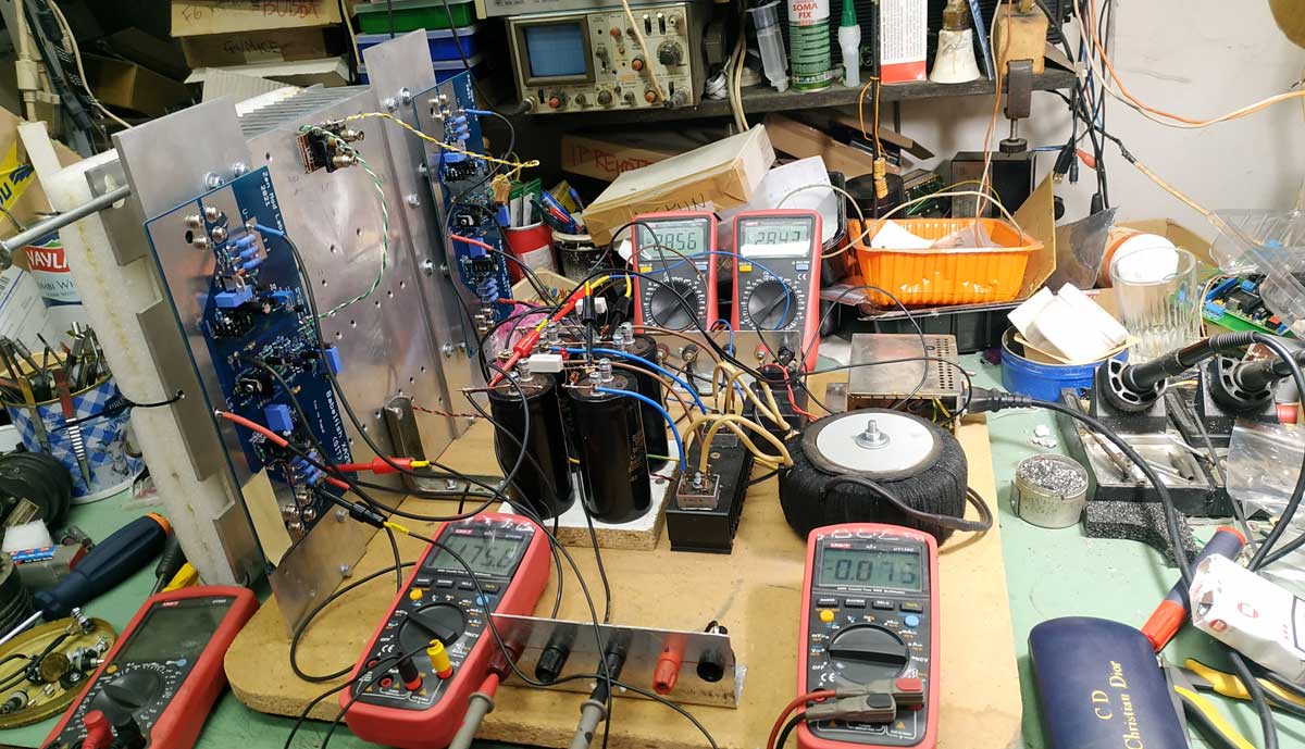

spent few lazy hours in Workshop today, while waiting funny bunch, gathering for Sunday Lunch at Ma's
what best as Intro than some funny music, served by SET
well, it seems I'm getting soft ..... by palms, I was concerned, while meter did show measly 54C at Biguns bodies/tabs
it's getting hot in Serbia - I know when is that - when sitting in Workshop and suddenly going blind ...... means even my spectacles are becoming wet
so, AC time is here
so, AC time is here
