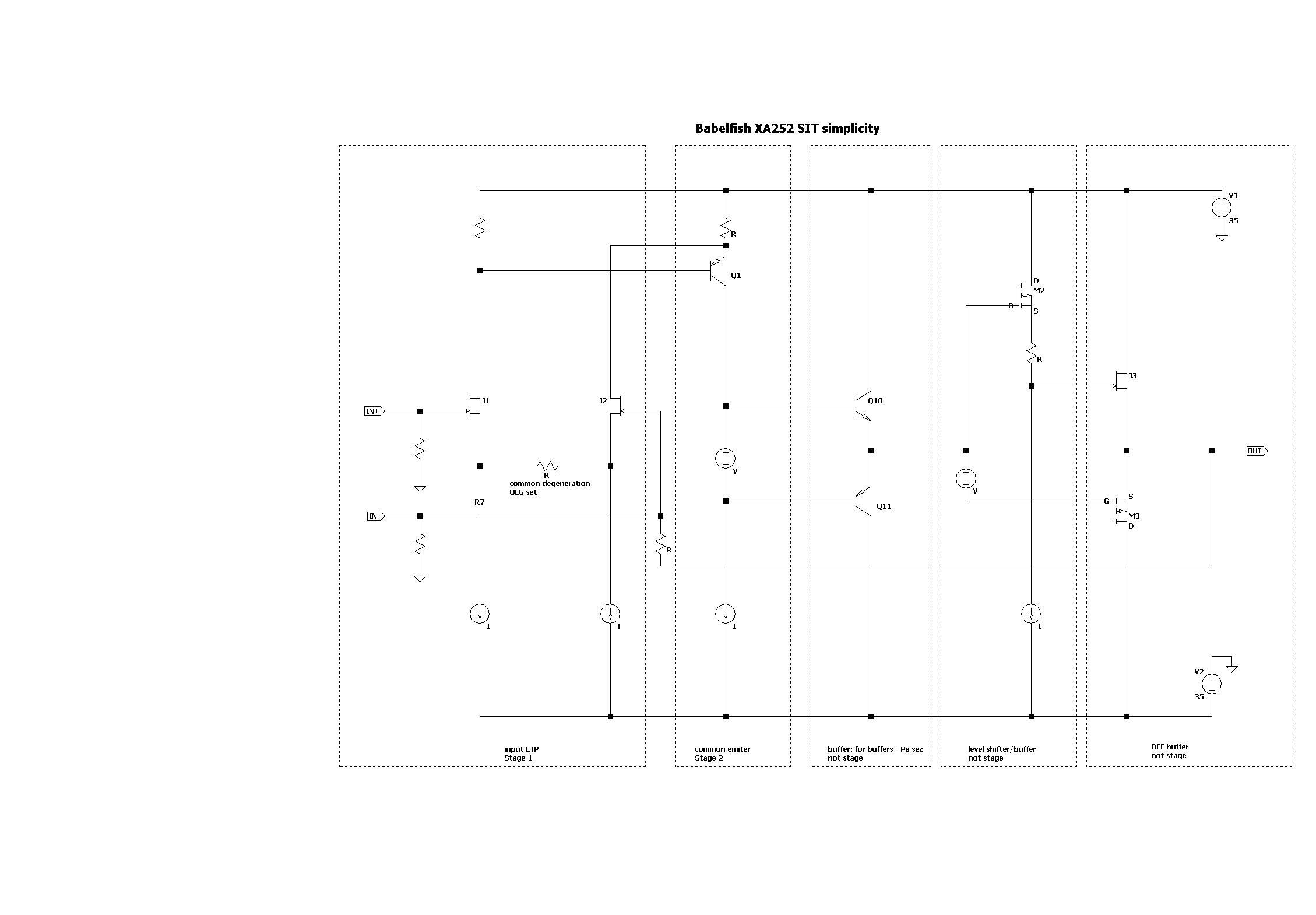

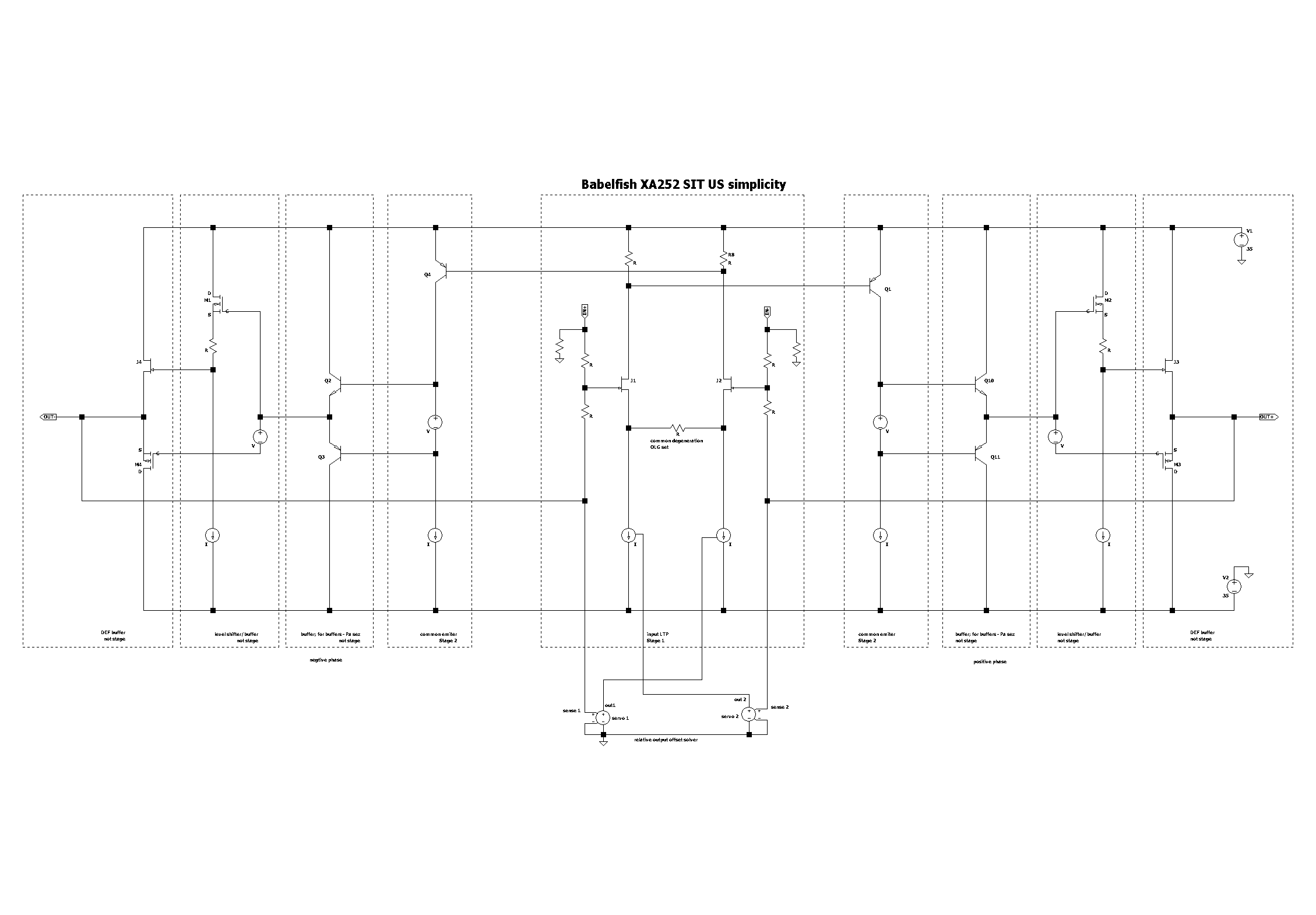

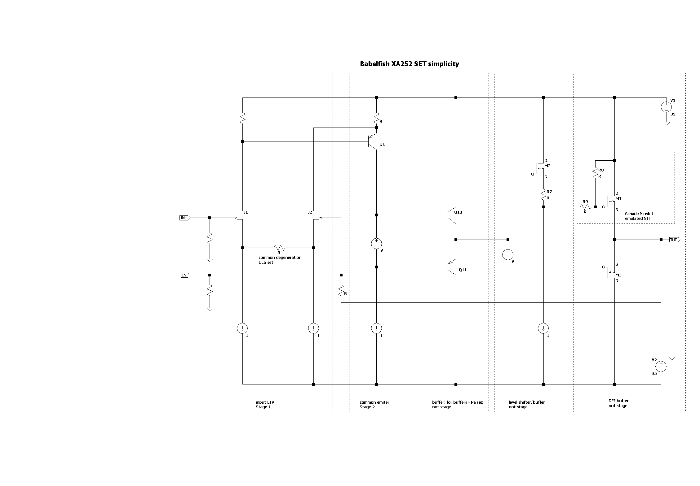

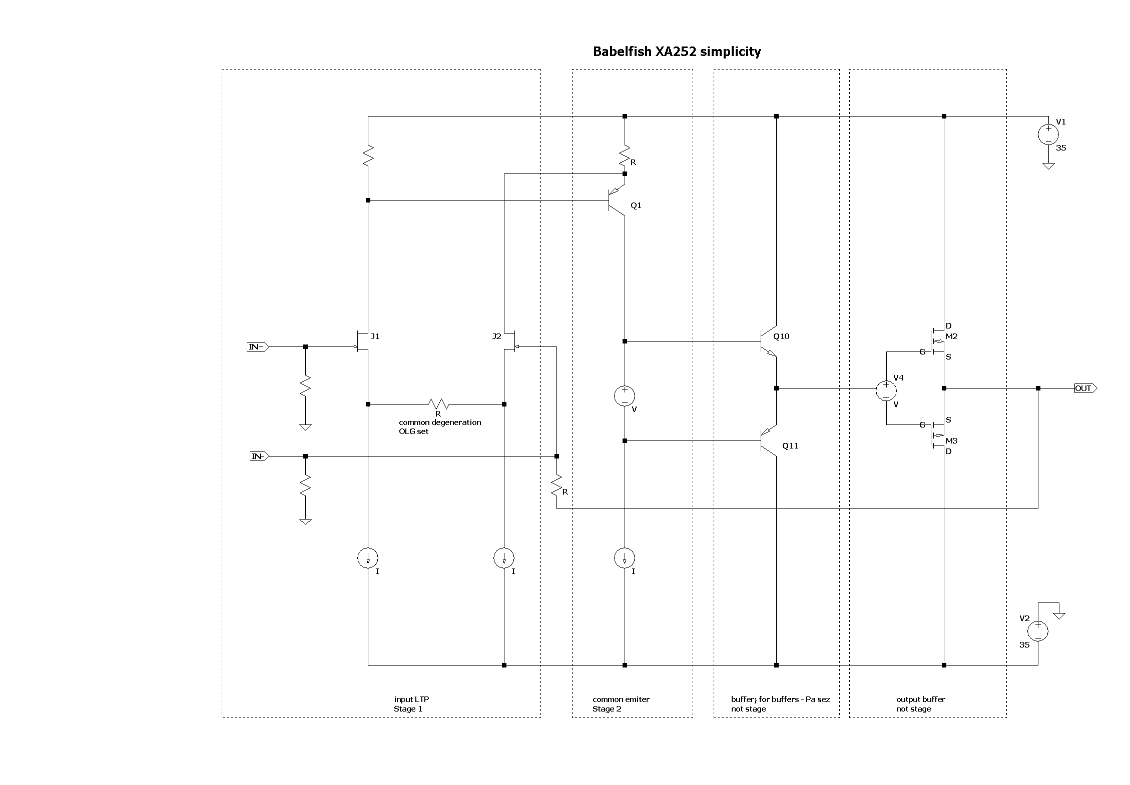

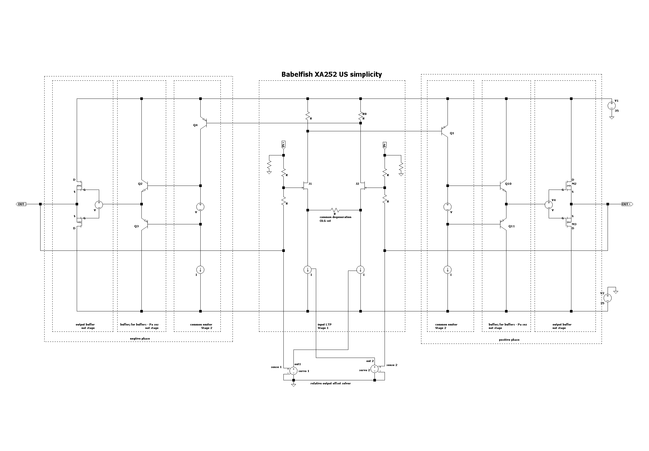

so, few funny pics, just to show that things are often simpler than they looks
simplified schmtcs of one already made and of hypothetical one, that one called Wabbit, for now
of course- ignore parts numbering (if shown) - it's irrelevant

Few more, before sleep
After thorough examination, ZM's 'Rithmetic sez - these amps are simply not having stages at all
I devised Stageless amps!

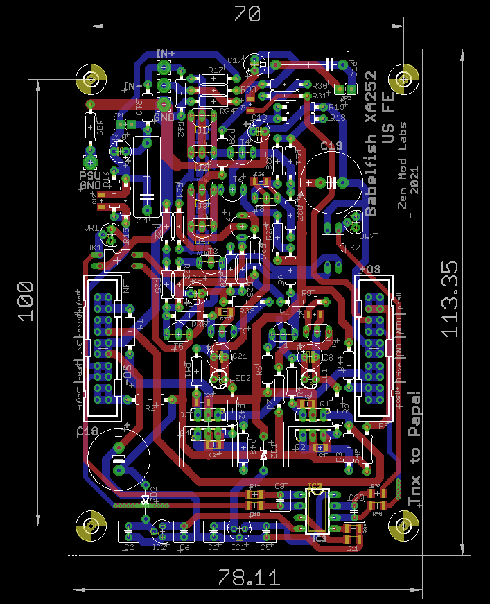

I did order FE pcbs today , for "Winter is coming" amp
now, just to see whom I'm going to kill/rob, to buy 4N and 4P pucks
in fact, I'm good - having 2+2, still on T-Bed 2, so I'm going one day to try/measure/tweak just one channel
I mean - either that, All the Glory...... or Public Disgrace, again
