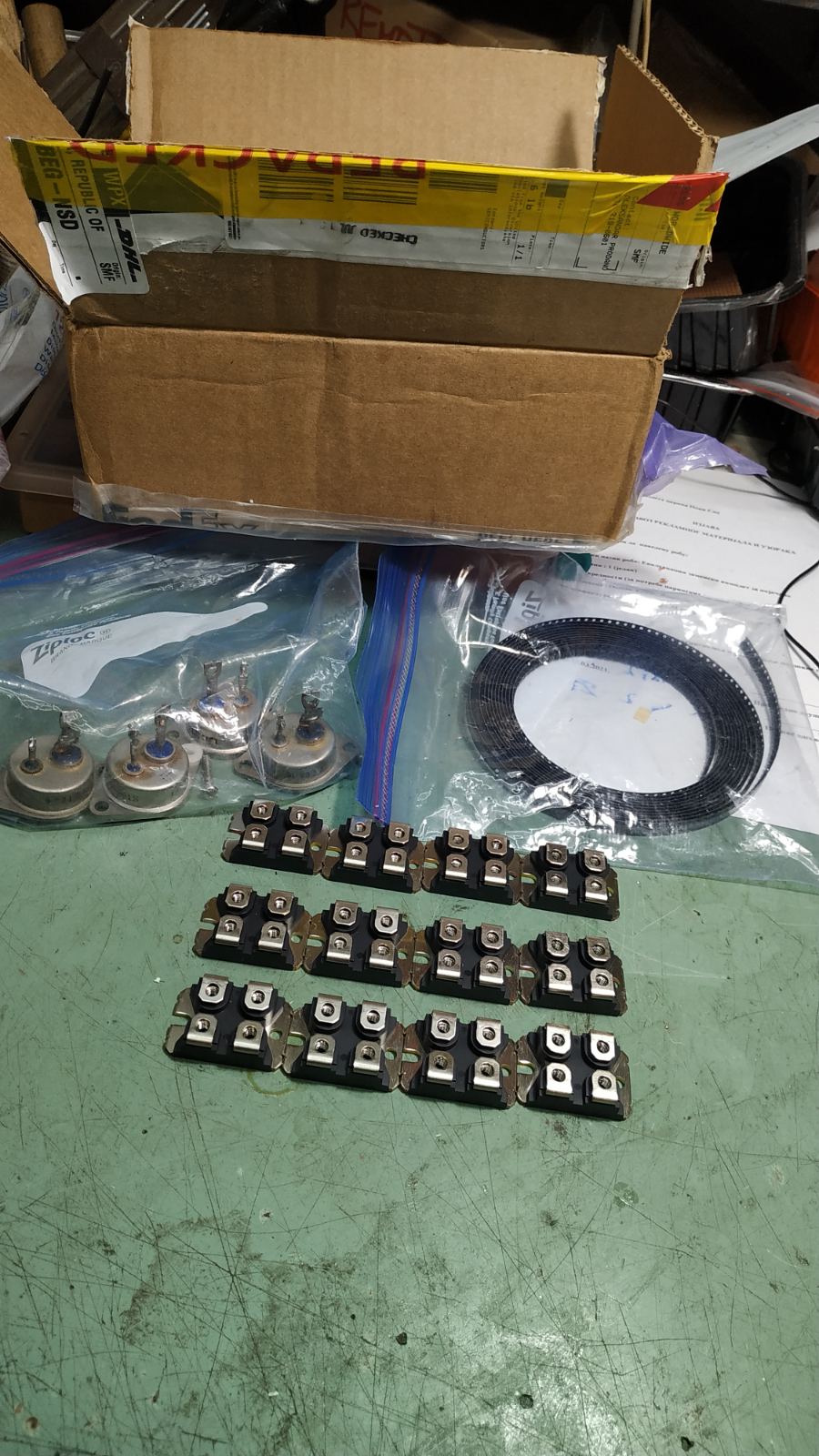

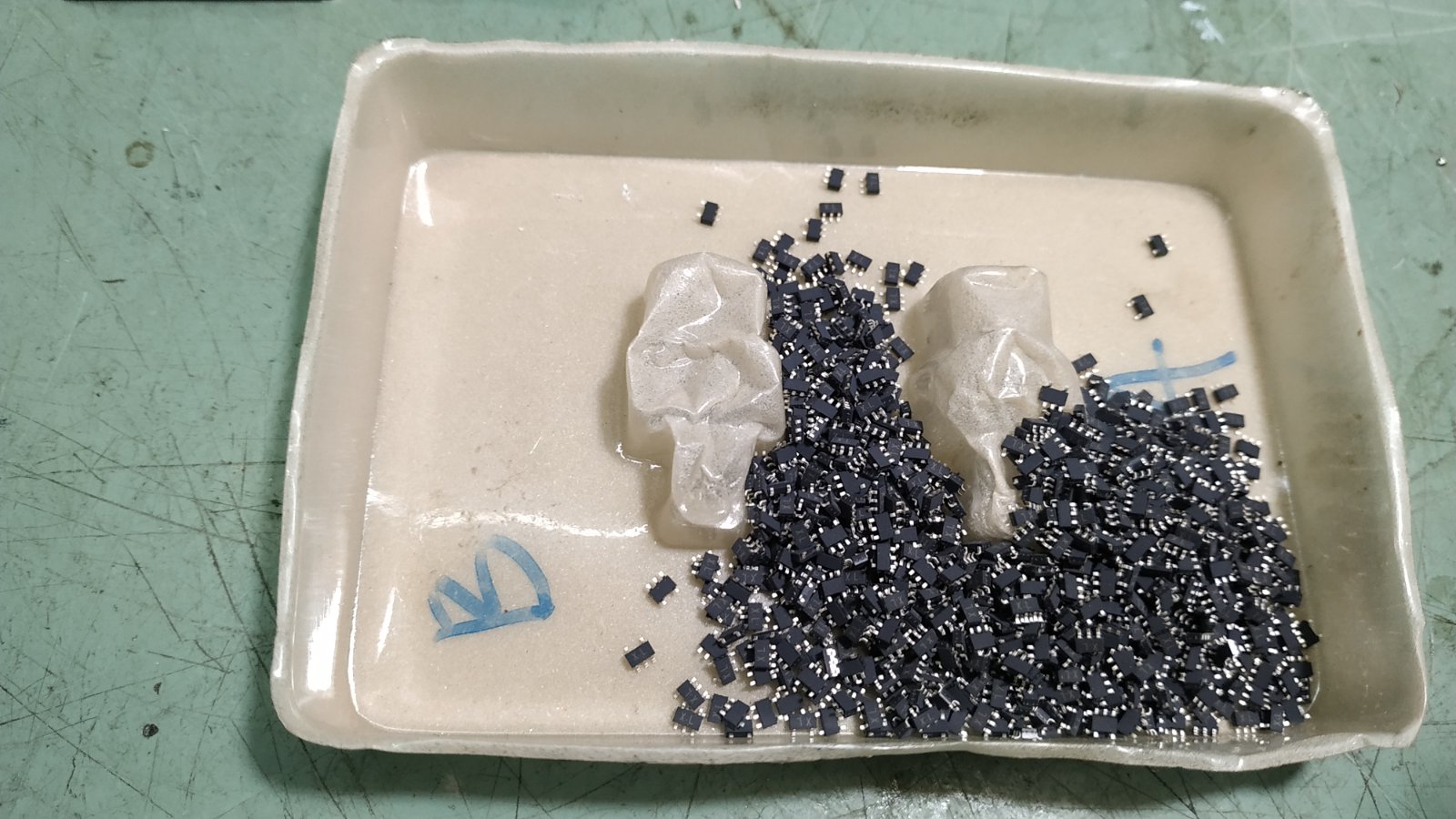

not only he sent those Biguns, he also helped me getting 1K of Silicone Dust particles, avoiding outrageous Customs fees; believe it or not - my conscience is clear

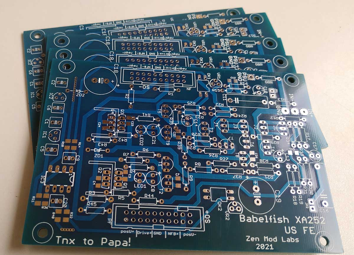

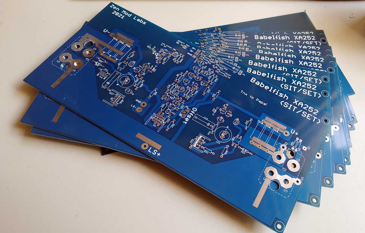

30Vdc rails is what you'll be happy with
so , lets say- decent 300VA Donut with two separate 24Vac secondaries , per channel
in that case, I see 33mF/35V logical choice for caps
question? - do you need something as XA252 for your spks?
there is upcoming Plethora of Pinjatas amp, which is nothing else than XA252 on regular 22V5dc rails and pair of IRFP in output
