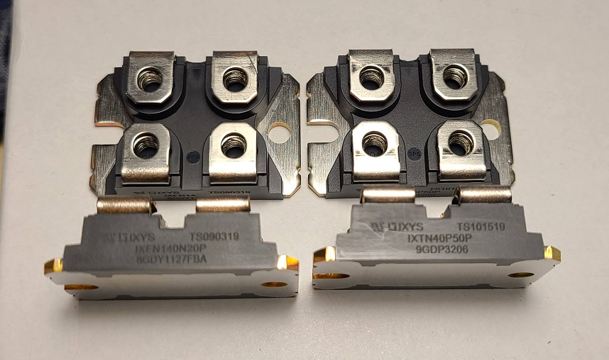

I might have missed it in the F4 Beast thread, but apart from power handling, do the big FETs exhibit a different performance/character than a 240/9140 pair? The transconductance numbers seem a lot higher - e.g., 38 S at Id = 20 A vs 6.9 S at Id = 12 A, but I realize that's not a direct comparison due to the different test current.
I'll have soon all of recent xformer based amps made with Plethora FE - same names, with "P" suffix
This is exciting news - I'm especially curious how the OS of the M25 R.2 will compare when wrapped in a feedback loop with this FE.
generally, THD is notch lower when going Biguns
that from start, and up where little ones are going out of steam - difference getting bigger
though, always worth observing bigger picture - what speakers, how big SPL and, in the end, what Watts
we all know that with little ones (suddenly TO247 little ) we already have exquisite amps
catch is - with Biguns - driving them appropriately
Indeed. I'll likely try out a version with the 240/9240s in my drawer before splurging for the $$$ IXYS.

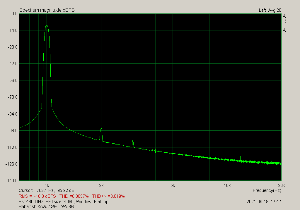

Babelfish XA252 SET

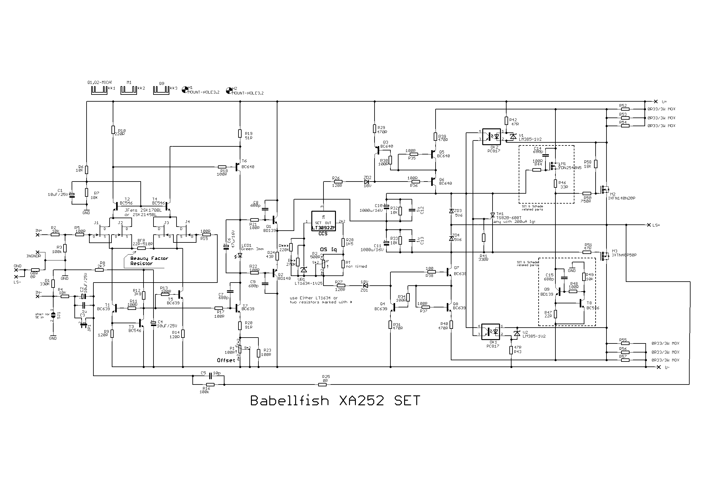

as my pal Indra, member of same Pantheon and evidently same Caste to which I belongs, asked ....... here is schm of Babelfish XA252 SET
fancyschmancy name for Schade iteration of full Mos OS, where upper output Mosfet is Schaded, so practically being emulation of SIT
gate resistor R50 increased to 750R, introduced new resistor R58 (18K)
SIT related parts (two rectangles of short dash lines) mounted - as for SIT iteration, but instead of M1 - IRF510 (we are using for SIT), placed DN2540
R46 changed to 33R
we need around 3V voltage level at left (inner) side of R50, so result as is - DN2540 gate voltage is 3-4V-ish (fine tune of R46 possible to achieve full symmetry of M1 and M3 gate voltages, trivial task) ; these being referenced to output node
all parts titles ref. to attached schm
once when I have final pcb, containing all 3 amps , schmtcs with proper nomenclature will be posted
I could avoid T8-Q9 30mA CCS, and route lower end of R46 to output node (M2 source), but as I already had CCS in place, why not using it
yes, as Indra said - Papa's fave gigglywiggly graphs are saying that 2nd is neg. in phase ; that not posted, just simulated, but no reason for doubt
so, schm:
R46 changed to 33R
so, schm:

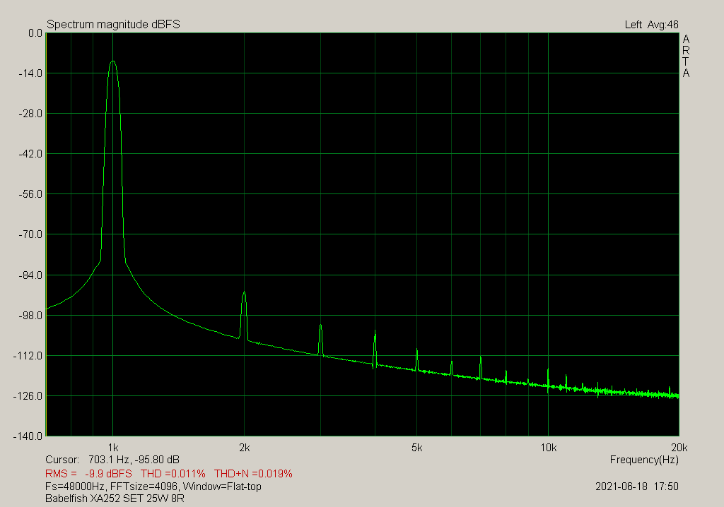

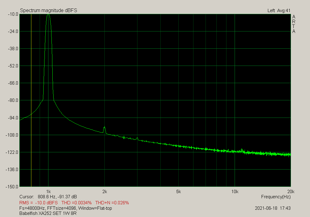

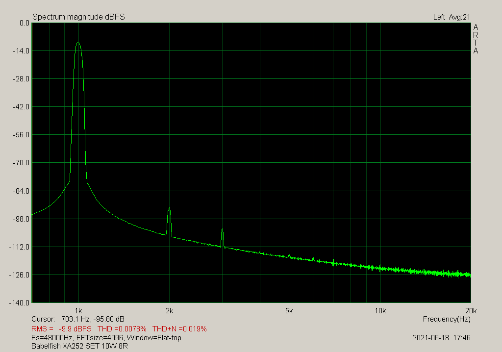

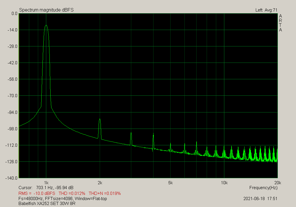

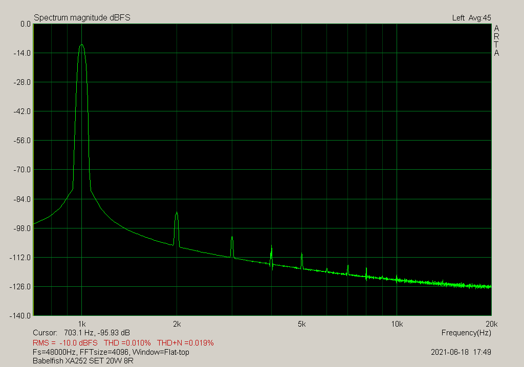

Babelfish XA252 SET - graphs , 8R load, BFR=22R
as titled
rails as previously: +/-30Vdc, Iq 1A7-ish
as titled
