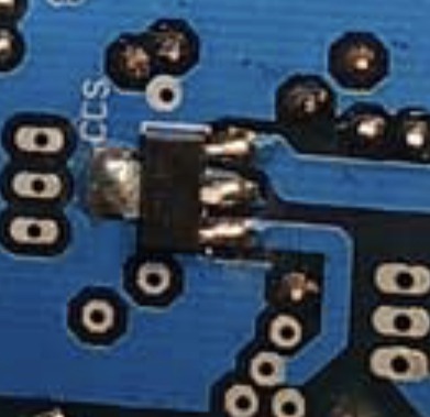

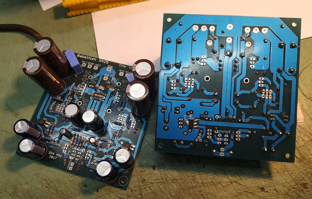

B. XA252 - deliberately made to use classic LTP instead of (BA3) complementary JFet input stage
(reasons being - wanted to avoid scarce JFets and also wanted to avoid simple copying)
down the memory lane .......
post #1314 in F4 Beast Builders thread, brainchild of Mighty ZM, embracing PapaFE but introducing some twists and quirks
as it happened, written in very first post of this thread:
And they were sitting, populated, on my shelf ........ always being pushed to bottom of list; I knew they would work, but somehow I wasn't content with overall picture
just imagine these (fully populated) sitting for 2 years or so..... I never connected them to power :
moral of the story :
- main purpose of Pa's hanging around here all these years is - him having fun
- second (less important to him, but illustrating his nature being partly Sisyphus-like) purpose of Pa's hanging around all these years is - him nudging us to use some brain, and not to fear of some gray smoke, here and there

Well I've been staring at the XA252 schematic(s) for some time and have extracted a BOM (which I find very helpful to understand the circuit and of course order parts) but have a couple of open points that I would like the community here to give some insight on if they are willing.
1.) The TPC 817B is no longer available. Any suggestions on a replacement? (I have a couple of 4N35 left from M2 build. I know different footprint)
2) Component values: Is 100pF correct for C8, Is 4p7 correct for the feedback cap C5?
3) Thermal considerations: I learned from the discussion in this thread that max rails are +-35V and a reasonable Iq max is 2A.
-are we talking 70W for M2 and M3 each?
-Is a standard on board heat sink for TO-220 packages (H=12.7 mm L= 19mm) adequate for Q9? Q1&Q2?
-What about M1?
Lastly any guidance on the footprint sizes selected for the Zobel componentent C19 and R64?
Thanks to all for their insight to date and a special thanks to ZM. Without whom none of this would happen.
-What about M1?
Well I've been staring at ......
.....which is exactly proper approach to start ....... everything
1. there are myriad 817* optocouplers around - it doesn't need to be TPC; for suffix - use either B or C
2. 100pF C8 yes, 4p7 C5 yes ; for peace of mind, order 100V
3.
- M2 and M3, 70W, yes - they'll be happy critters - no isolation pads, just goop
- use bigger one for Q1,Q2 pair - or pair of these back to back; for Q9 that size is proper
- M1, that size is proper
- Zobel is not used/populated; footprint/place "just in case"
