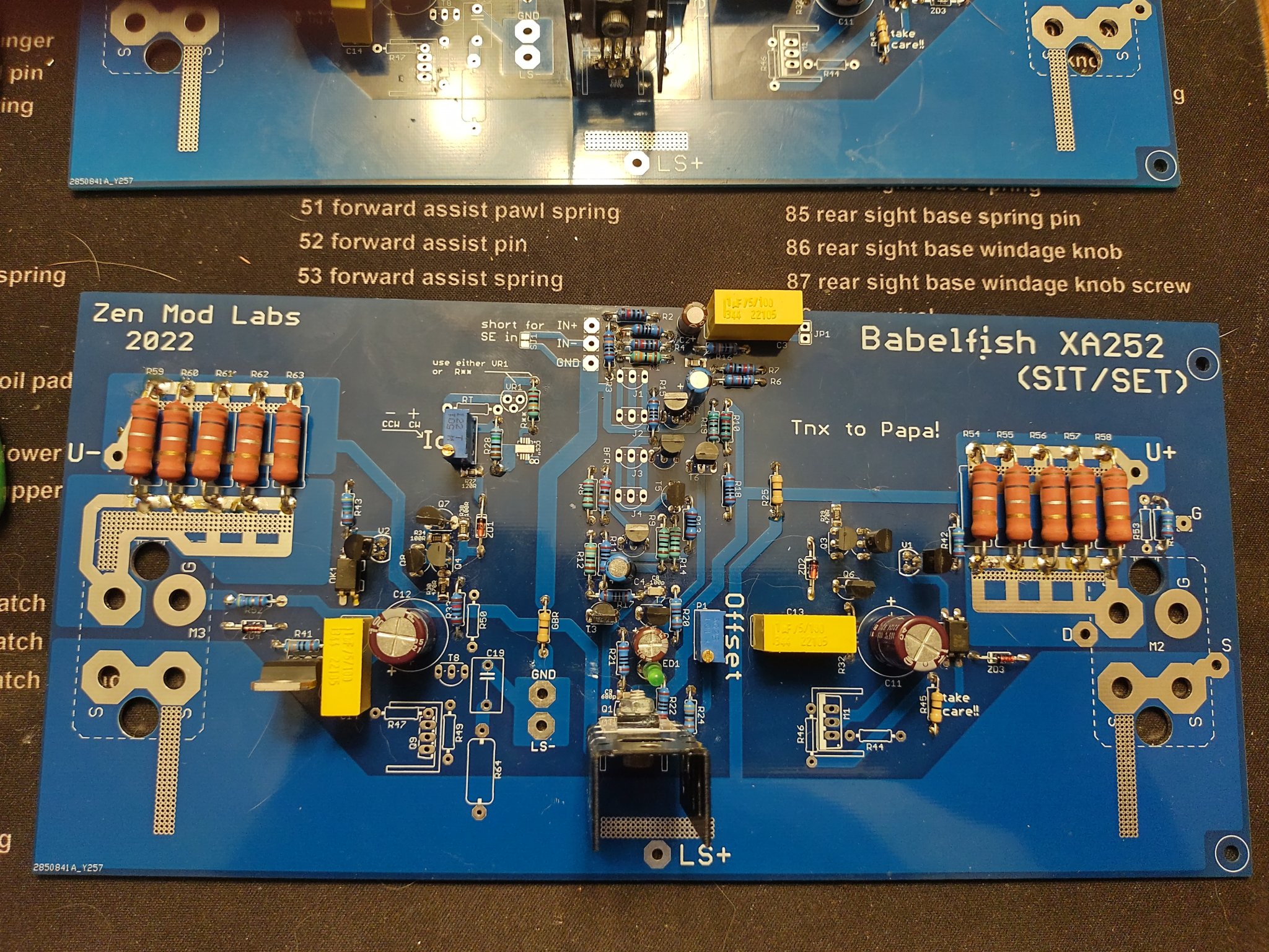

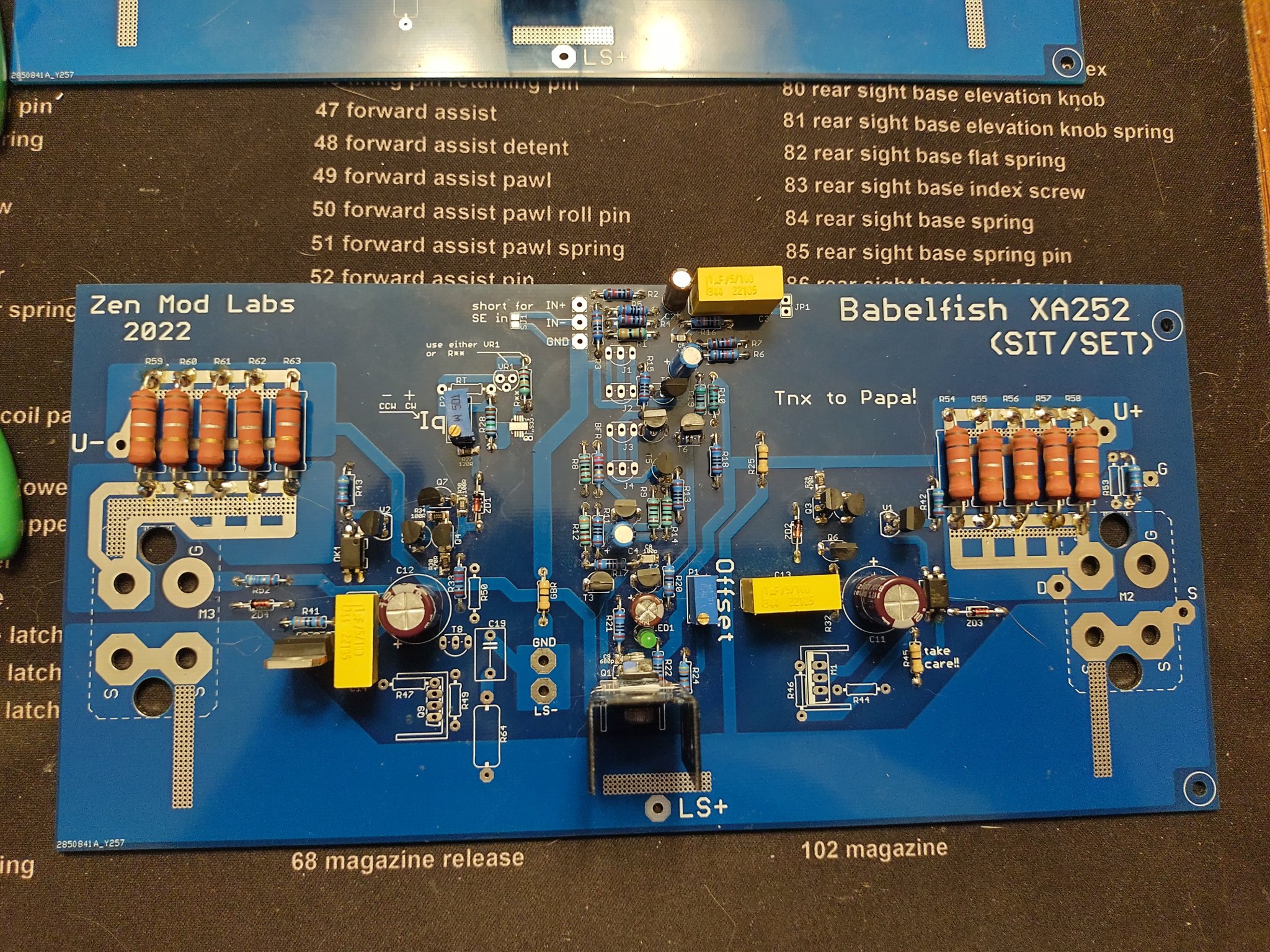

Received the 'cut-down' PCBs from ZM -> all SMD devices included except the LTP FETs. With many thanks
Used a matched sets of LSK170s from the diyAudio store - 4FETs per board wrt transconductance as advised by ZM - he was worried I might try and "go cheap"!
BD139/140 -> OnSemi devices with "all plastic" cases, so direct mount with thermal paste only, but lower gain c.f. other BDs I have on the bench.
My pucks are IXFN140N30P / ITXN40P50P.
Needed to drop R28 to 1k to adequately adjust bias - using 1.5k maxed at 130mV. At 180mV per side after 90min idle -> HS temp 46C.
In my previous SMD-FET version, dV across BFR under bias setting conditions -> 70-90mV. Using the matched LS set -> 1 and 2mV respectively. I know there is no way on Earth anyone could hear this ... but half the joy in DIY is knowing what is 'under the hood'.
That was all > 48 hours ago ... so this is a clearly viable approach if like me you bought some matched FETs from the store "just in case".

voltage diff across BFR is rather going to be result of (Vbe) difference between BC transistors acting as left & right CCS-es for LTP
smd JFets, what I'm putting in LTP - all 4 matched to 0.1mA
now, that diff. is irrelevant in dynamic modem that's why I'm not bothering to match anything else except JFets

Bias = 180mV / 1.8A (approx).
As ZM states - no insulation for pucks, just well smoothed-out thermal paste - the milling on the Chinese HS is "relatively coarse", so for this case essential.
Likewise, for the "all plastic" BD's -> just paste.
