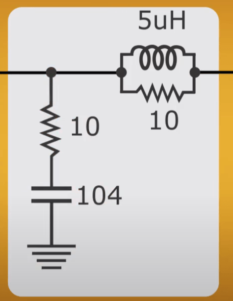

I am a bit curious so have a question @Zen Mod. Some power amplifiers have an air core inductor and resistor in series together with a capacitor and resistor in parallel between the amplifier and the output. Its purpose is to protect the amplifier against capacitive speaker and cable loads as well as BEMF feedback and/or resonance etc. Main goal with a Zoble network is to have an even impedance load on the amplifier.
If this have been covered before, redirect me and if now, why is is not used and if the amplifier would benefit from it in terms of stability, are there any issues if I add a zobel ?
XA252 is very well behaved, existing filtering covering all 3 iterations of amp
in latest batch of pcbs I did include placement for RC in parallel to speaker, just because, but there is no need for that nor I can advise inclusion of any additional filtering
even if intuitive more filtering looks "more safe", it can result in phase changes leading to oscillations
so, sometimes more of the good thing is ....... simply too much of good thing

I guess its fair to conclude with when an amplifier is developed, one spend time, or rather you spent time, checking against real world scenario and how the amp behaves with an impedance load. I am certainly not implying that you didn't, the only reason I asked about the zobel is because it is used sometimes and sometimes not, for reasons beyond my understanding. One would think that always is good, but like you point out, sometimes it is not.
To zoble or not is a complex topic, but your answer is good enough for me 🙂
it's "just" that there are different ways of achieving same results
goal is to have predicted and benign phase behavior through entire (intended) frequency spectrum, across entire power range, loaded with real world load

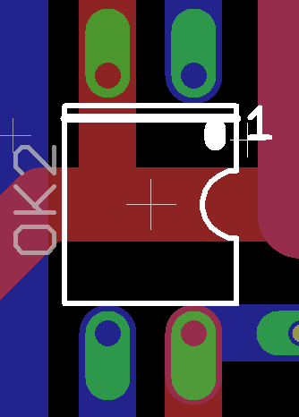

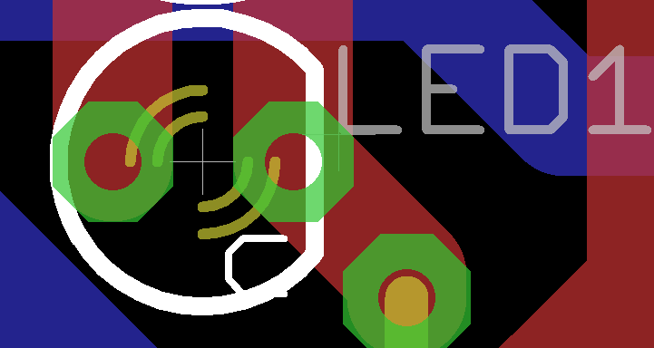

Boards almost done. Two orientation questions:
LED...pad on RIGHT looks like it has a mark or some kind of marking, is that for the short cathode leg?
OK1 and OK2... part doesnt have indentation as silk screen, but does have a round mark in one corner. How should these two be oriented?
Thanks,
Russellc
C at LED top overlay/symbol means Cathode
short ot long pin - dunno - ZM always forgetting that, so I'm using my DMM for re-establishing short knowing/memory
opto - see enclosed - it's covering all possible scenarios of marking pin 1 - notch at side, or long stripe, or dot
