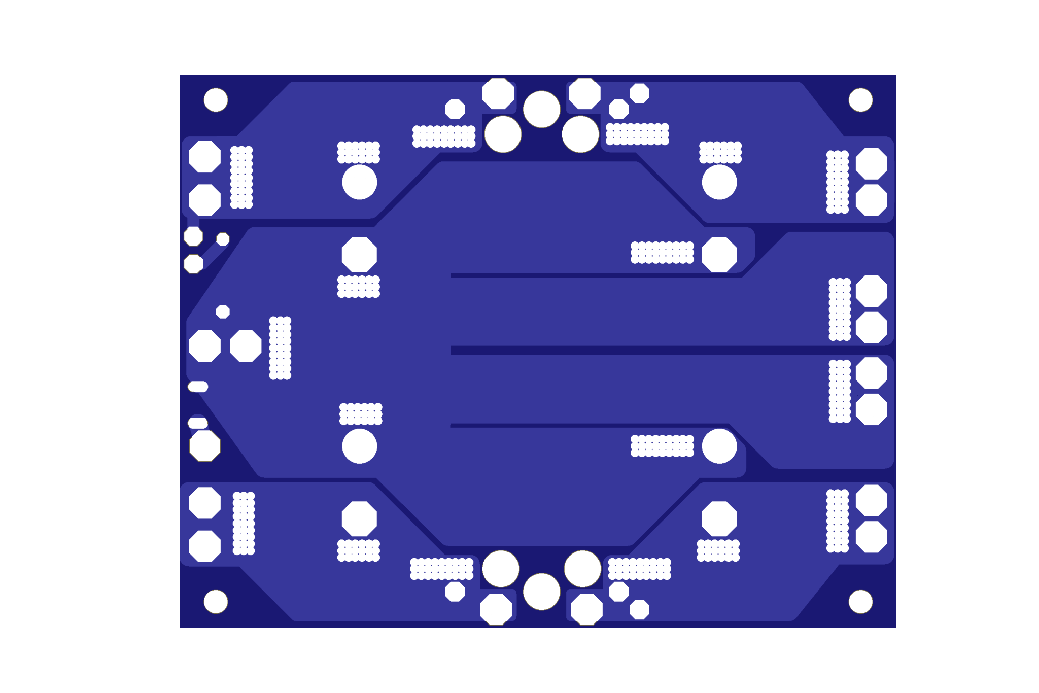

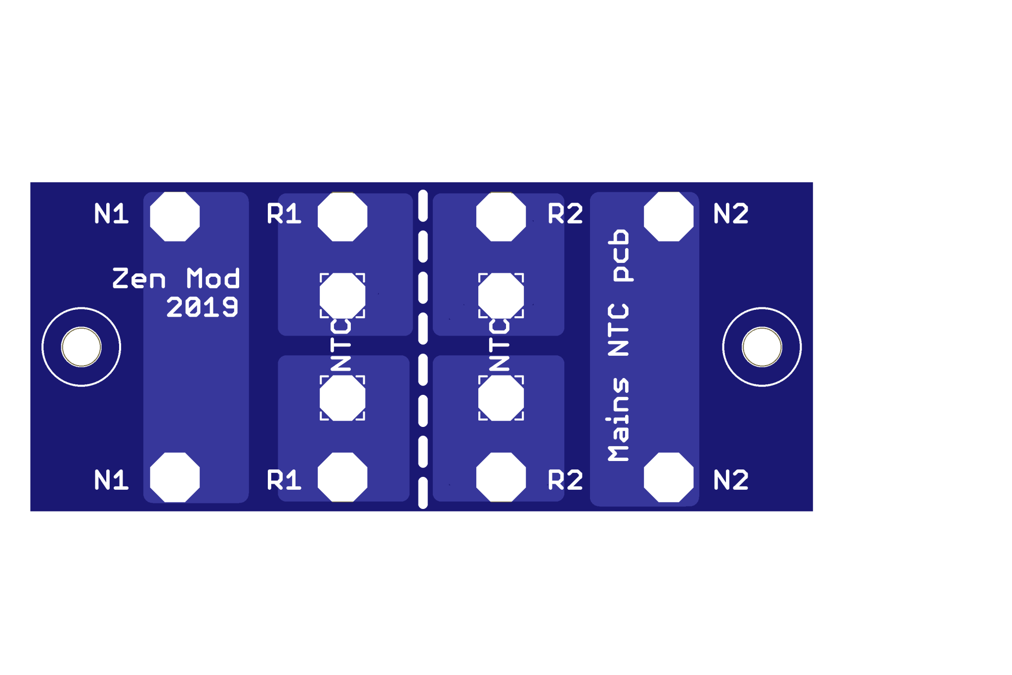

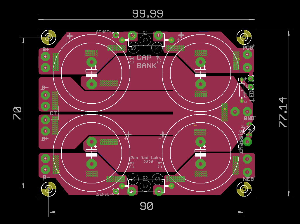

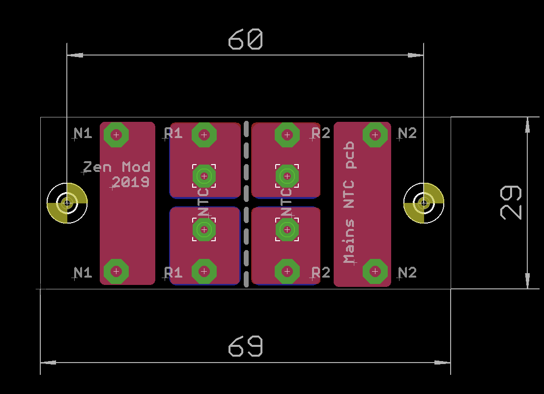

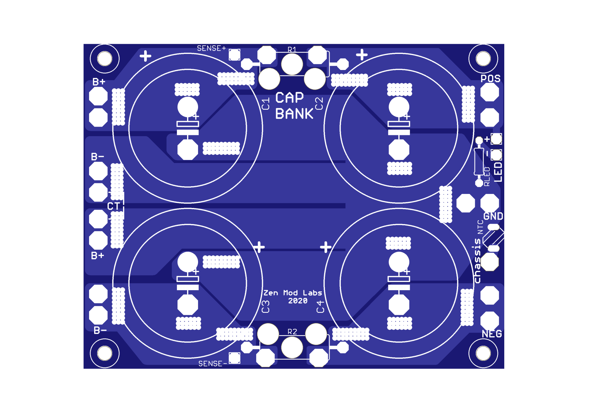

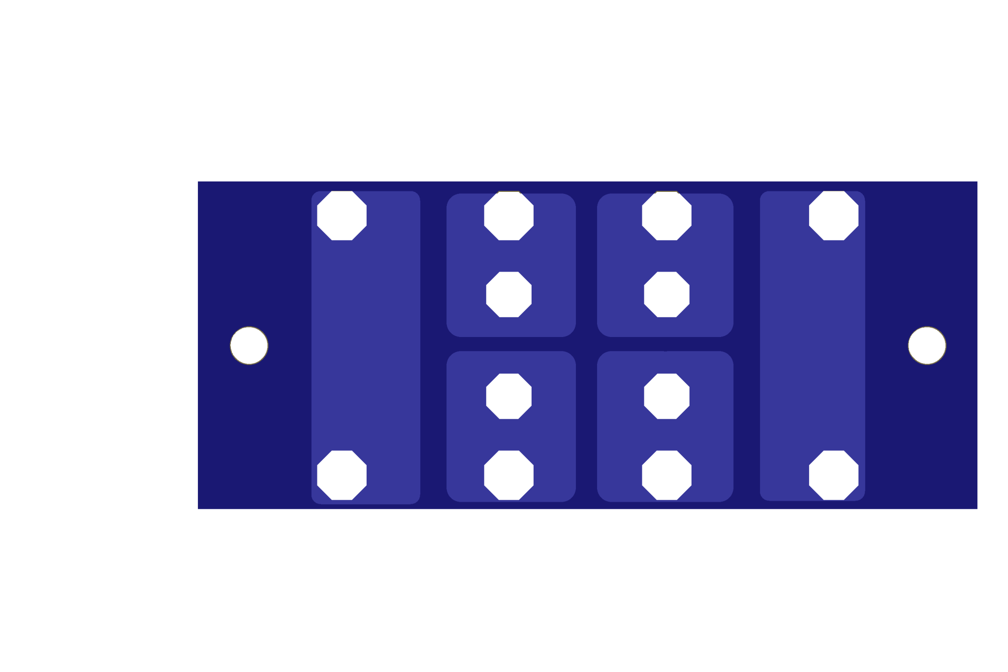

HA! means Handy Addendum
consisted of pair of Cap Bank pcbs and pair of mains NTC pcbs
Cap Bank pcb- CRC per rail, led resistor and led pads, small NTC (10mm Dia) between audio GND and chassis; each C snap-in, max Dia 35mm
NTC pcb - dual - so each pcb covers either dual primary Donut with 1 NTC per winding, or covering two Donuts in case of single primary; NTCs are CL60 format/size
some graphical info, present in most of my Trade threads for amps but anyway

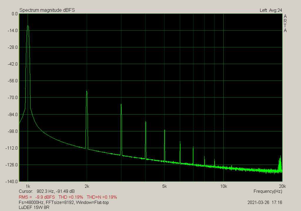

see, in principle, what I prefer
post #908 https://www.diyaudio.com/community/threads/ludef.369990/post-6997306
just one of posted; I took care to have all necessary info shown on pics:
Simple and straight forward - and it looks like you are using CLC here. There is a lot of talk about this amplifier (LuDef), a favorit perhaps ?

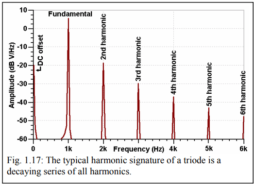

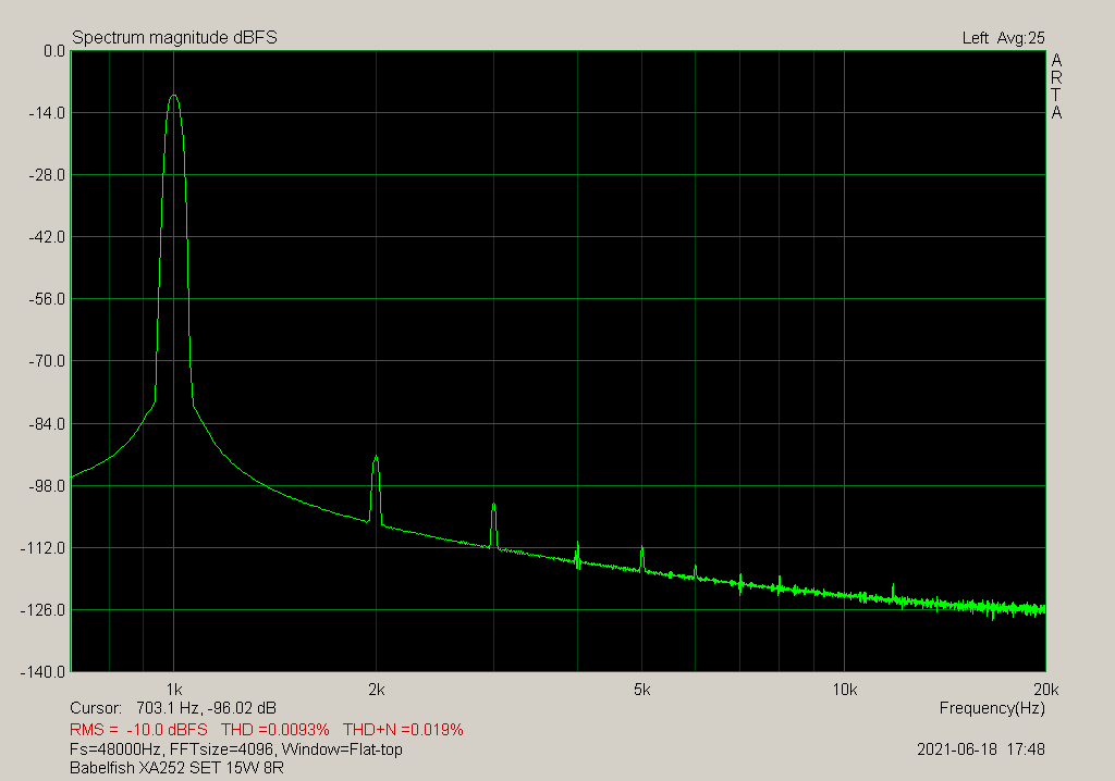

What strike me about the LuDEF compared to XA252 SET (shaded) is how much closer the LuDEF is to a triodes THD .. and now I cannot unseen... 😳 😆
Triode picture source: https://www.valvewizard.co.uk/Common_Gain_Stage.pdf
measure of my stubbornness and inability to move from beaten path is - I'm always striving to:
-dominant 2nd
-preferably negative phase of same
-spanning that THD Spectra to entire power range, meaning - 3rd never becoming dominant or maybe just on highest power levels
now, THD Level really depends of entire concept of amp itself, but one can only be surprised at start, realizing how similar** are two amps sounding, even in case when one is having minuscule THD (XA252 for instance) and other one practically being THD generator (SissySIT for instance)
under condition that testing is made on speakers adequate for both amps
**not really searching for sweetness (often related to high THD SET amps) but more for level of fun factor and immediacy

2nd order harmonics (even) is pleasure and why so many including me, like triodes. 3rd order harmonics (odd), brings clarity but can sound harsh if too present. Most natural instruments have similar harmonic decay to a triode... Theoretically, LuDEF should be more pleasing.

What I am curious about is the elevated triode behaviour of the LuDEF and where it comes from, which circuit parts or components are responsible. Like I said, I need to go over the threads and take notes to understand what separates OR link the amplifiers.
No matter, thanks a million for all your efforts Zen 🙂
cascoded LU is practically super-pentode, when thinking of transfer-characteristics
triodish transfer characteristic of entire amp is primarily result of DEF OS transfer characteristic, and more (random) details about that you can get from above linked DEFiSIT thread
it is normal to think of complementary follower OS as we are used to do, striving for most symmetric parts and expecting least amount of THD
now, Pa (even if not first to try it) scope that from different angle - he deliberately chose to use dissimilar parts in "complementary" follower, and having desirable THD SPectra as result
so, me Thief as I am, later tried all sorts of combinations - SIT up/mosfet down, Schaded mos/up mos down, mos up/Ge down, mos up/bjt down ........
one can use bjt darlington in place of cascoded LU and get pretty much same results
all roads are leading to Rome ..........
to get it mentally, all you need to grasp is - just think of xconductances of parts in OS follower; observing OS itself, when upper is having lesser xconductance, you get 2nd dominant with neg phase; when lower is having lesser xconductance, you get 2nd dominant with positive phase
though, phase is not so important; as Papa did show in the past - flip speakers phase and you're flipping dominant phase
