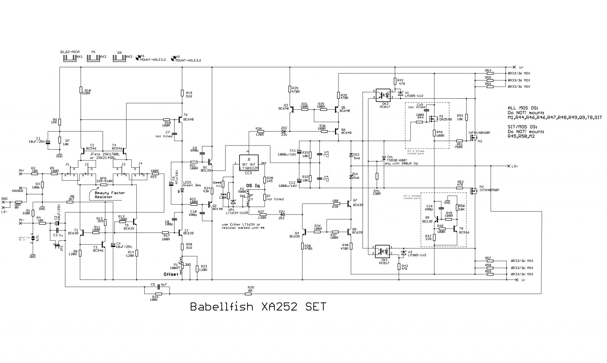

Q: The XA252 US FE is the addition card needed for Ultrasymetry / Balanced .. but this schematic was never released, only the simplified ?
Does the US version still have stability issues ?
I would like to support your work and buy a XA252 US FE set (one chn) and incorporate it in my SMT work if the circuit is stable. If the US is not ready, I will wait for that one.
Hi ZM,
before I start heating up the soldering iron, I would like to ask if this schematics is correct for the SET version (your post of 12/18/2022). If so, are the annotations "do not mount..." irrelevant to the SET version? What does "C15 not fitted" mean - should it be left out (because it's not fitted anyway) or should it be fitted because it's not fitted yet?
Many thanks in advance.

Hi ZM,
yeah, post #624 https://www.diyaudio.com/community/...2-sit-babelfish-xa252-set.373443/post-7206721
that's pretty much final SET schm
only difference you can find is - do you have 3W resistors groups of 3 (0R33) or 5pcs (0R56)
caps - not fitted means - not needed
so, consider that I did all necessary smd work, through hole is up to you

power off, check all semis in FE
something else gone south
power up again only when you're sure that you fixed all bad components
Pulled T1-T7 off board and did basic multimeter voltage drop test. They all passed. Also did same for JFETS on board and they also passed.
well, something is wrong
having one channel behaving, you can at least do some ohmmeter/diode test measurements, comparing good vs. bad channel
check resistors around/up/down BD transistors; trimpot too
well, trimpots are used as variable resistors, so one outer and wiper pins are shorted
similar you have in current mirrors in OS biasing circuit - two transistors are having base connected to colector, but through 100R base resistor
besides that, no deliberately shorted pins on components
again, you have one working channel, as reference for troubleshooting other one
