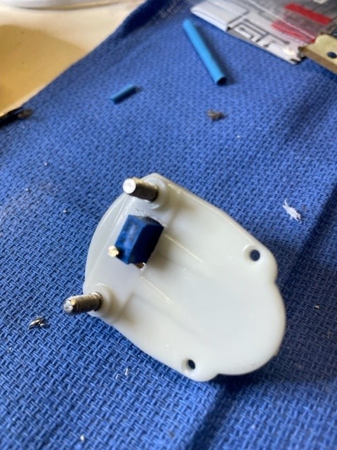

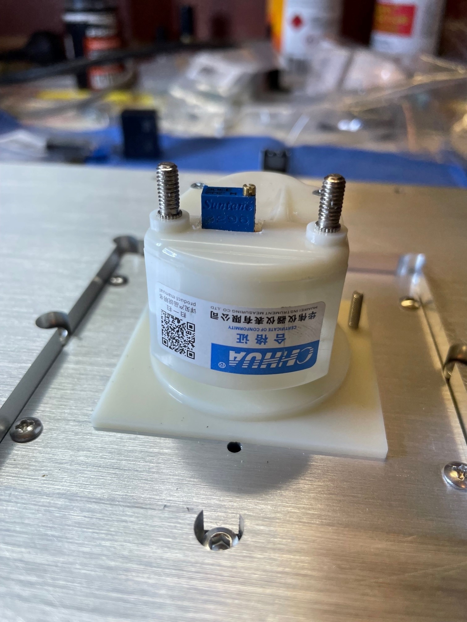

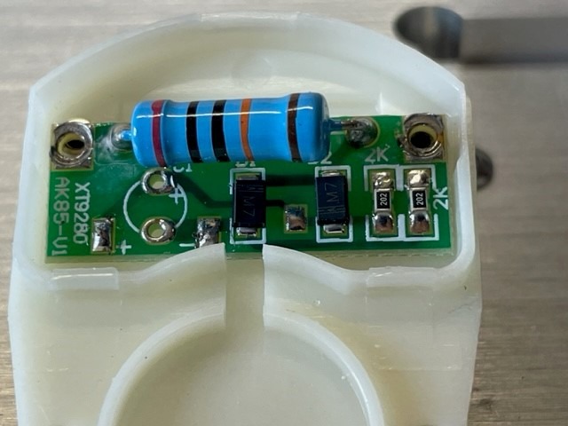

Also, how did you get the gauge to work?
Gauge comes as VAC for mains use - see meter1 & 2
Raw gauge = 160R / 160mV full deflection -> 80mV for "half-way marker"
The standard diyAudio power supply boards have spare R slots across the CRC filter, which will have a dV proportional to total current draw.

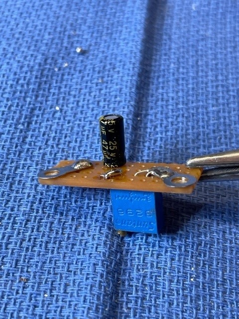

Placed trimpot (1K) in series with meter on back-side of board, then drilled hole in meter back-plate for easy access. Small electrolytic cap across meter.
Set bias for both channels, then adjust trimpot -> mid-point of meter. So registers overall bias current draw.

I like that. the voltage drop across the R in the CRC is a super simple way to do it. More current, larger voltage drop.
Very curious about your experiments with the LSK170s. From my limited experience with the 802D4, they are very telling speakers. You have to make them happy, or else!
Just be careful, depending upon how much 'C' you have in the CRC!
I have 33000uF x2 pre/post R. So the current inrush on turn-on, and hence the dV across R, is initially quite high.
On turn-on, needle goes to "full" deflection then settles - not mechanically a threat, but if I was doing it again I would use a lower V / higher C electrolytic across the meter - say 470uF/6.3V. I just grabbed something in a tray lying spare at the time ...

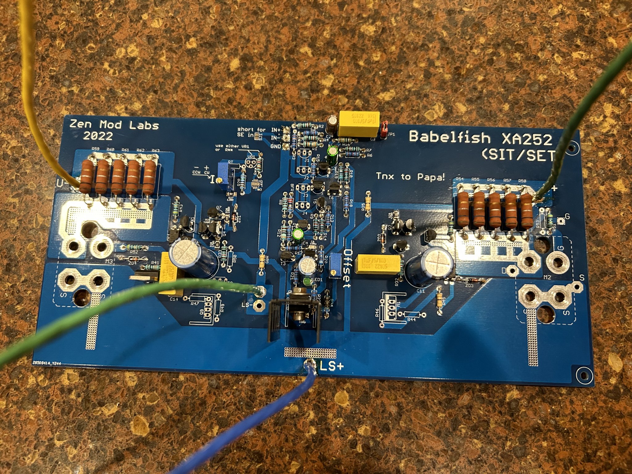

Would Zen approve if I worked on an all SMT variant and post progress as well as get feedback such that it becomes as good as it can be ?
is there any better way to make amp for yourself most possibly personal?
though, don't forget that pucks are so apart with reason ......... so any parts miniaturization will not exactly save pcb area significantly
I mean - go for smd from any other reason, except making pcb substantially smaller
Probably not 😉 but I don't own the rights to the schematics, so not doing any changes to its design without the designers consent. And fyi, an SMT proposal is not because I think your PCB design is insufficient, it is simply an effort to improve and suppress S/N even further. I support myself on valid measurements that show a clear improvement in lower noise floor of surface mount devices due to the smaller package size. an S/N of -125 to -130dB for SMT resistors is very common and the whole circuit would benefit from this since the weakest point of a populated board is its weakest component.
these parts aren't critical at all
just take care of them being at least 100V Vce
no need for matching
I'm down to two 100V BJT sets, both are from Toshiba and both are damned nice parts. set #1 is the 2SC2881 / 2SA1201 (SC-62 package) and set #2 is the TTC004B / TTA004B (TO-126N package). Set #2 are in my book the ideal choice with a Cob of 12 and 17pF respectively as well as 1.5A and 1.5W dissipation. They can also be mounted on the main heatsink and thus, unload the PCB from some heat generation. Even though they are TH components, the legs can be mounted on the PCB if allowed for edge mounting, aka, SMT style 😉
you previously asked about current mirror transistors, so I'm thinking solely of those
......in biasing circuit, dissipation is minimal and what you need to think regarding dissipation is just their temperature
so, same as I did - keep them on pcb, so you'll get them reasonably cold/warm (pretty much on ambient T.) and you'll get them all on same temperature ........ which is important
Within a similar temperature window is something that I tend to forget, but it is important as you say. And with that I press on
