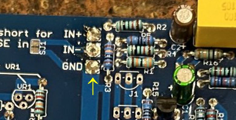

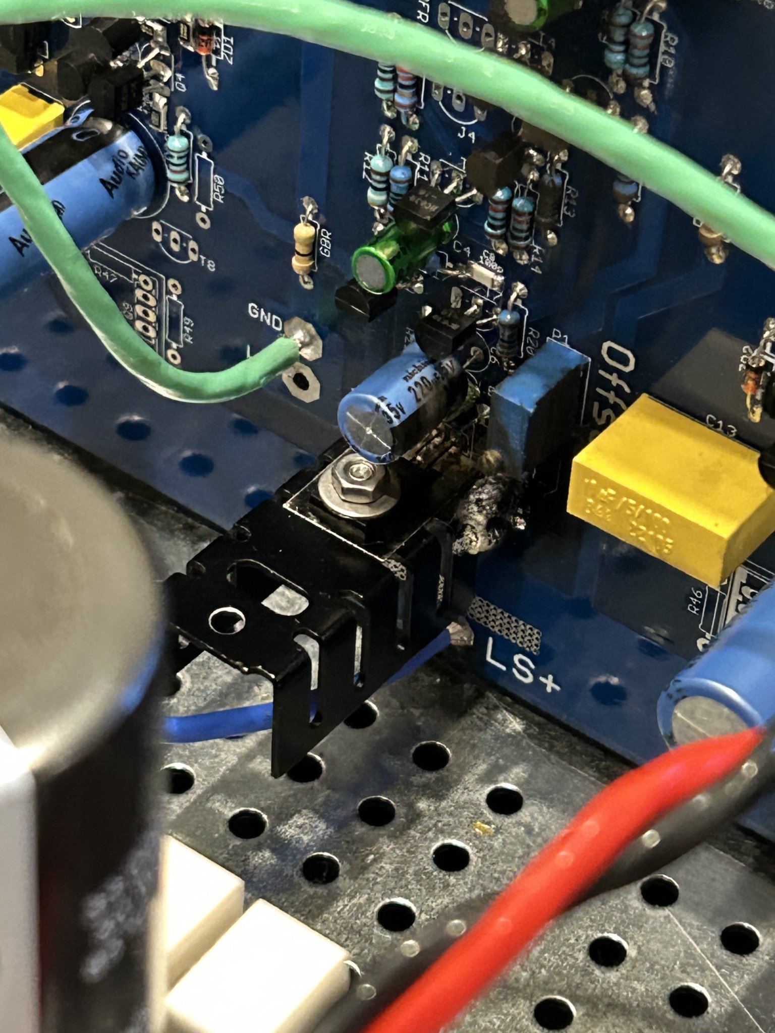

Q1 (BD139) was bad. I checked it earlier and it seemed fine but apparently not. Luckily, ZM included 4 in the kit so I had a spare. 🙂 Currently listening to it biased at about 185mV with <5mV offset.
When testing outside the amp, you still want to ground IN+ and IN-
Also, have you altered the PCB in any way - the GND solder puddle looks different to the 2 pads above?
I tested in the amp with everything grounded at the XLR and RCA. Those pics are after yanking the boards to check components.
Is the offset stable when you move your multimeter leads around with the jumper in?Q1 (BD139) was bad. I checked it earlier and it seemed fine but apparently not. Luckily, ZM included 4 in the kit so I had a spare. 🙂 Currently listening to it biased at about 185mV with <5mV offset.
Not sure what you mean by moving the leads around, but the offset is stable. It was moving up and down about 3mV with the jumper in.
Wow, she's cooked. On the next one (if you haven't already) raise the resistor so it doesn't burn a trace or pad.

only logic is - part partially damaged with initial error in assembly, gave up later
Agreed. It appears Q1 went, taking Q2, R24, R21, R22, T7 and the LED. Unfortunately, I don't have replacements for the semis or led so I will need to order new parts.
