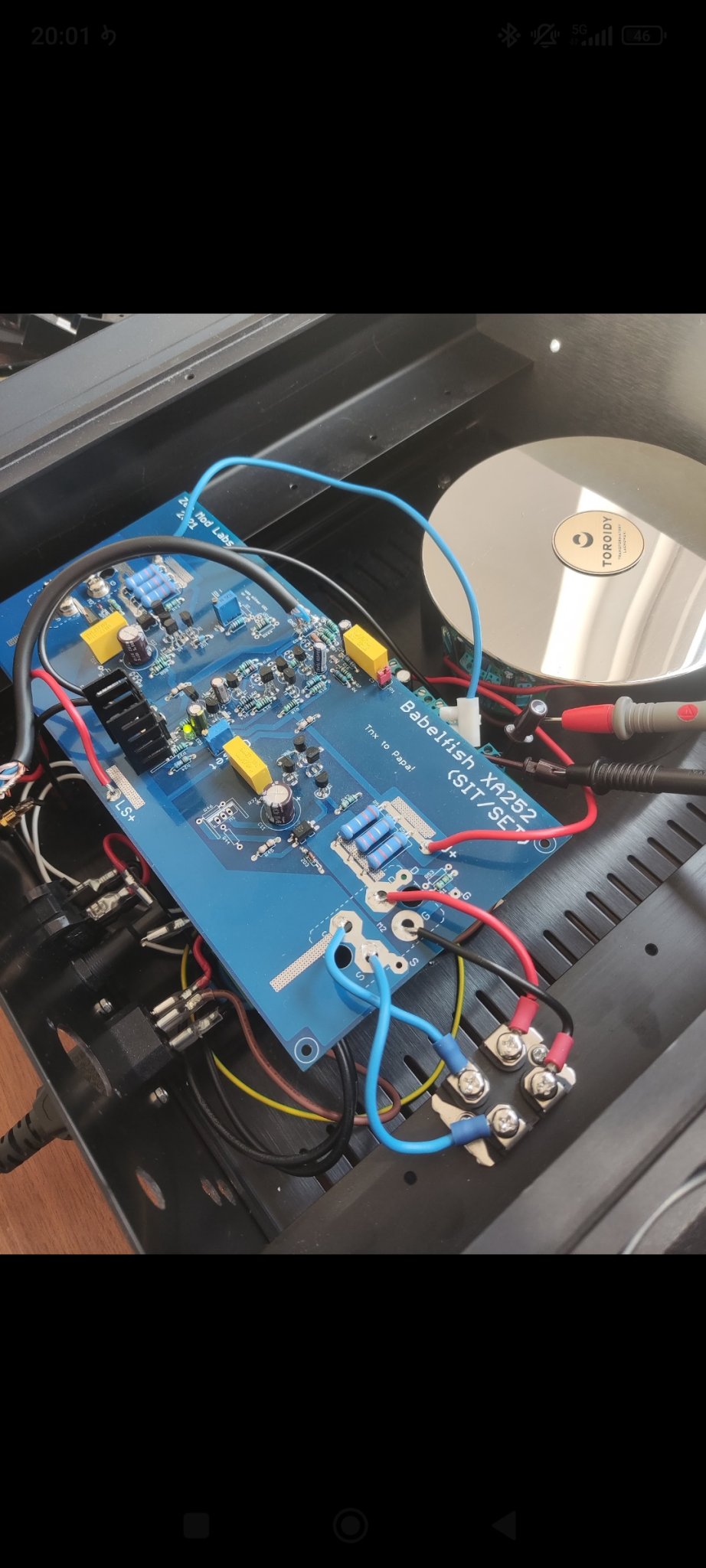

Rails are rather high, 34V after the SLB PSU. What's the reasoning behind your comment regarding 30vdc/5ohm? I'd like to learn😀
30vdc is the minimum ZM recommends for the big pucks because of interelectrode capacitance increasing substantially under this value.
So 30vdc is the minimum you can go. With 30v rails and enough bias you will get close to 100w in 5r and double of that into 2r.
The same ZM recommended higher rails if you want to get same power but into 8r.
Since your speakers stay more in the 2-5r range it would be better to lower the rails and increase the bias.
Lowering the rails from 34v to 30v will increase the thd a bit but it’s up to you to decide which is the best compromise that you will make.
Same ZM said that an amp it’s made out of compromises and now I get him better why he said that. The good thing is that being diyers we can build and adjust to our needs.
Thanks, that does makes sense. I don't know how to and if to lower the rails but I will consider this as a possibility to further improve.

if it was me I would just bias properly the xa252 and forget about the rest. With properly I mean to give me 30-50W in class A.
Now I think you are aware that if you want to get 100W into 2r and all of them in class A you will need to bias your amp close to 3A which is quite difficult from device SOA pov and dissipation pov.
First of going the route of biamping I think it`s worth checking the impedance for the group of speakers(in a speaker) you want to use. It`s possible that you will find surprises again. Count in that with the vfet the amp has a higher output impedance and will drive lower loads more difficult than the mosfet version.

So, your Mightiness, is it okay to mount the big pucks to the heatsinks left and right and use some short and thick wire (similar to the Scryer's big fat FET) to connect them to the board?
yup, gate resistor ditto to gate contact on case, properly heatshrinked with wire
if XA252 SIT is in case, P channel mosfet stays with PCB, SIT goes on flying wires

Like this?I will start this autumn with the amp, and as always, first plans are made for monoblocks (in my head)... if possible...
Thanks! I will build the MOS only version, so the IXYS will go to the heatsinks with wire, and no mosfet on board.yup, gate resistor ditto to gate contact on case, properly heatshrinked with wire

Like this?
pretty much yes, even of Chicken as ZM would mount gate resistor ditto at mosfet case, heatshrinked with wire coming from pcb
I mean - that's one of options, having T bar on heatsink
if heatsinks are normal flat, pcb should be mounted flat on one heatsink, with flywires for second mosfet on second hsink
