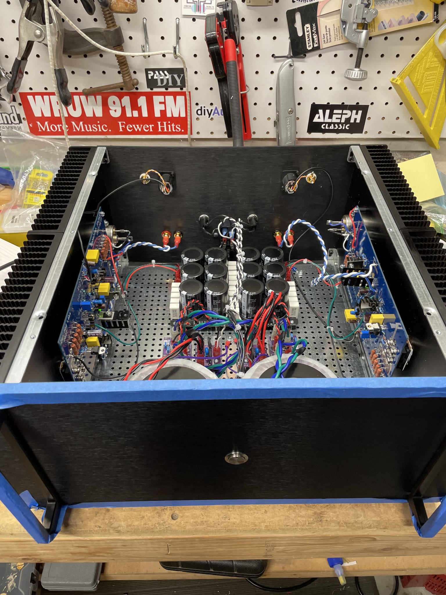

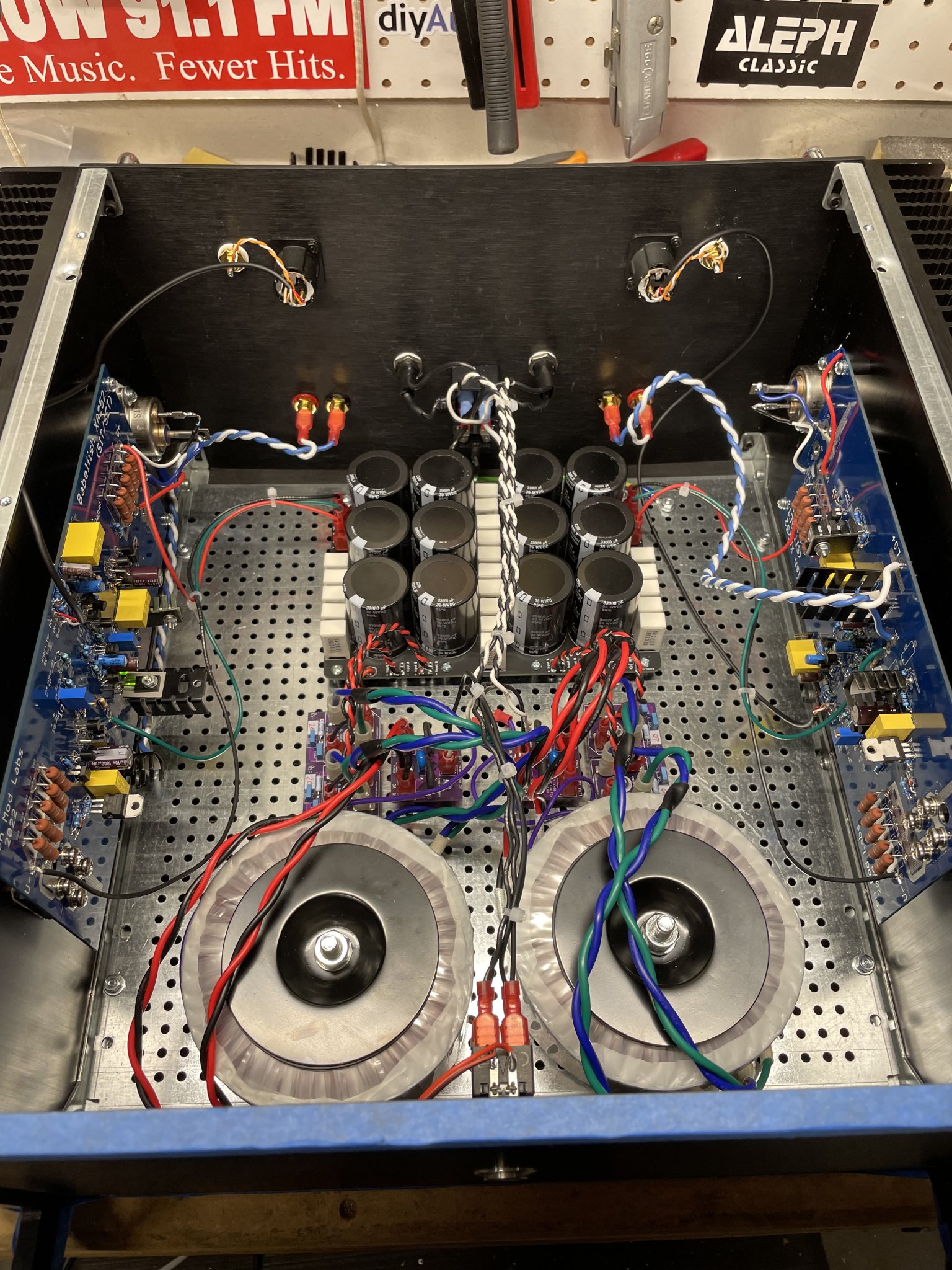

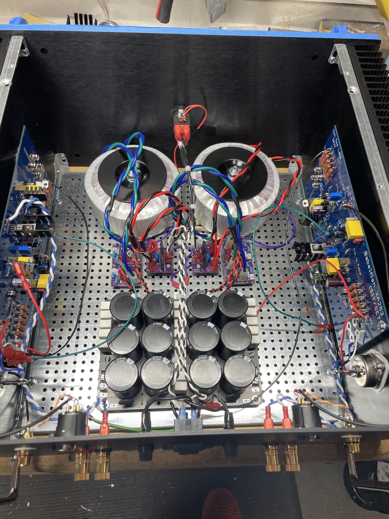

Ive been listening almost all day. Even with lower bias it sounds wonderful. While it's not a clean build it still is relatively quiet. I have a little hum on the channel with the longer signal cable. All should be resolved when building mono's. 😎
no wonder that you have some hum, when Donut is ditto under the pcb
to prevent any stray magnetic field, existing shielding should go to proper steel with 30mm thickness
Haha ok, even if it's the super fancy stuff from toroidy?
I guess I won't bother with the fancy looks for the other channel. ZM, do you know of any other suitable donut suppliers in Europe?

ZM - need ideas.

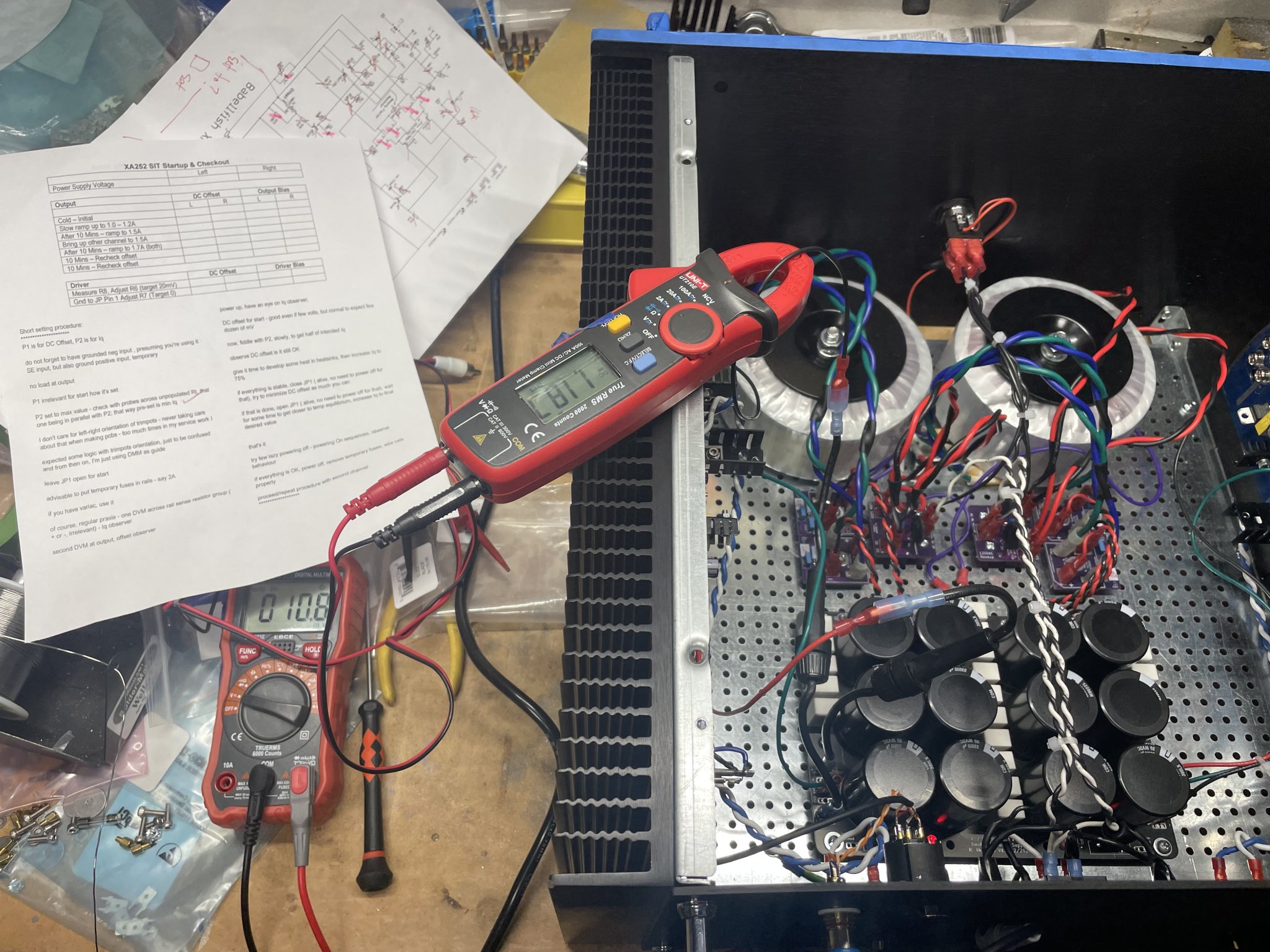

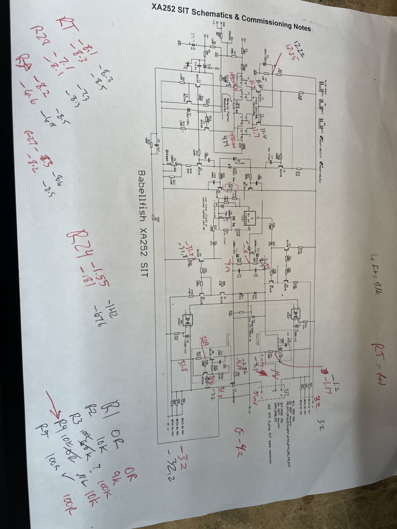

XA252 SIT. 32v rails / 1A7
I was going through power up and set up sequence. One channel behaved perfectly.
Other channel was perfect until I installed the jumper. I released some magic smoke, so I immediately killed power. No fuses blown. It looks like R46 is blown. Perhaps other items, too. I powered up again briefly and I see rail voltage for offset.
I decided to put down the tools and rest for the night before I begin taking the board off the heatsink and looking more.
Ideas?

Yes, JP1 is what I installed and saw the problem.
I have XLR Pins 1/3 shorted, and RCA +/- shorted. There is a possibility that my XLR jumper was "iffy". I may also add clip leads for next time. I'll have a look at the parts you mention and try again.
Problem solved. I replaced the blown up R46 and Q9. The IRF510 tested OK, so I reinstalled it.
I tested and wrote down voltages for good and bad channels. They looked similar.
So then I tested resistances around the jumper and inputs. Aha, the bad channel looked funny. I had a small solder bridge on the bottom of the board in those resistors around JP1 and inputs. Easy fix once diagnosed. Amp is now set up at 32V / 1A7 with <2mV offset with jumpers installed.
It sings on the crappy bench speakers. Later tonight I will fire it up on Tannoys. And I'll get a little XA252 SET vs SIT listening opportunity this weekend.
