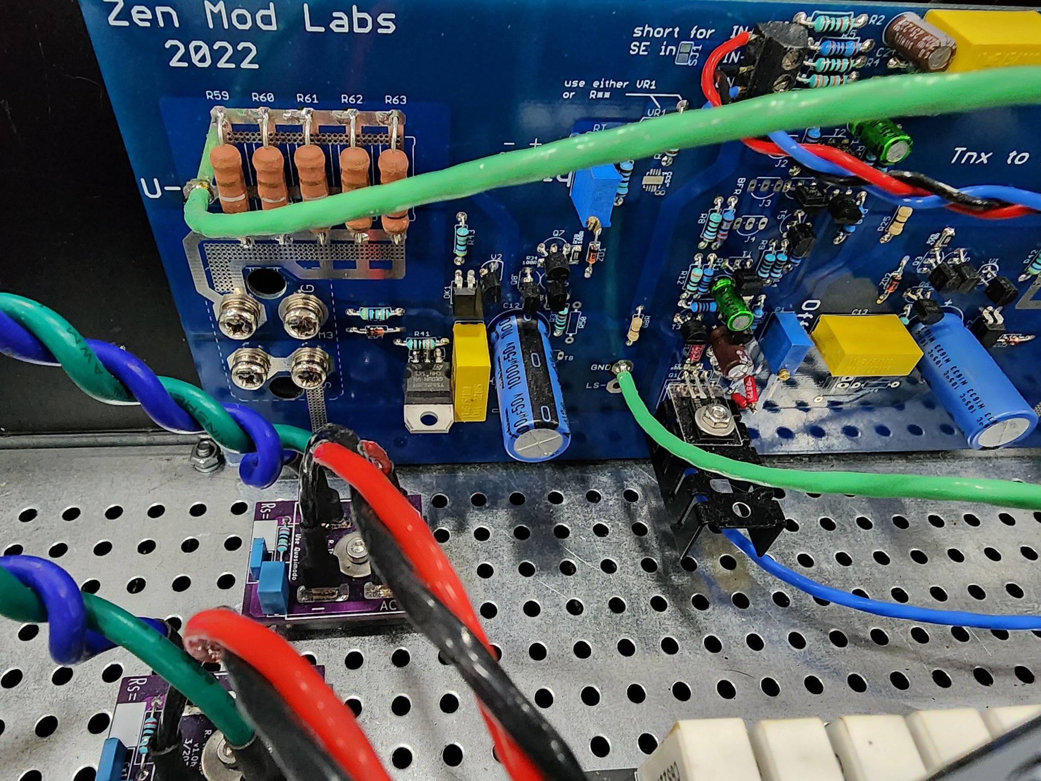

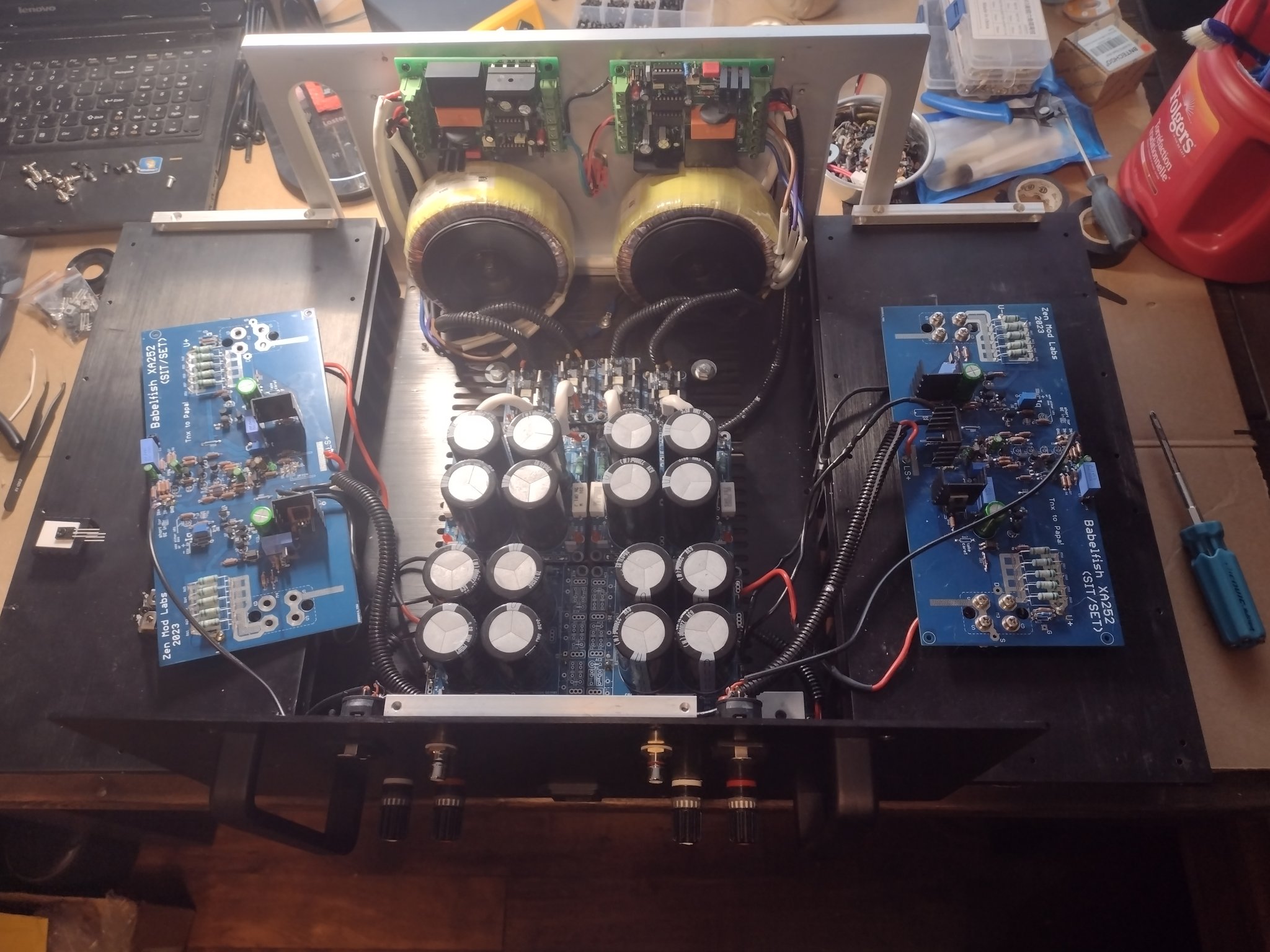

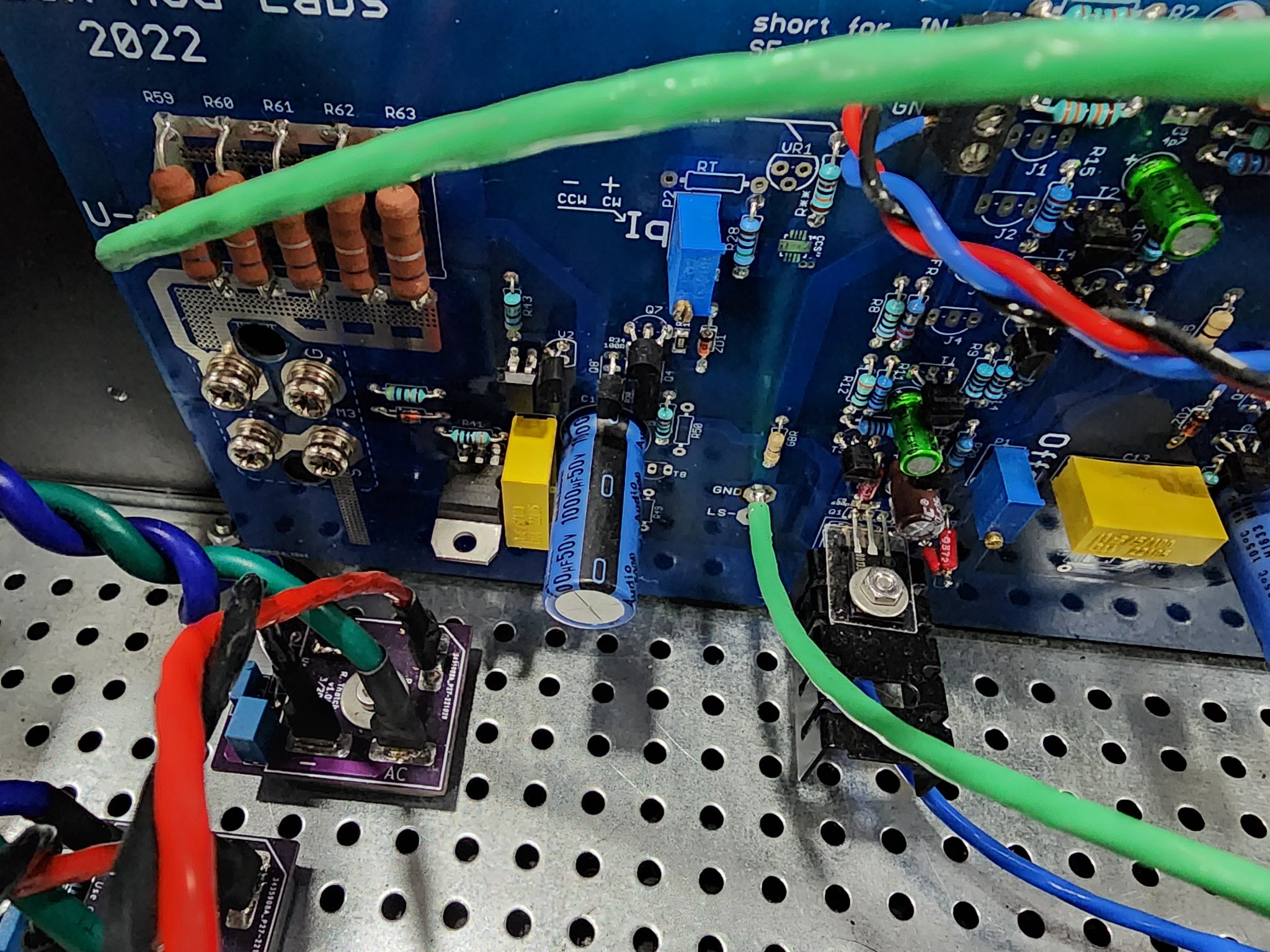

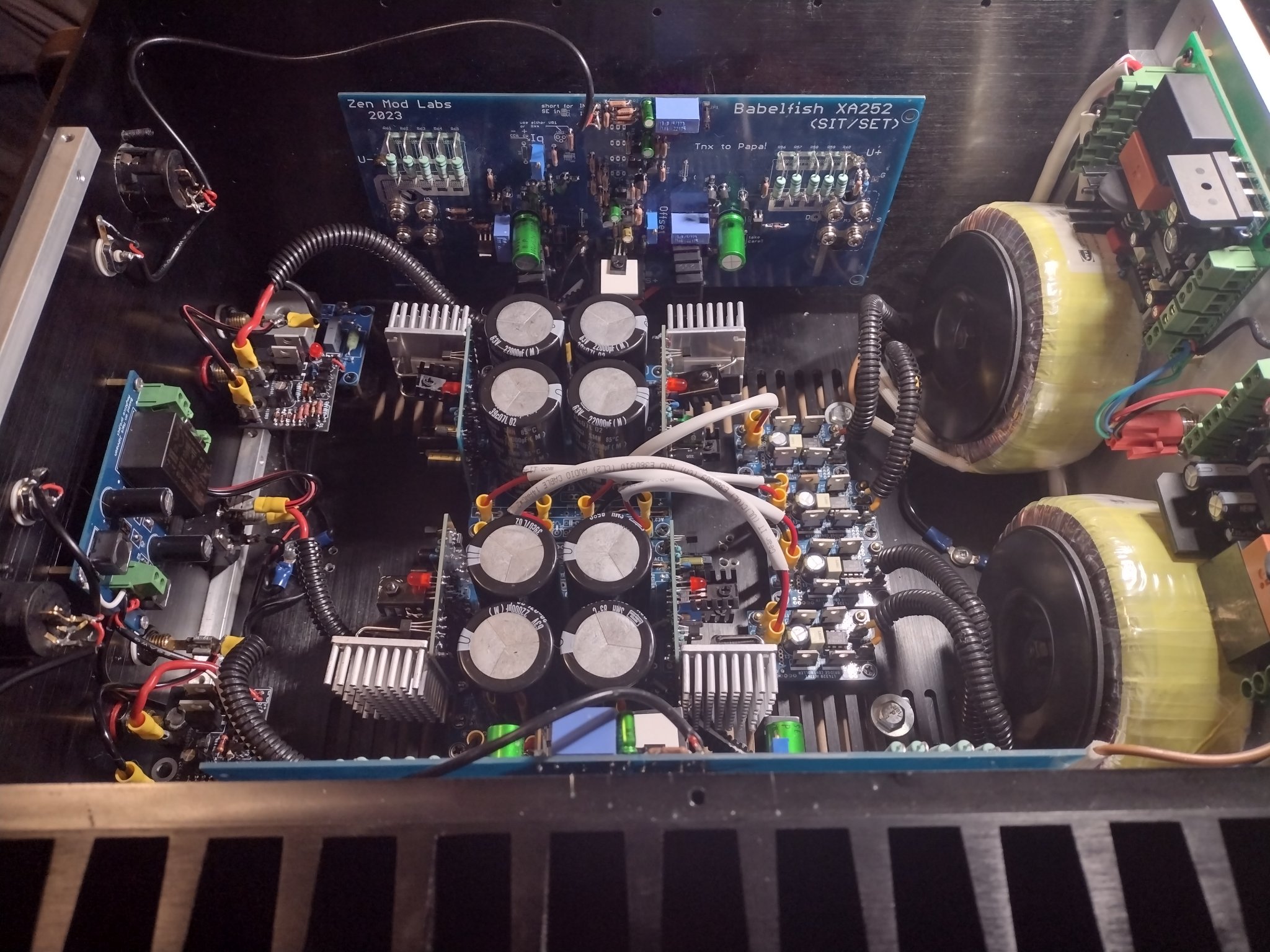

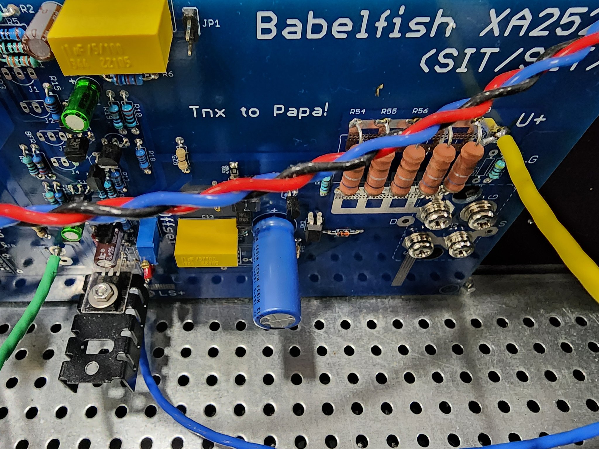

While I had it apart to replace the BD139/BD140 I decided to change up the power supply section. Pic on the left is before and then the next is after with R21's added. Rails at the boards are 38.5v and bias is set to 175mv. I also added speaker protection, cause why not, LOL. Max temps on the heatsinks so far have been 51C. New KEF LS50 drivers patiently waiting for crossover parts to come from Solen. Should be interesting to swap this one with the BabelFish F8 currently in play.

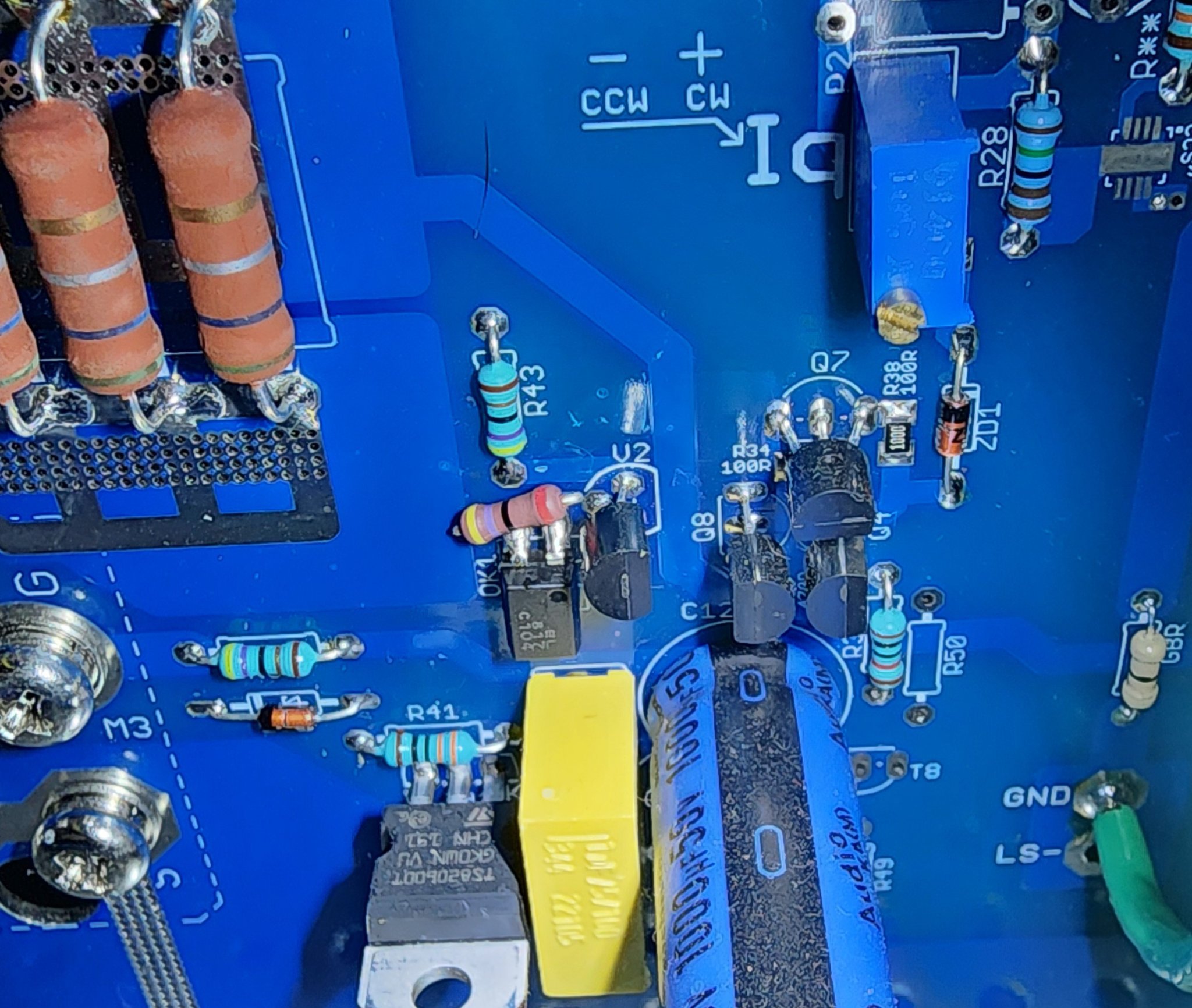

I need a little help.

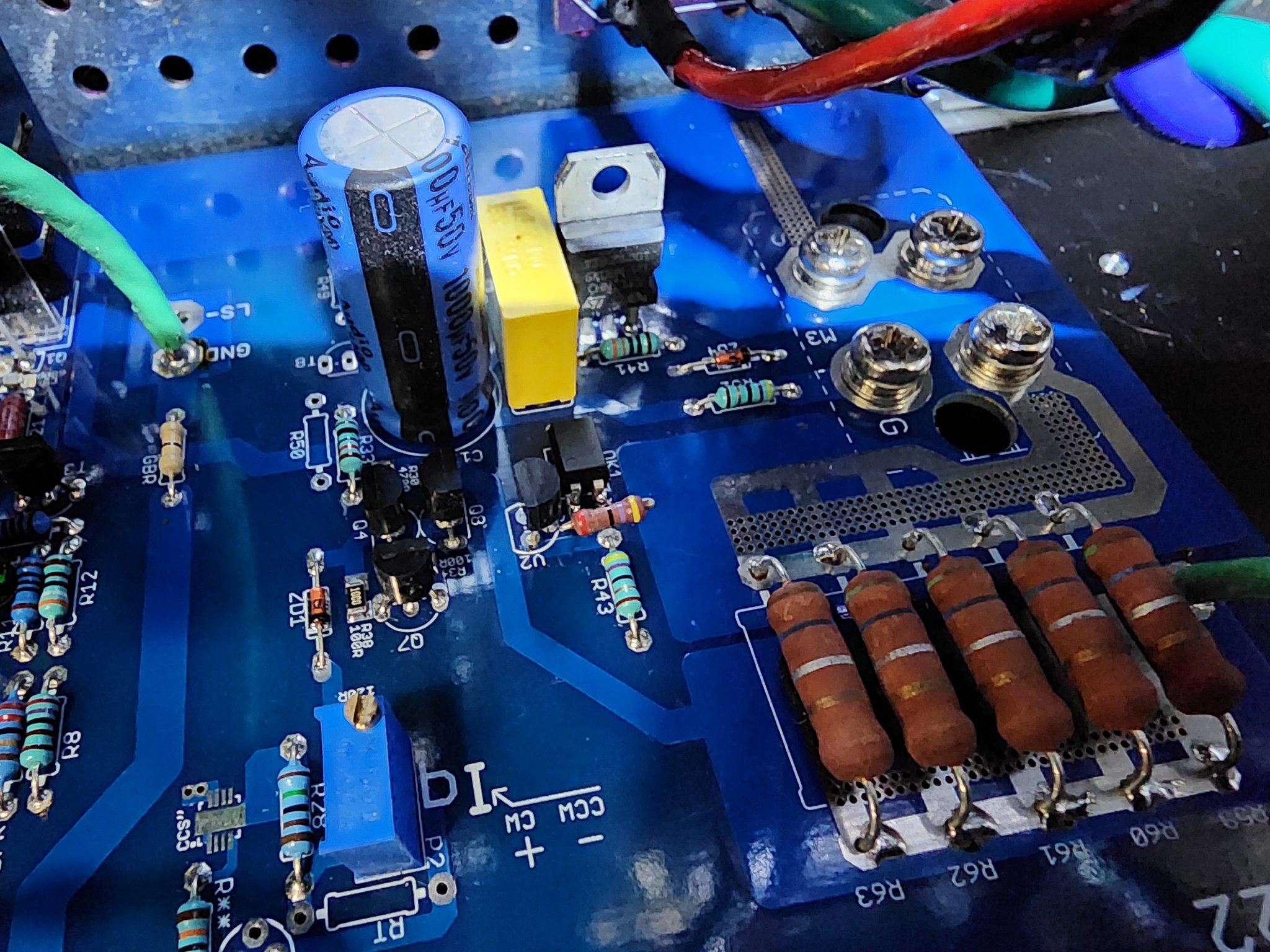

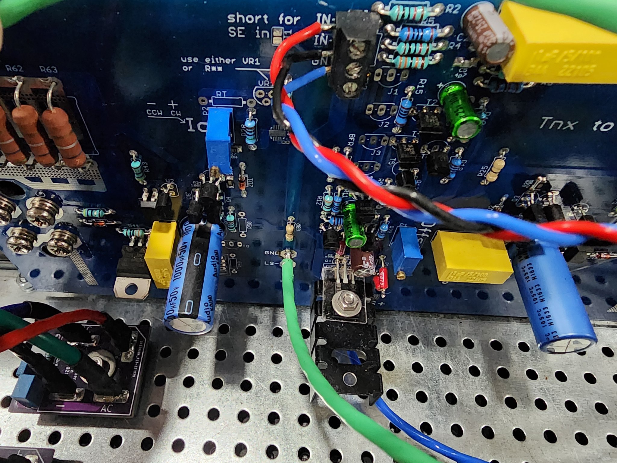

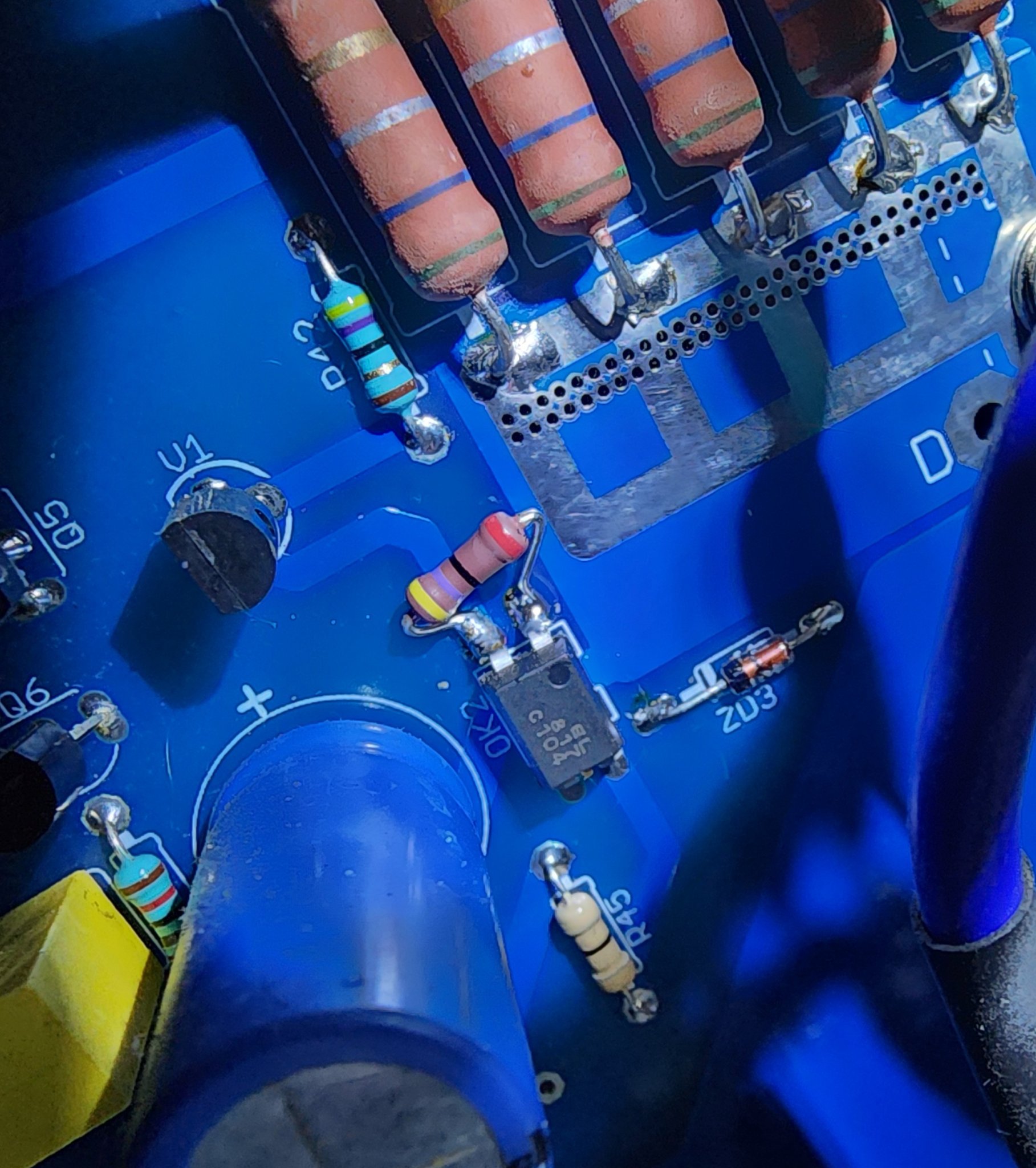

I have @wdavis009 XA252 build here at my place in the cold and damp Pacific NW. I have been watching the the "fix" suggestion here and pulled the amp from my rotation to do the resistor fix as suggested in post #2573. However, now that I opened it up, I don't see where I can do the mod suggested in the post. I don't seem to have the same PCB. What should I do to protect the amp/speakers?
Edit: It seems I am just dumb....I just need to add a resistor in parallal with OK1 and OK2 per the suggestion in post 2573.

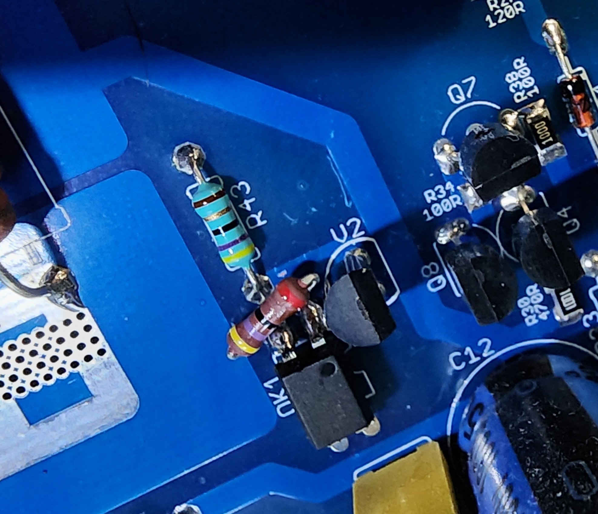

easiest to do without any dissssssssssssasembling - 1206 smd resistor ditto at OK pins 1 and 2
Ok, now that I straightened myself out and before I melt tin and lead, a 47 ohm 0.25W resistor is a very reasonable option for OK1 and OK2? So 4 quantity total 47R installed for my fantastic sounding stereo XA252?
Since I didn't build this amp, I just am looking for that thumbs up for feel good factor before I take action.

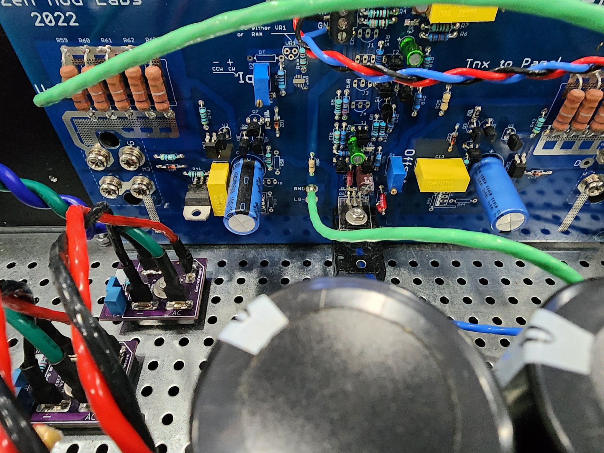

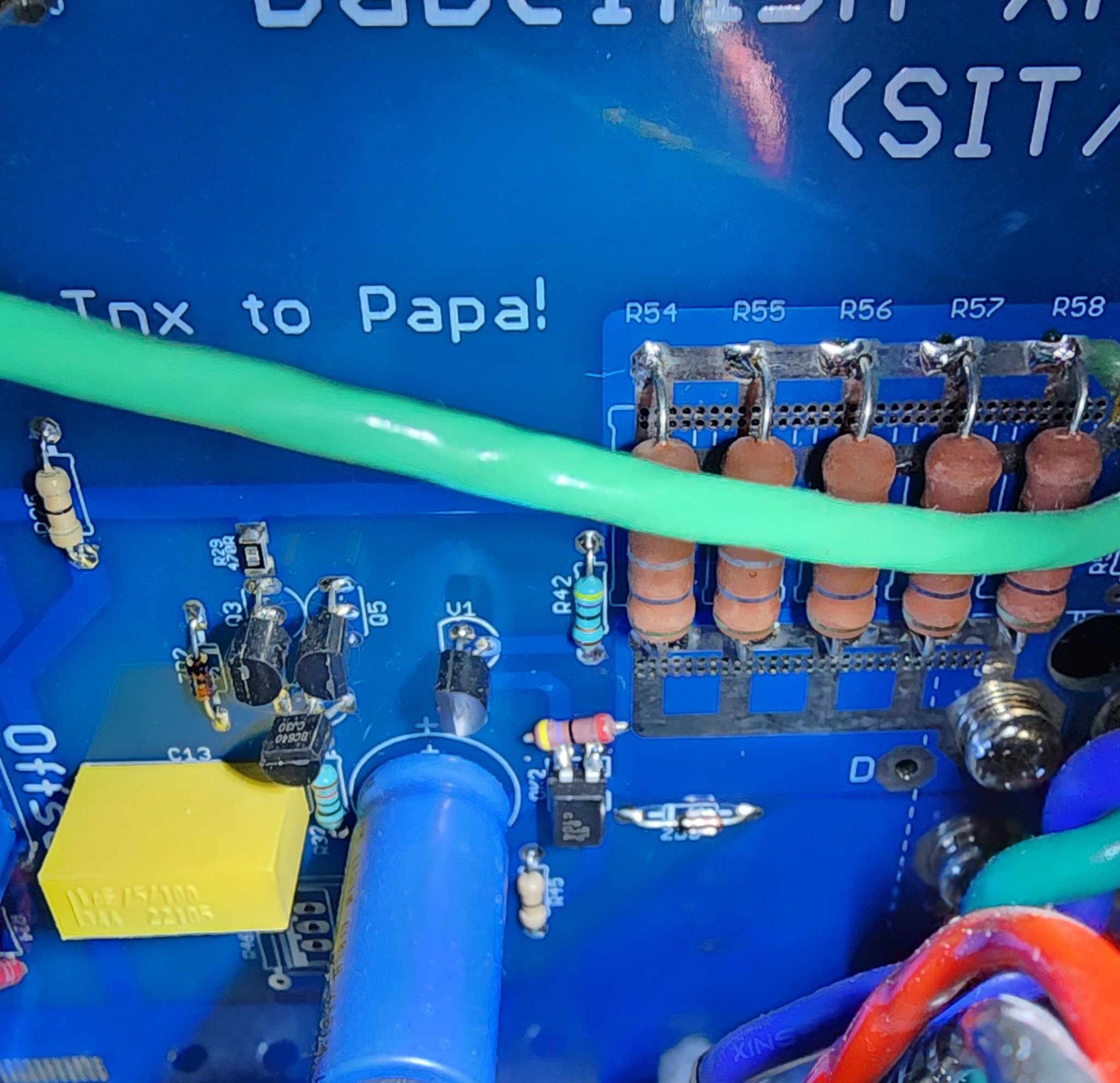

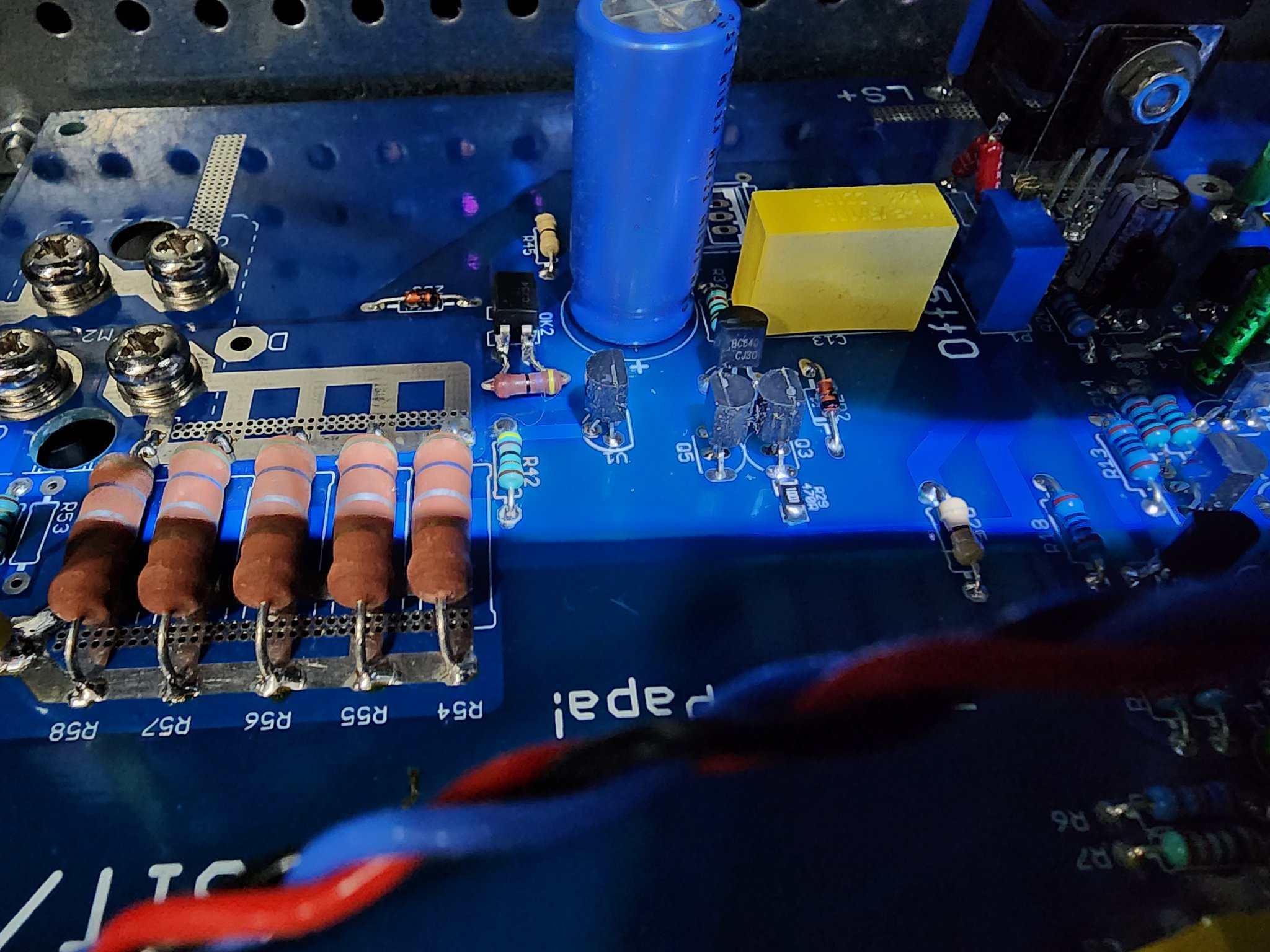

The 47R resistor mod for OK1 and OK2 on both channels is complete. Not pretty, but it was a little challenging to get the soldering tip in there, hold the resistor, and feed in the solder. I wasn't born with three hands.
I'm a little scared to just power up. Is it a good idea to use a DBT, or is that me being a scaredy-cat? I could just kick the Aleph Jzm out, power up and play tunes. Is that better 😉
it would be easier if you formed it as vertical
anyhow, you did it
judging by pics, you're good to flip switch On
anyhow, you did it
Dang, you, your right, and when you're right, you're right. I've got some courage now, so thank you! I'll report back soon.

Powered up just fine. I did notice there was a new "hum" around volume "12" (of 24) that went away after going up to volume 16. So not sure if there is some sort of inpedance mismatch around 10-14 volume. Really odd as the hum rises in volume to a max at 12 on airon Pumpkin and then tapers off by 14 and is inaudible at 16.
With that said, at volume 16, zero audible hum and the XA252 is singing glorious tunes.
