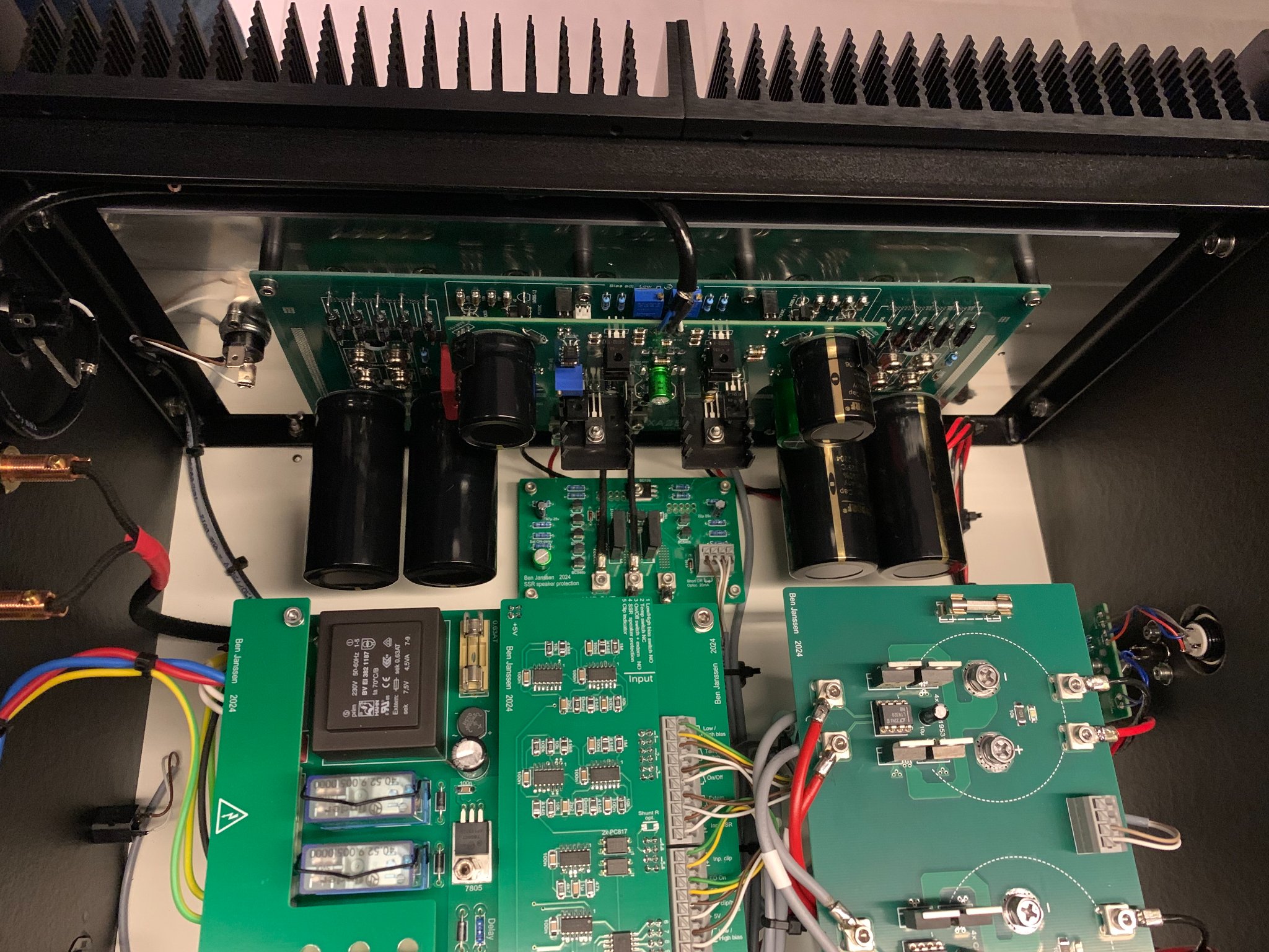

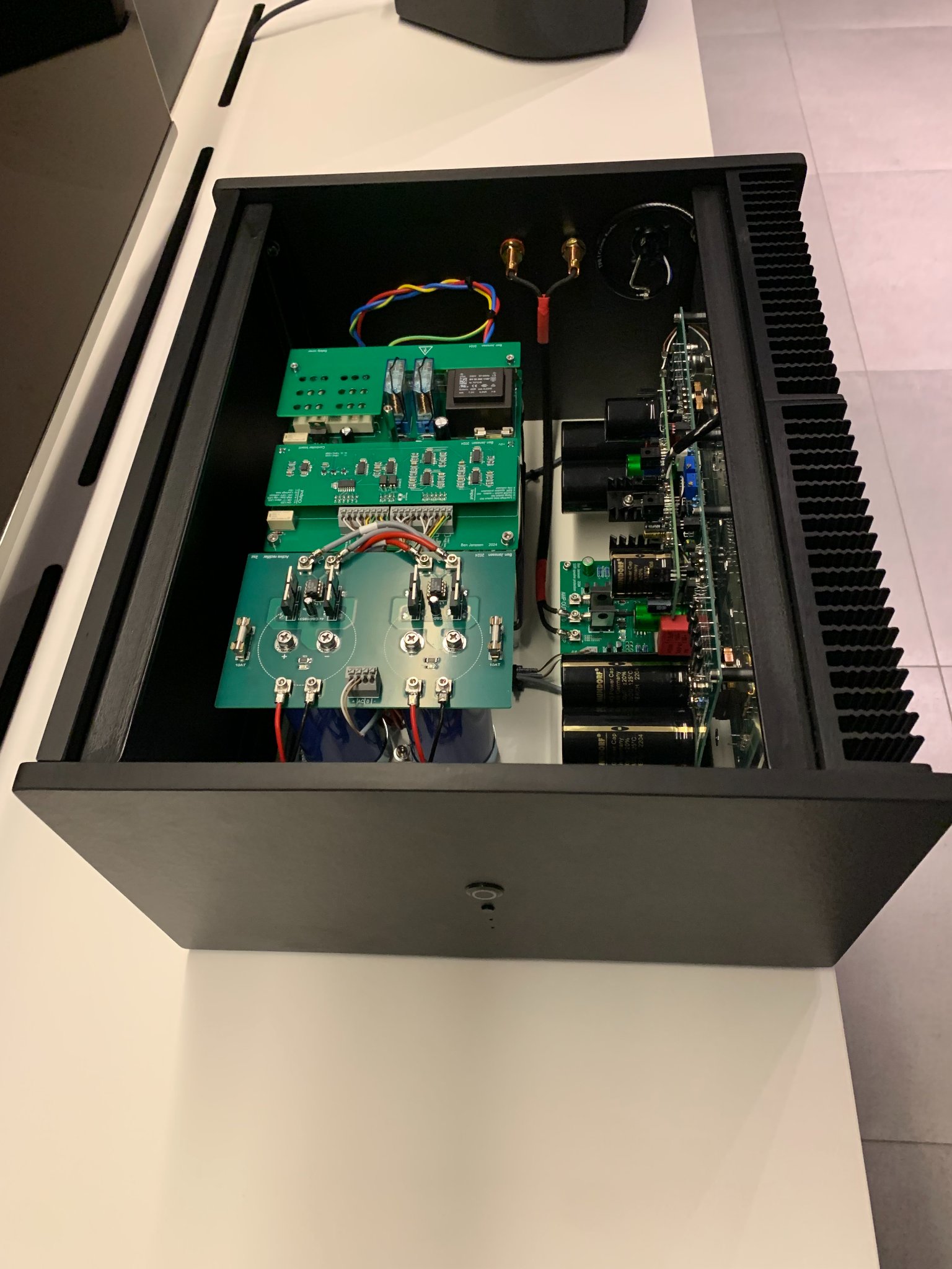

My Babelfish XA252 monoblocks are finished.
Some specs:
Fet version.
Rails 38.5Vdc
Bias 1.3A Summer mode /1,8A Winter mode (with small push button on front panel)
47R mod over optocouplers
Integrated clipping idicator.
Temperature protection 70°C
Solid state speaker protection
400VA Toroidy supreme toroidal
186400µF Nichicon and Mudorf PSU capacity per monoblock
Active rectifier (remains on room temperature)
Thanks all for the support!

They played couple of 100hours sofar. They sounded superb in the beginning and have the feeling they even sound better now. Burning in of the psu caps?? Or getting used to the sound??and, how it sings?
Sound is very relaxing, even at high volumes (60Vpp at speaker posts).
I'm that satisfied that I'm planning to dis-assemble my previous diy amps, which was a project of 7years!
I can only advise others to build this amp!
Thanks again ZM!

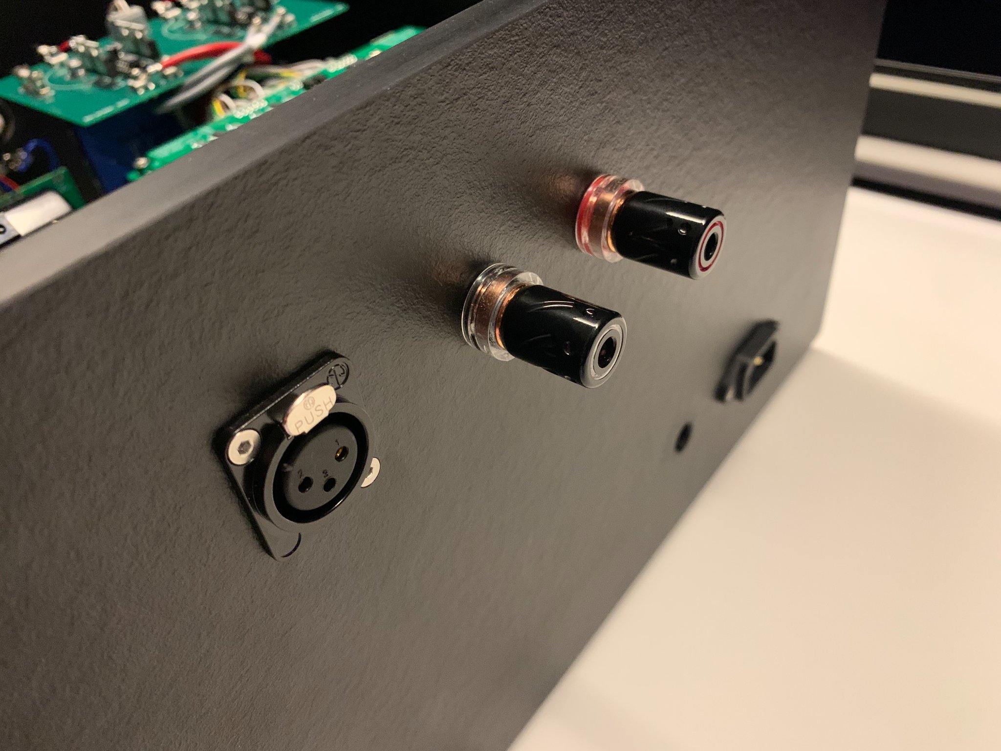

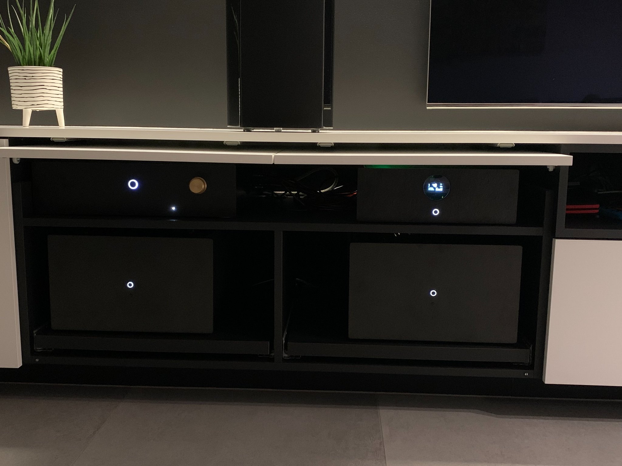

(1) What is the size of the case?
(2) MOSFET version?
(3) Aren't you worried that they will overheat in that cabinet?
(4) No BLUE LEDs. Seriously, you know that will affect the negative 2nd order distortion! 😉
(5) What is the preamp? I assume you're driving it balanced?
(6) Speakers? My 252 MOSFET drives the Maggie 1.7 well (*) and the Audio Note AN K/LX very well. I also have another system in the works with the amp and Acoustic Energy AE1s.
(7) The Buchardt s400 speakers have a rear passive radiator. How are you gonna mount those against the wall on a shelf? You need either a front port or a sealed cabinet ( hint, the AN K/LX are sealed )...
(8) Nice looking set up... what is the box on the upper right? The one with the front panel display?
(9) When it comes to speakers... beware of ZM... do you remember the things he drives? You wife will hate you if you put those in your living room!

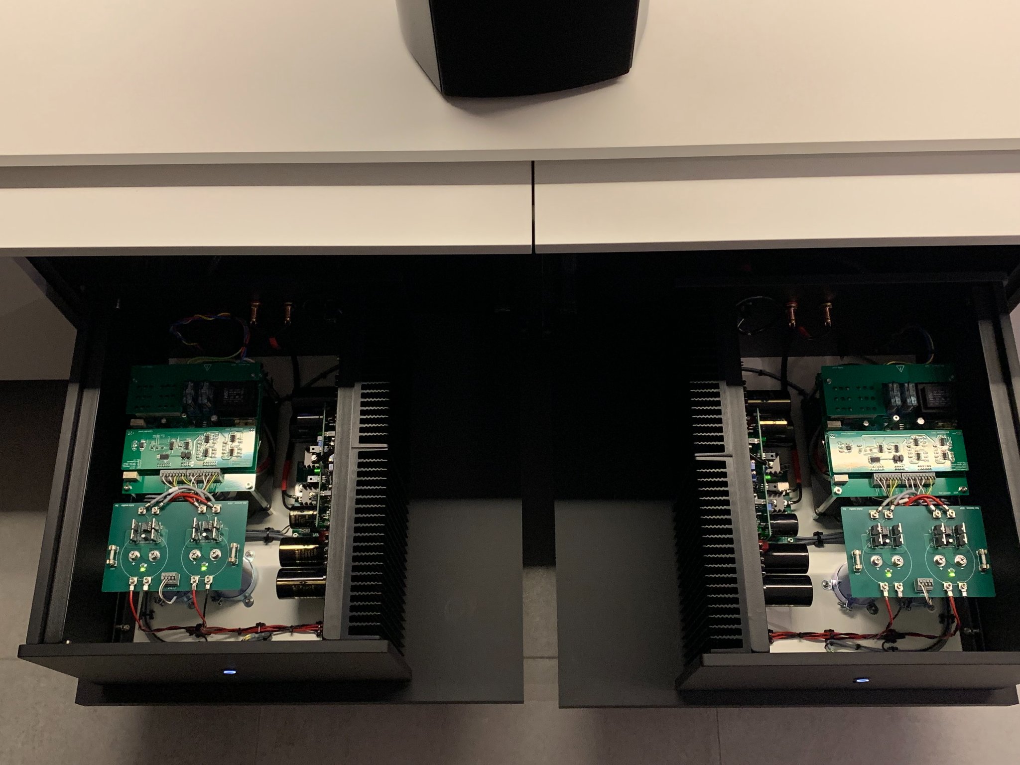

Heatsinks: 2x200mm 5u, case: 370mm x 420mm x 210mm
Mosfet version
No, stil able to keep my hands for more than 10 seconds on the HS when playing for hours.
I hate blue Led’s. Outside needs to match furniture = White leds
Preamp is Blowtorch clone: see link a couple of Posts above. No, driving it SE, sounded clearly better than balanced ( more sugar)
Mosfet version
