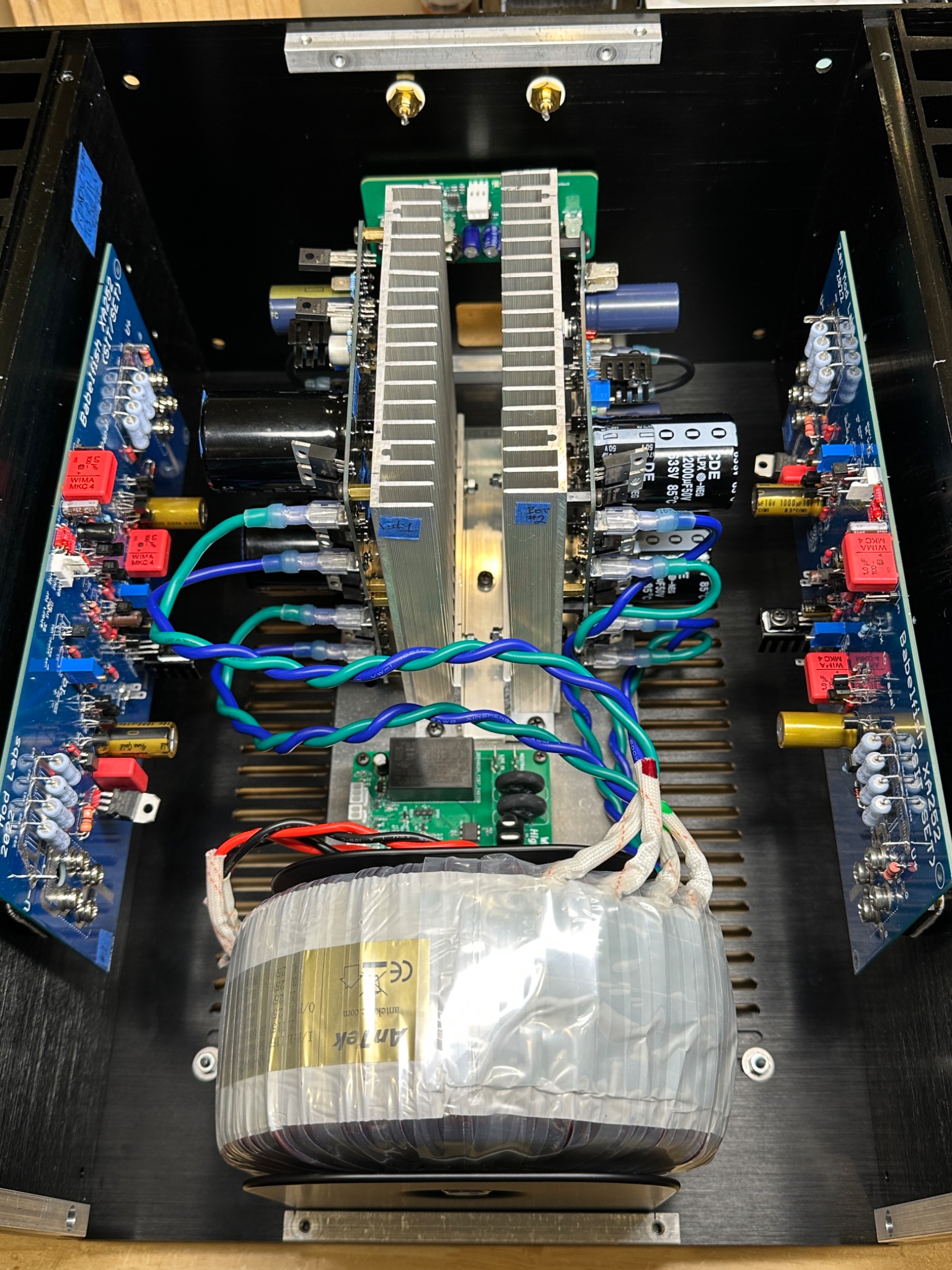

This Antek transformer double bracket uses a nylon shoulder washer to insulate the bolt and avoid a shorted turn. 👍🏻

I’m looking at heat sinks. Looks like the price of aluminum goes up. How many watts will the SIT version produce in heat, normally biased, per channel?
Thanks pal. So a 0,36 W/C sink will raise 22-23 C over ambient. That’s not much to write home about is it?
Ps. Looked up the Modu, it’s 0,28 C°/W. All sorts of standards when describing them. That’s about 17-18 C over ambient.
The one I was looking at is a 300x300 that would comply with my form factor preferals

@Vunce That's a real looker you have built there!
I don't have the skill to tell if you have a speaker protection circuit hidden at the back. Having enjoyed the wrath of the SET version...I wouldn't run this amp without it. No offense meant to the designer. This is a fabulous amp. It's even 'hot'.
- Soren
- Soren
That was a single heatsink that I cut to the dimensions needed to fit a pair of R25 psu’s. Don’t remember where I got it from?Where did you get the heat sinks for the "R25"???? modules.
….I don't have the skill to tell if you have a speaker protection circuit hidden at the back…..
Yes Soren, this amp will have DC speaker protection and maybe thermal protection also. (If I don’t get lazy during chassis wiring)
