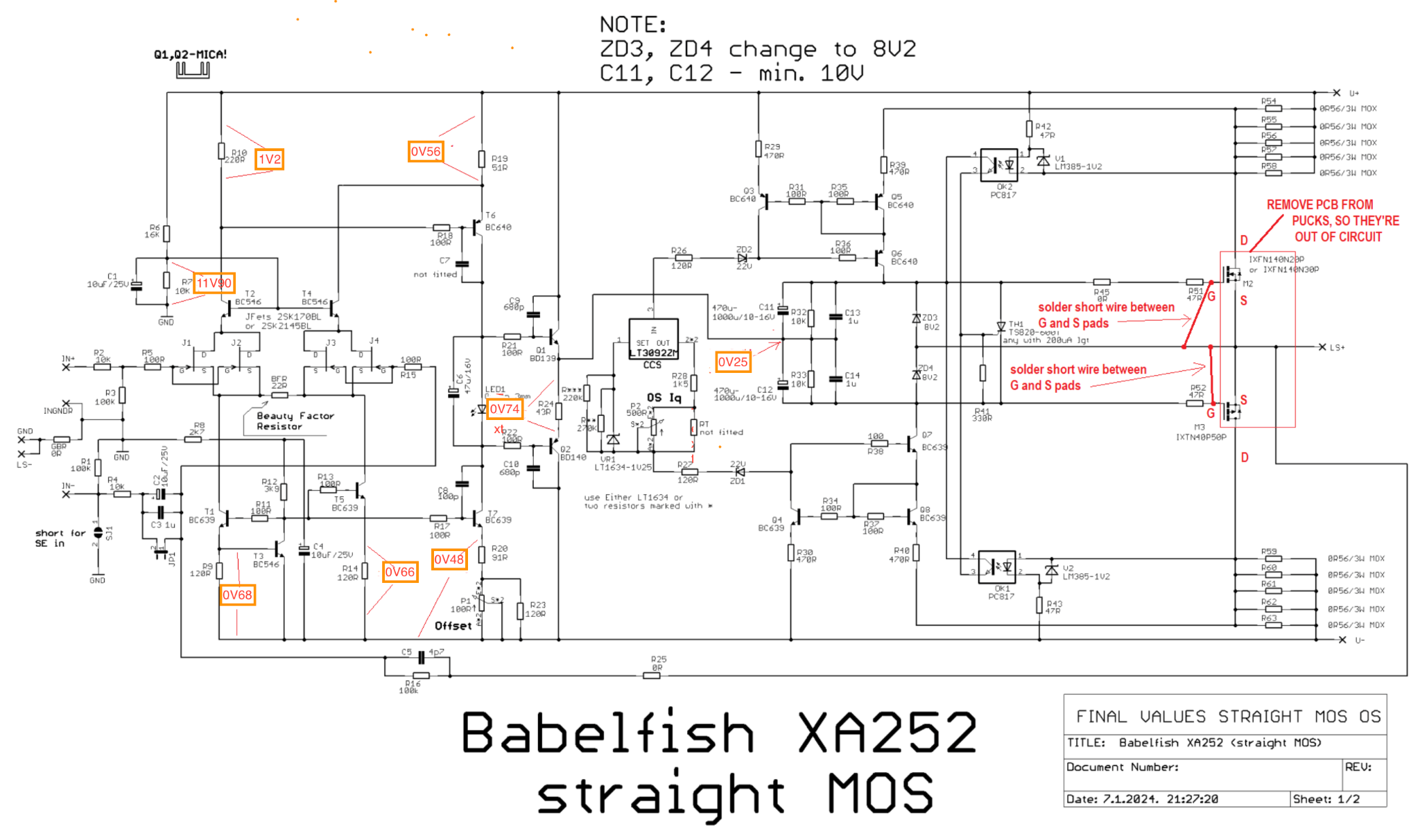

The only difference with the standard BOM, are the much higher Vce rated to126 VAS and driver bjt’s.

Important revision of protection circuit:
Soldering resistor in parallel to diode in Optocoupler (OK1, OK2, pins 1-2), practically in parallel to LM385-1V2 (V1, V2), thus increasing protection threshold from intended 10Apeak;
So, choose - 100R across OK pins 1-2 shall elevate threshold by 50%; 47R across OK pins 1-2 shall elevate threshold by 100%, not-fitting both OK optocouplers and V1,V2 LM385 and TH1 Thyristor means no current limiting of OS at all; that option also viable
Said resistors can be anything - from tiny smd to 0207 size; power is negligible there
Reminder - all zener diodes right from Q3, Q4 (looking at schm in post #1) - value in range of 8V2 to 12V, whatever easiest to grab
Hope it'll help to contain Gray Smoke in bottle.

When the protection kicks in, grey smoke from output stage is prevented. But, driver stage, is via caps and zener diodes in output stage loaded with speaker load! Resulting in quite some power dissipation in the driver stage.
A very fast speaker protection can save the day. Why: simulation and experience showed me that when protection is active, the speaker output node is at a couple of volts, triggering speaker protection.
This also means if the caps in the feedback network are bypassed (need to be in balanced mode), this voltage is multiplied by ~10, resulting in about rail to rail voltage over 1 of the drivers.
Conclusion:
1. most robustness is with caps in feedback network NOT bypassed = SE-mode.
2. fast speaker protection adds robustness to prevent blowing driver stage.
Current limitation in the driver stage could be a solution.

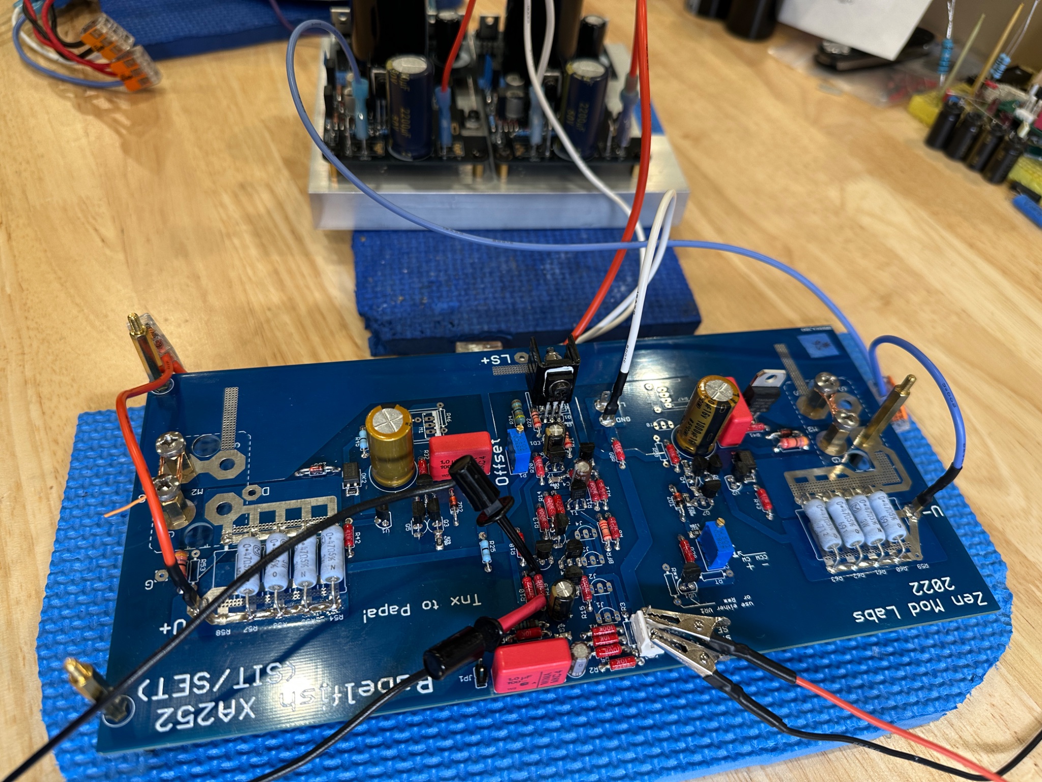

Powered up output FET-Less, no magic smoke!
Hi ZM,
I attached your annotated schematic with my measured values.
Both amp boards measured the same.
Voltage across R19 and R20 are considerably off from yours
  • PSU during measurements was +/-31V5
  • Input shorted
  • JP1 open

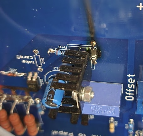

@Zen what is the likelihood of just the resistor burning. I removed the board and from basic measuring resistance, none of the active parts seem to have failed, even the optocouplers seem OK. I was expecting mayhem! I wonder if I switched it off in time? My speakers were protected by the mosfet based protection switch which would have unloaded the amp.
Am I the luckiest guy with a smoking amp?
