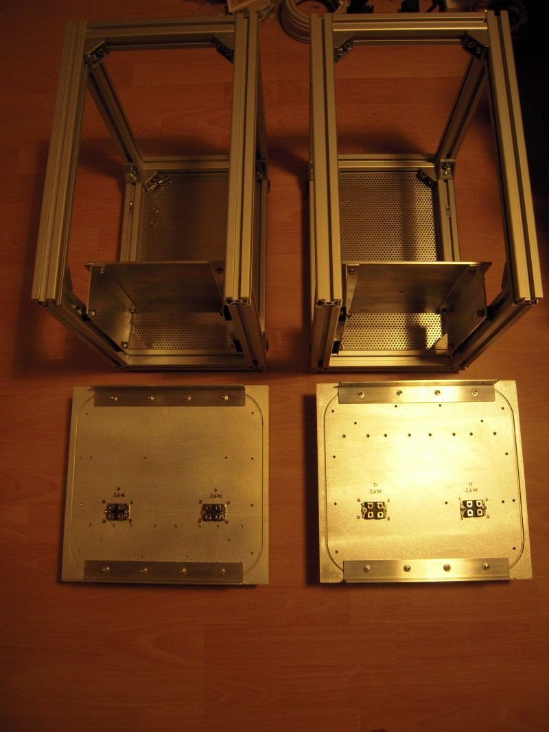

I have used right angle (90 degree) aluminium-profiles to mount the solarinverter-heatsinks to my frames of the amp.
You could also mount them to the baseplate and top lid. But those heatsinks are heavy! They can bend a case without
some stiffening.

Hi Dirk, the cases look straightforward. Did you build them from aluminium section, and can you get pre-cut parts?
Hello Giallograle,
those ALU-profiles I used are often called 'BOSCH' -profiles or have other names... They are used extensively in the photovoltaik-branch and in the machine -engineering area.
My ones were bought from german companies (Blank-Profiltechnik) precut to my desired lengths - easypeasy. The profiles are not that expensive.
https://www.ebay.de/str/blankprofil...vNjbb_DtDlL4TlE28UlESo75u8nERFP4ptBKzS27ngW_c
But the right angels to connect them together with the other hardware like screws, nut-bolts,.. they sum up.
