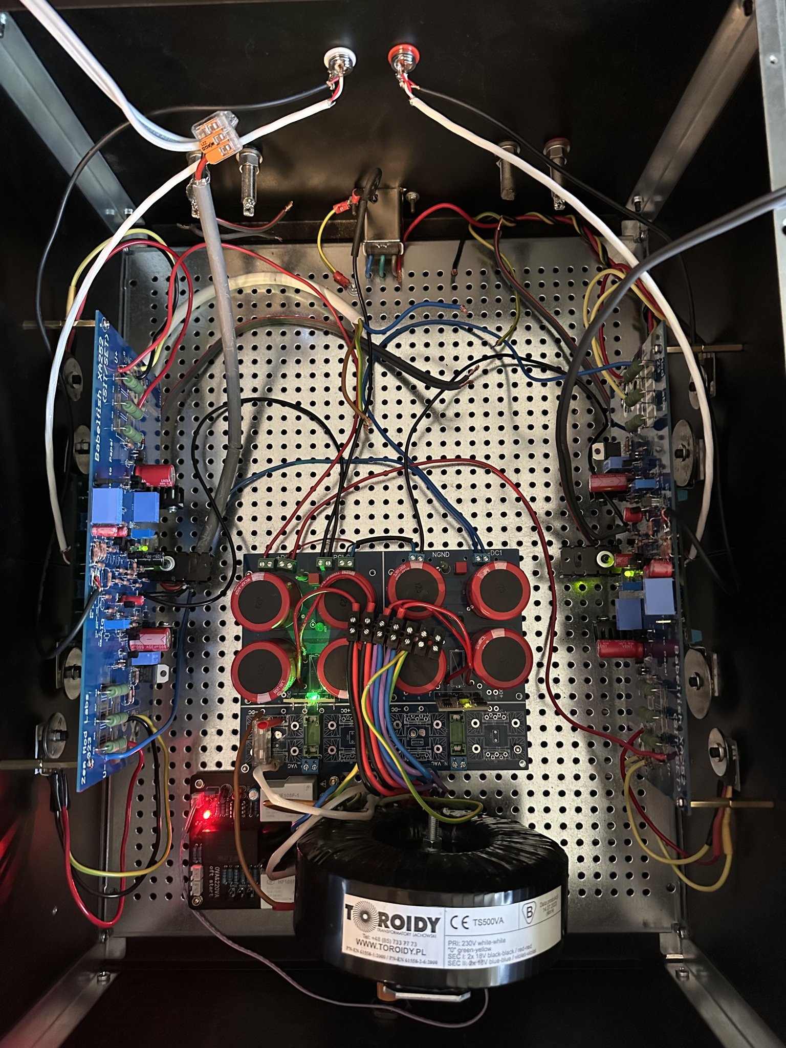

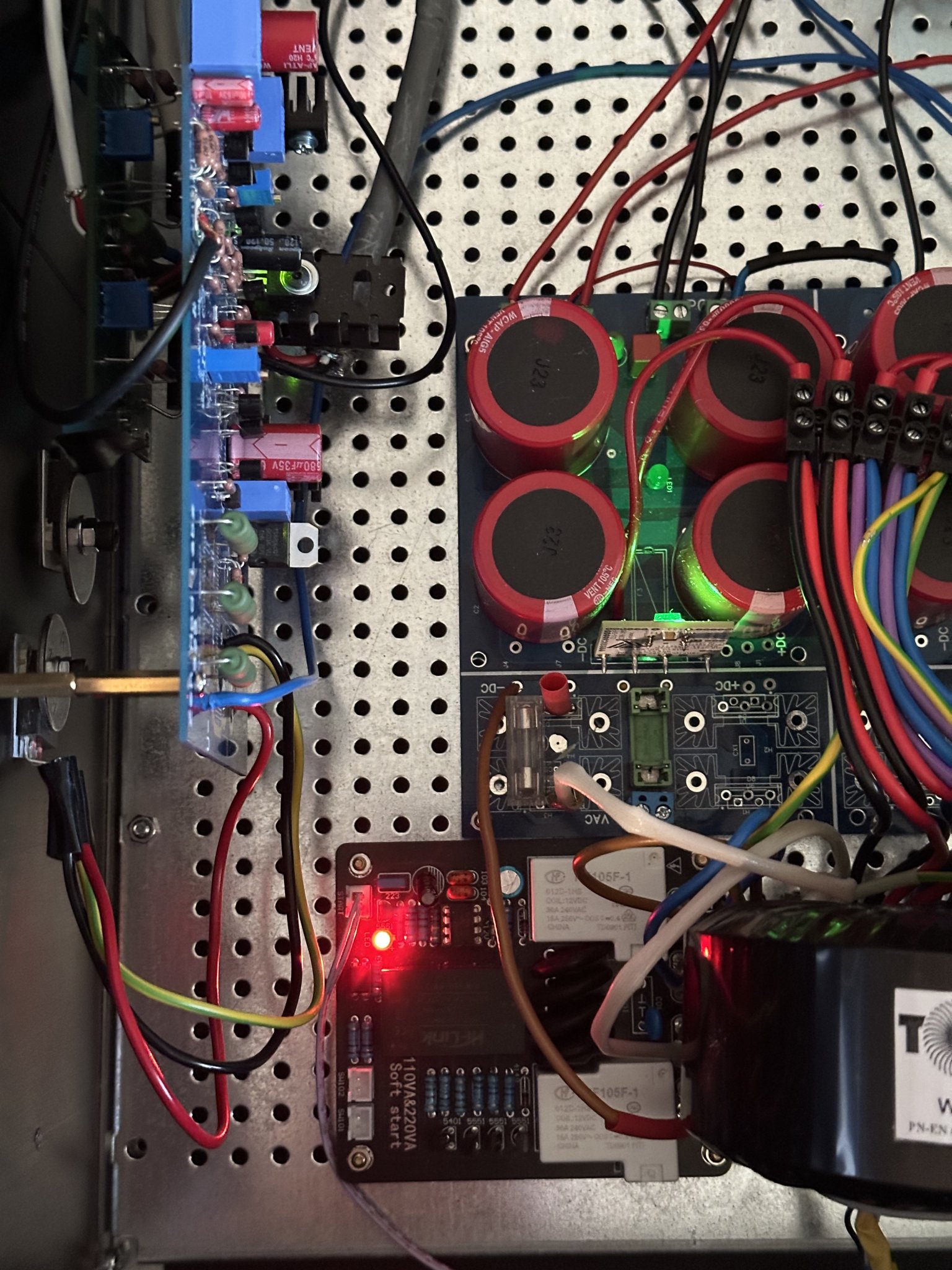

I have question about small hum problem and turn on/off small pops. I have 500VA 18AC donut with Aliexpess soft start and LT4320 active rectifiers with 8x10 mF caps and no R between them. One main 2.5A fuse after soft start. I have had a donut horizontally and vertically but still small hum. Could be that the baseplate also affects it? I kind a remember that I did not had that issue before the baseplate. 🙄
Using XA252 SET with not matched FQA mosfets. In the same 5U/500mm case I also have FW F5m installed for comparison testing.
Any thoughts and ideas how to improve it?
no pops with regular style of PSU (peasant bridges)
can't comment anything else, nor seeing anything suspicious from pics
now, can you describe that signal wiring , from RCA to pcbs?
regarding pops - in the end, best to implement speaker protection, with delay On and immediate Off
I believe the reason has to do with AC phase feeding the LT4320 rectifier.
Connected to a center tapped transformer, the positive rail would give expected output, but negative rail will be lower than expected (and wonky) creating non-symetrical bipolar output.
Probably not a good technical answer, but thats what I’ve experienced and read.
