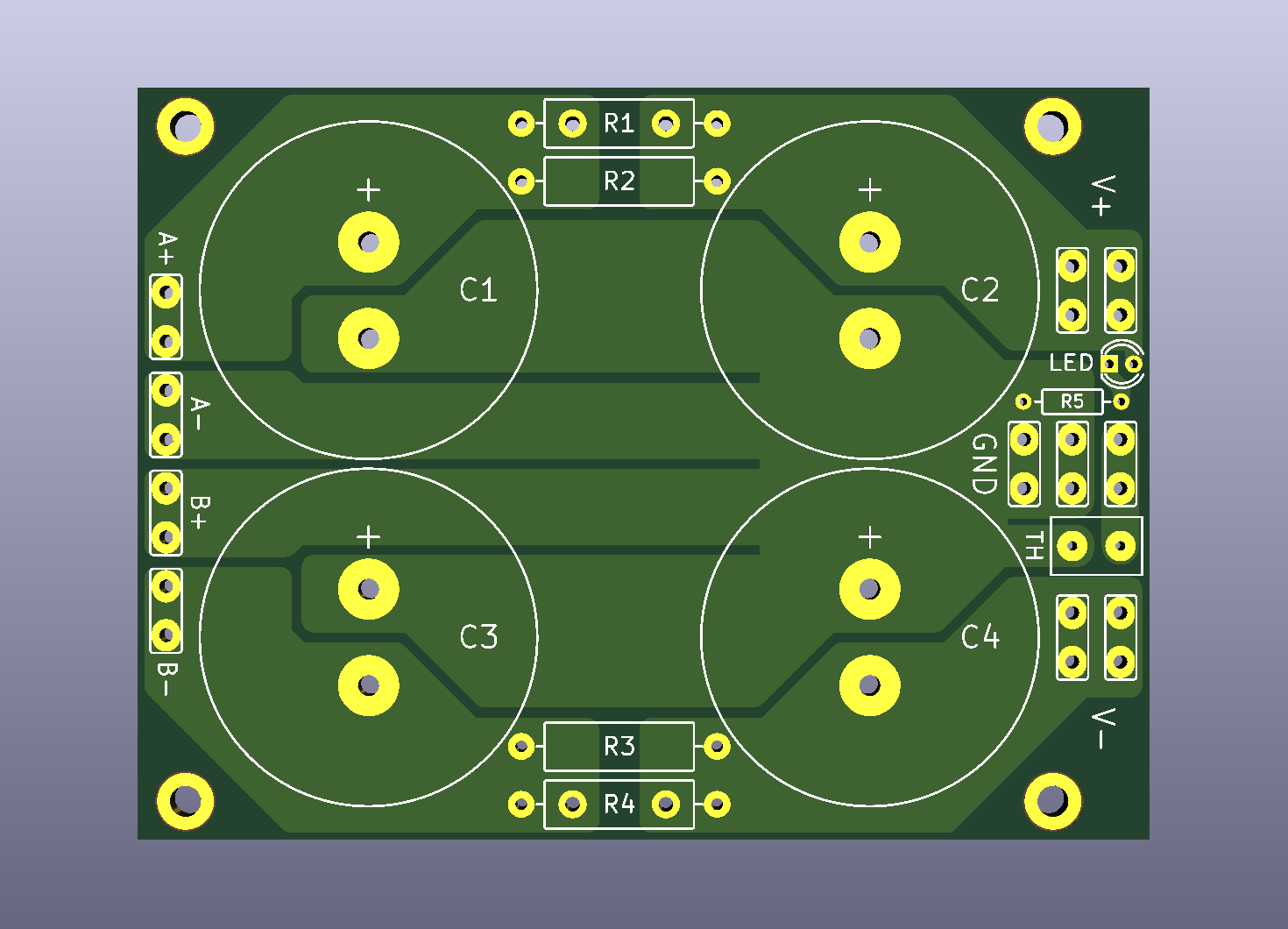

ZM, I like your PSU board pattern.
I start to make a copy of it in KiCad with blade connectors but got distracted by another design and it deviated a bit in the process..
Right now it look like this.

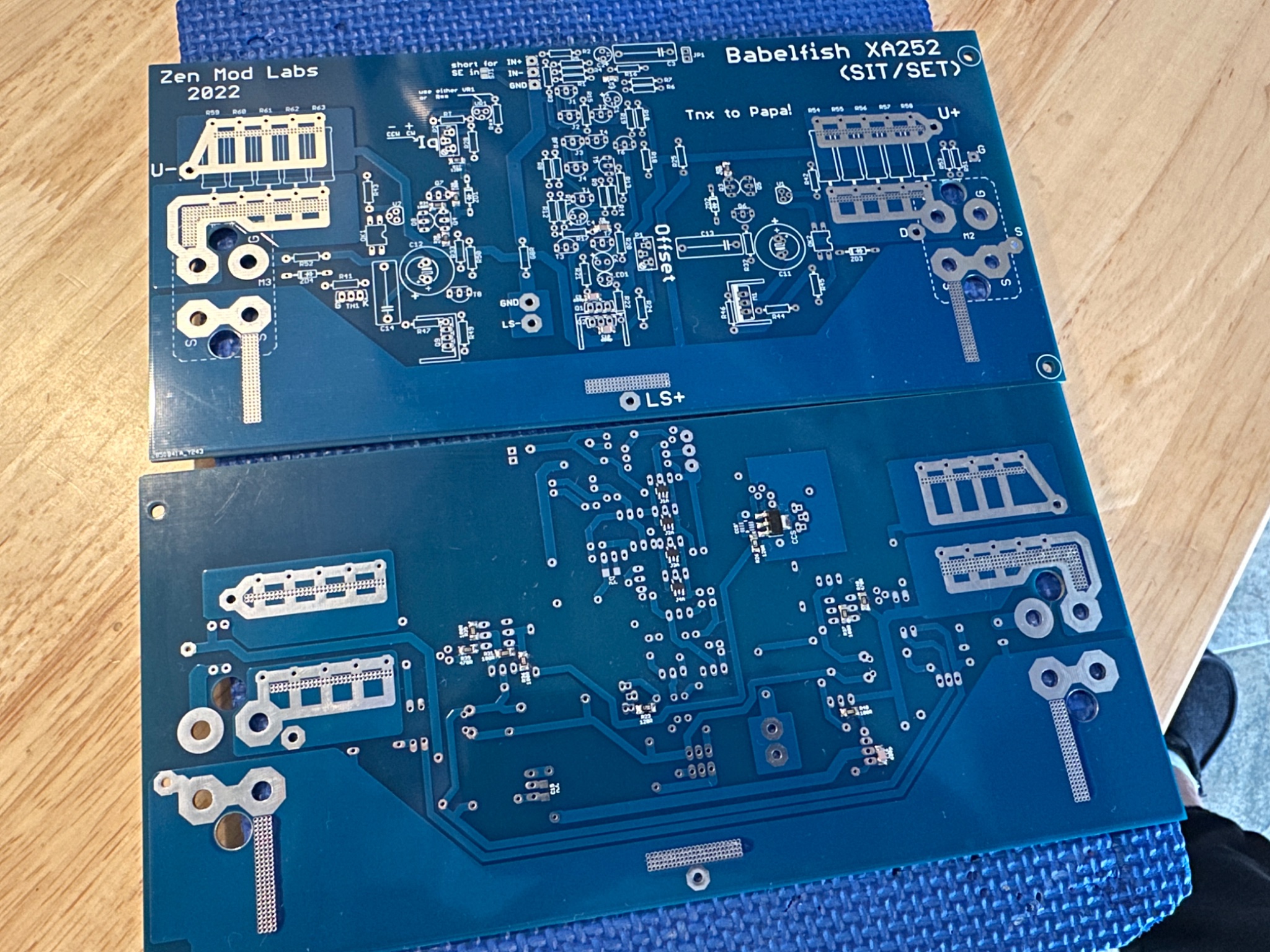

It’s been sitting patiently, but finally Babelfish XA252 is next up on the bench! There have been slight changes to the pcb’s and schematics over time. I’m building the big MOS version.
@Zen Mod, the attached schematic doesn’t exactly match my 2022 boards,
just want to confirm part values are good to go?
Too bad I didn’t build it sooner, we need some more heat here, it’s COLD outside.🥶
