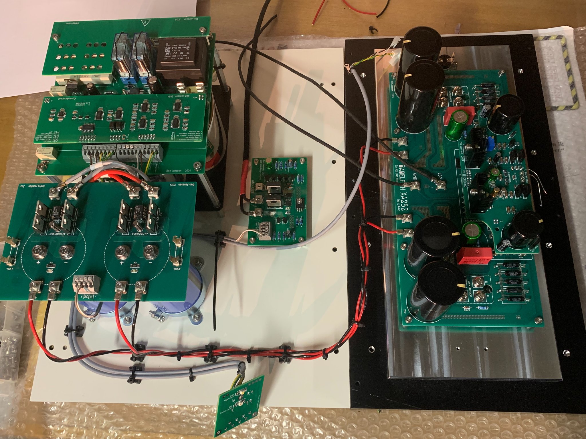

I did diode test to the active pats and I want to verify my results before taking any actions. All the parts are on the pcb without removing them yet. Some parts show forward voltages ok 0,5-06V all pins but changing testing direction and polarity then they also show some short voltages. Please someone tell me that jfets are ok. 🥹 Maybe someone can verify these results in their XA252 amp?
Jfets 2sk2145 - Source and drain - 0,001V diode test (using J1 and J3 pinouts 1 and 3) It starts reading from 0,5V and after a couple of seconds it goes to 0,001V. 🥲
DN2540 - Source and Drain - 0,06V
V1 and V2 LM385-1V2 - 0,024V
Q5 - BC640 - pin 2 and 3 - 0,05V
Q8 - BC639 - pin 2 and 3 - 0,05V
OK1, OK2 - PC817 - pin 1 and 2 - 0,024V
T3 - BC546 - pin 2 and 3 - 0,06V
T8 - BC546 - pin 2 and 3 - 0,08V

do you have one channel functional?
if yes, compare
usual practice is - if diode test in situ is showing that part is ok, then ok (most likely)
if diode test is showing suspicious part, don think; remove it and test out of pcb
optos are almost certainly ok; they are protected with LM chips
if yes, compare
it's enough to test JFets with diode/resistance test
if there is no short and D-S showing few dozens Ohms, they're OK

without voltage present, D-S of JFet is presenting itself as simple resistor
so, if you have dozen-2-3 of Ohms, Jfet is most likely OK
if there is short - you either made a mess with soldering job, or JFet is Dodo
all that, counting that surrounding parts aren't messing too much with testing

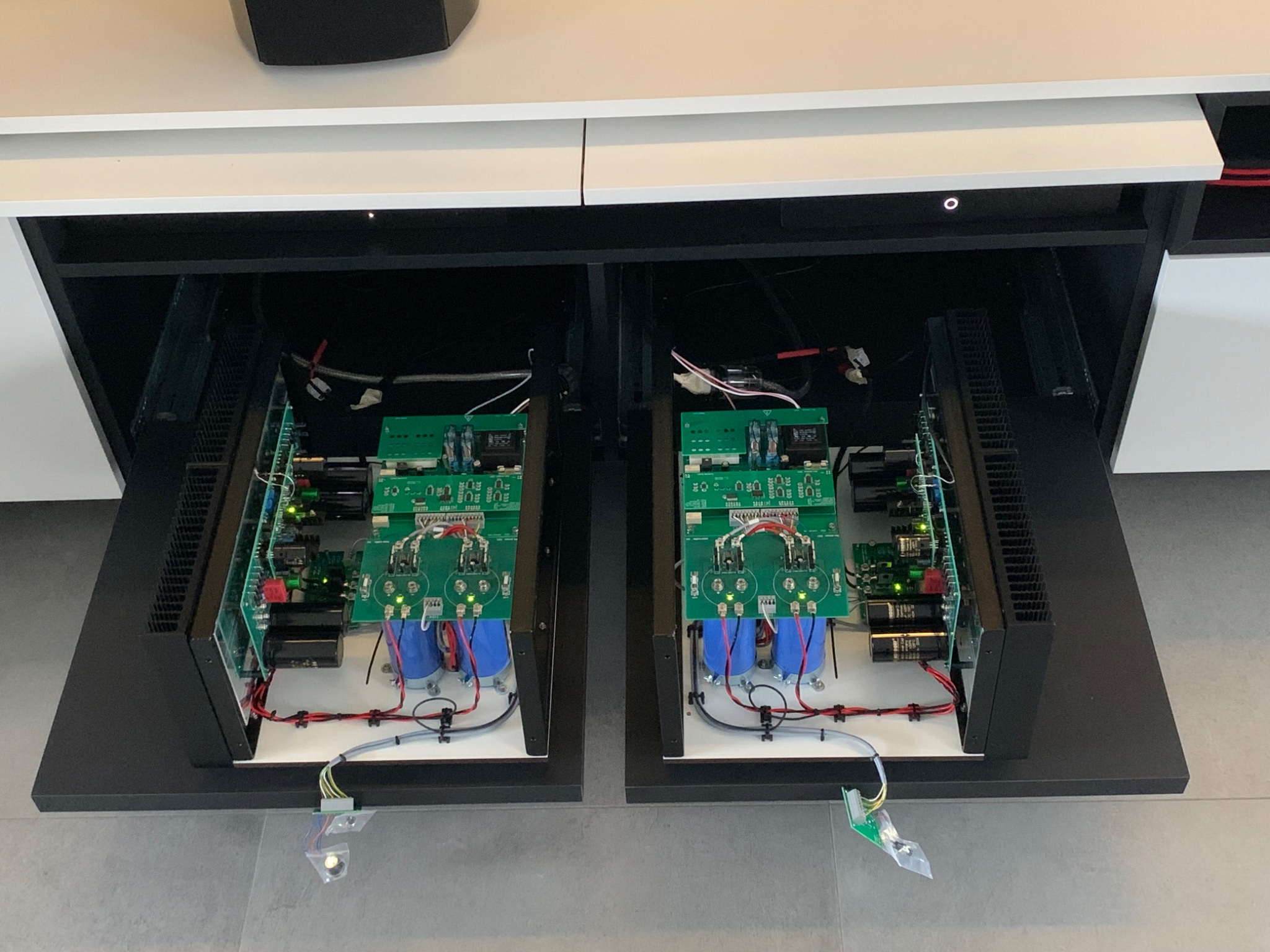

Monoblocks will be far enough completed next week, to put them in the main system.

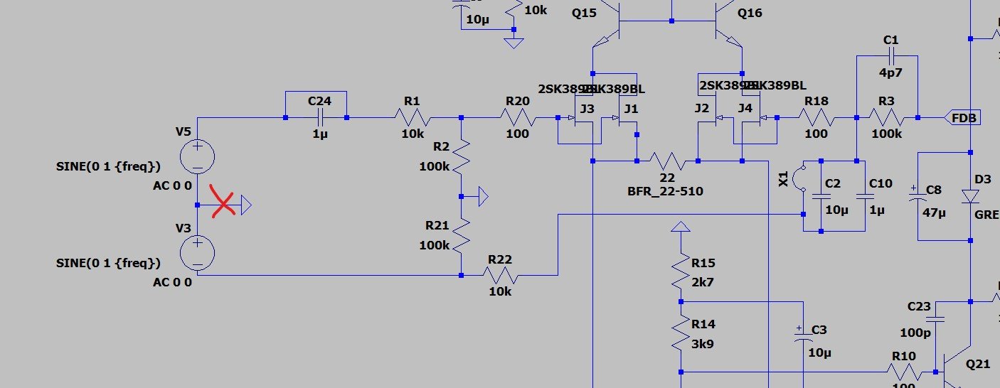

I have a Blowtorch clone preamp, meaning inherently balanced concstruction : https://www.diyaudio.com/community/...d-state-pics-here.96192/page-368#post-7159684
As this will be my first balanced connection in my system, I have went to quite some online infor regarding balanced connections. Including SE to balanced.
I was surprised when reading the Rane paper (Ranenote 110), ground signal from source is NOT required to connect to input GND at amplifier?? When verifying in LTspice, it seemed to work.
Can anybody confirm this really is the case, I don't want to find out the hard way. (See red cross below, can I break this connection)
in practice (speaking of your black boxes), you have a choice - connecting Pin1 either to case or to signal GND on stage pcb
audio GND is always connected to case in some way
Pin1 to case is sort of standard Pro arrangement, where Pin1 to pcb GND is more commercial gear arrangement
Practically - none is superior and right one is where there is no hum present

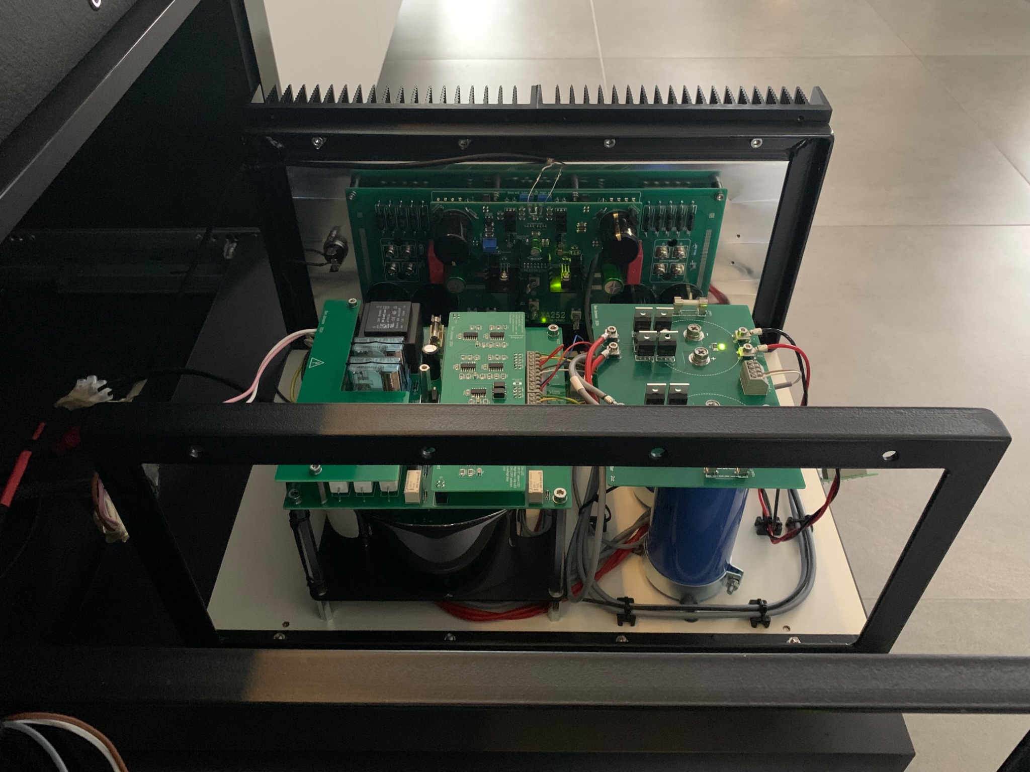

Zen Mod, congratulations with this amplifier design! The XA252’s are replacing my previous diy amp’s.
Sound is marvelous, been listening last two days as good as continuos to these amps.
Rails are 38,5V and biased at 1,2A.
PSU ripple is about 30mV for output stage, front end is equiped with cap multiplier.
When listening in High Bias mode (push button), bias is at 1,8A. But to be honest, soundwise, no difference.
Next step is getting all eclosure panels CNC milled out of HPL plate.

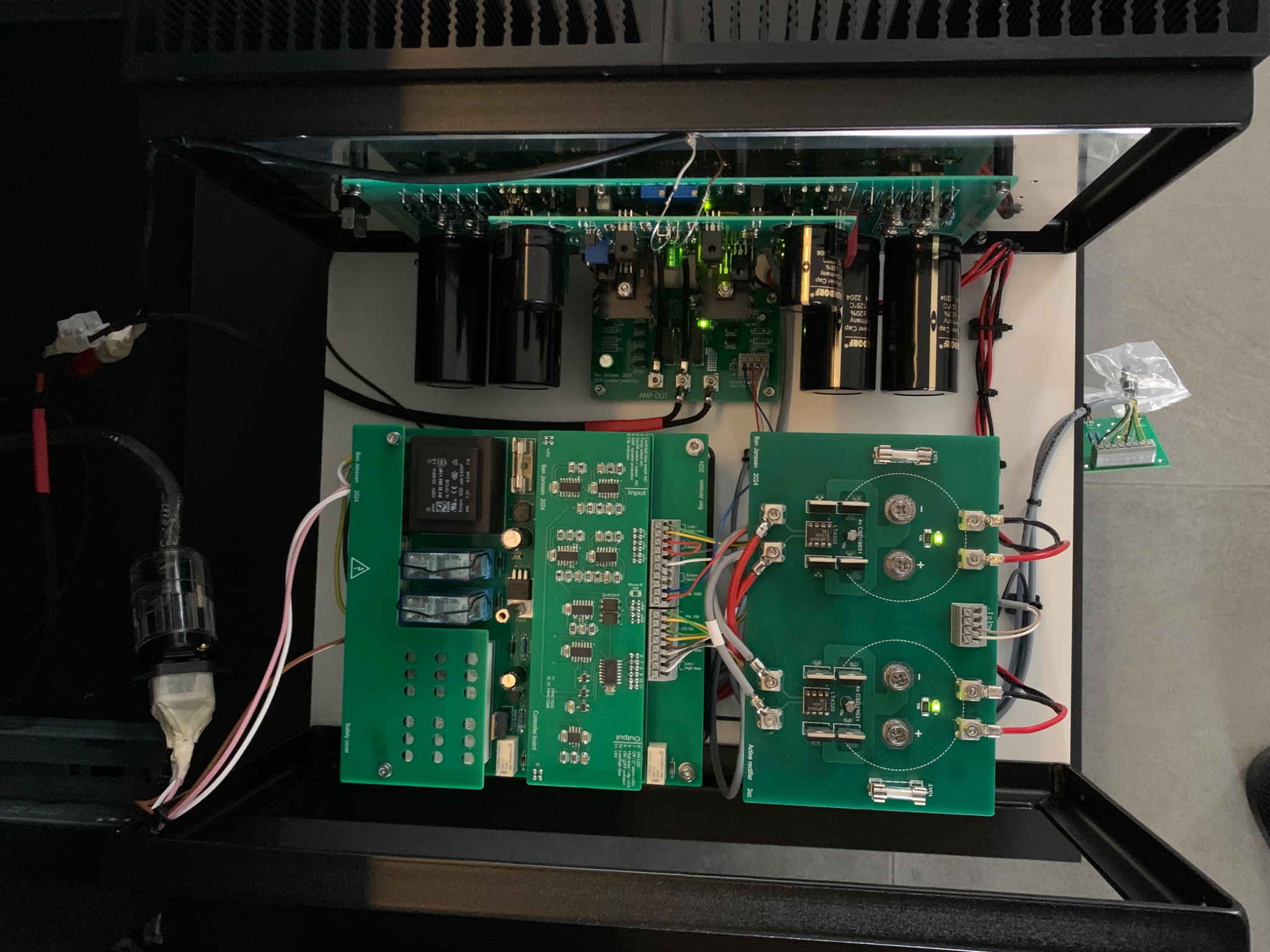

Thanks Russel,
And yes, boards are selfmade: https://www.diyaudio.com/community/...elfish-xa252-set.373443/page-121#post-7803907
End this week, remaining material for completion of internal wiring and material for balanced connection to preamp will be delivered.
Material for front, side and rear panel is Egger U999 ST76. I'm out and need to order a complete plate of 4100x650mm 🙁.
